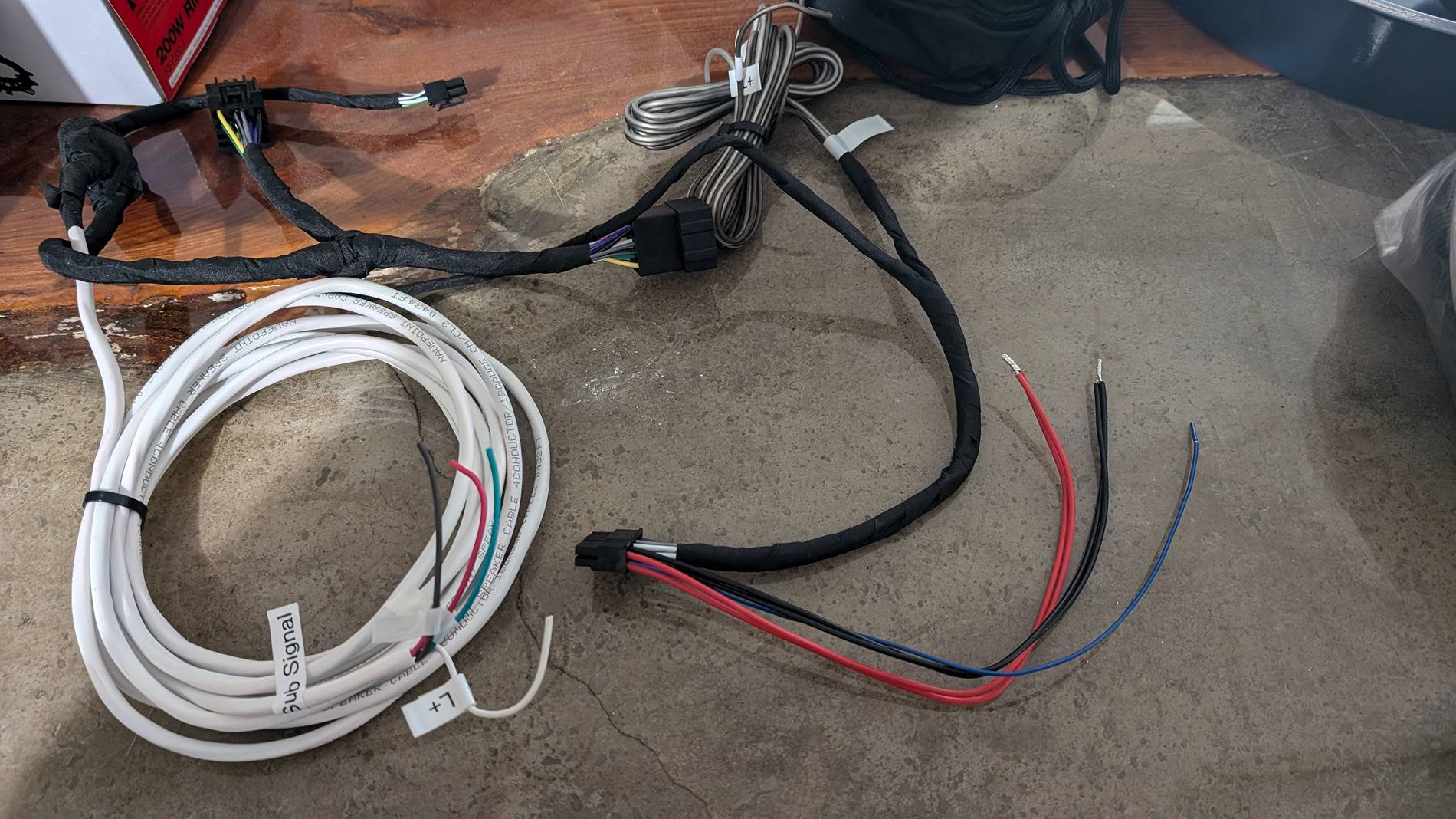

Bought the kicker amp and wiring harness from Bruce at Hush Audio a year ago, very helpful and knowledgeable form the start, I told him I wanted to bi-amp, and he gave me all the pros and cons and great advice. I decided to go ahead and bi-amp since the morel speakers need the power, he also added resistors to help with any chime/warning sound issues after install.
I had already installed door speakers, blockoff plates and sound deadening on the doors and backwall. That alone made a decent difference, but was finally getting around to install the key amp/harness, tweeters and sub a year later. Reached out to Bruce with a few questions and he had me send it back and he upgraded it to the newer version, soldered on my Subwoofer connection and extended all the lines so I can mount my amp under the glovebox, at no extra charge (not even shipping). He was also constantly responding to all my stupid install questions since this was the first time I did something like this. Very helpful and cant recommend him enough, and the harness worked perfectly.

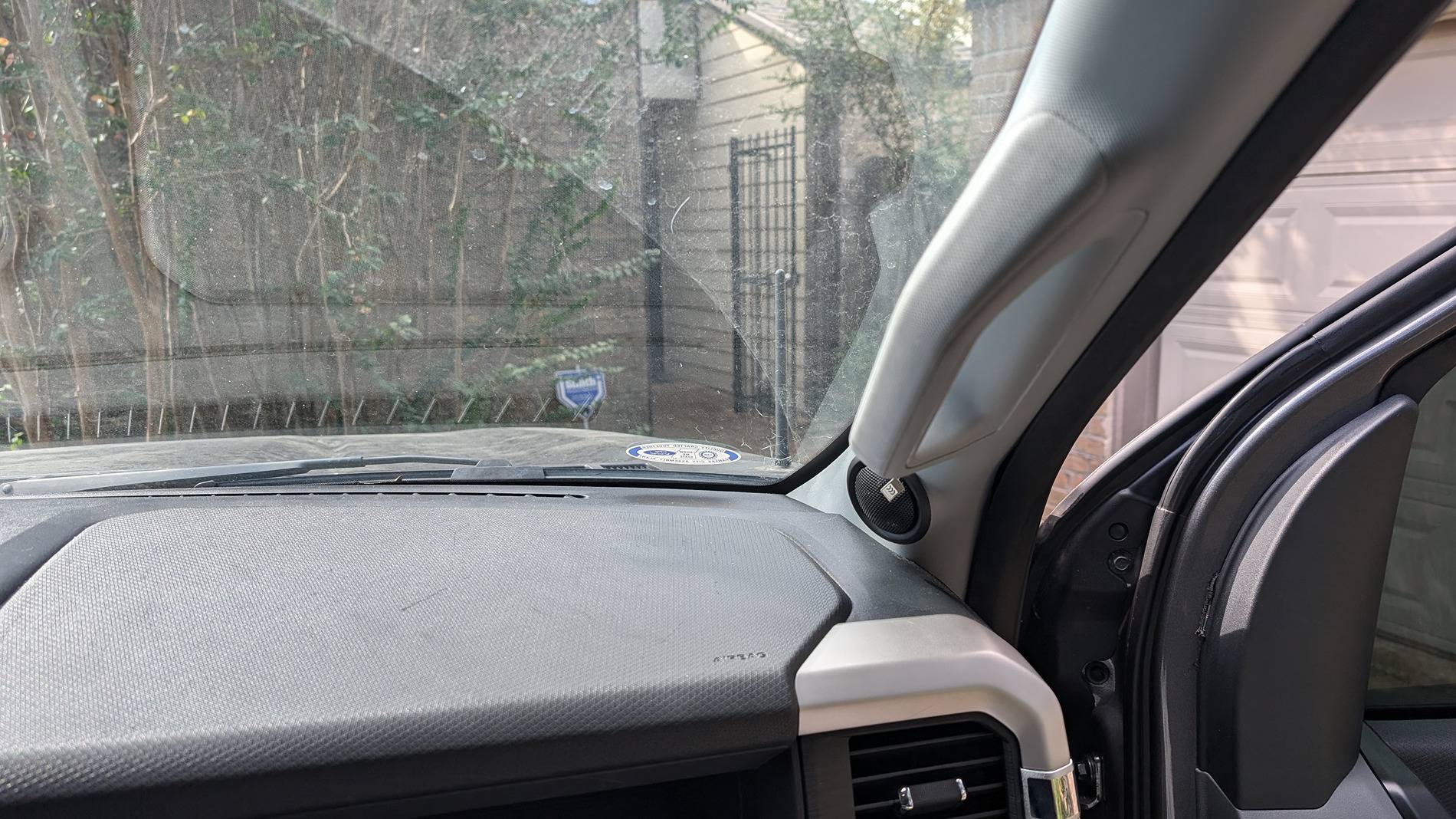

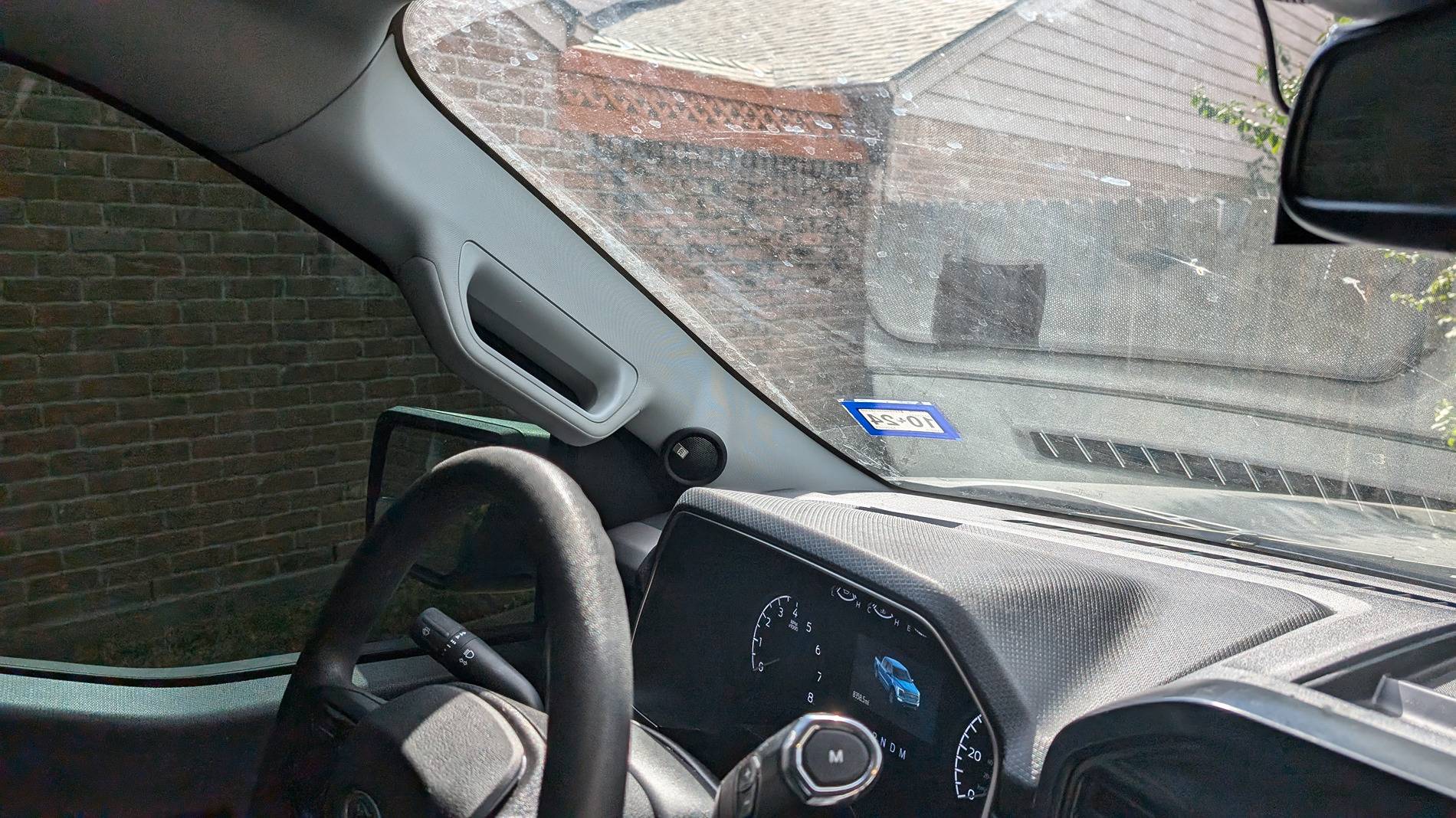

I didn't want to mount the tweeters behind the grill in the A pillar trim, thought about tweeter pods or cutting the plastic grill Infront of the tweeter, but ran into this thread and found a set of platinum a pillar trim on ebay for 140 used, so decided to give that a try.
https://www.ford-trucks.com/forums/...relocation-using-f150-unleashed-a-pillar.html

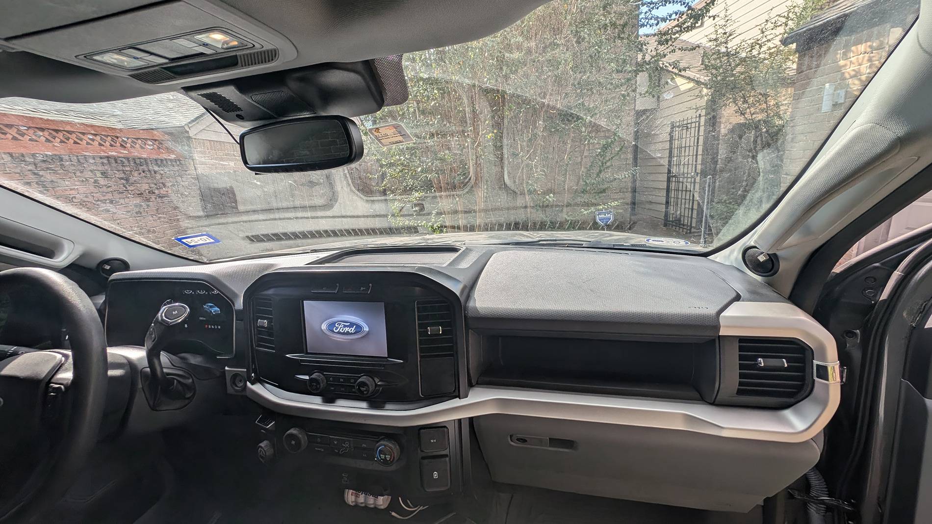

The A-pillars worked perfectly, and I got lucky it was a perfect color match. The tweeter lips do stick it out a bit, you can see the pictures below.
Put everything back together, and ran the autotune on the key in my driveway with the kicker EQ and time delay on, and was honestly a bit disappointed. I reran the tune with the truck in my garage, with all the garage doors closed, and me outside the garage, as well as with Kicker EQ and time Delay off. That was a night and day difference and made the system really come alive. So try tuning with and without kicker EQ/compression/time delay and see what sounds best to you.
Some pictures of the A- pillar tweeter replacements, and harness from Hush Audio. I can try to get more pictures of the other parts of the install if anyone needs them.
