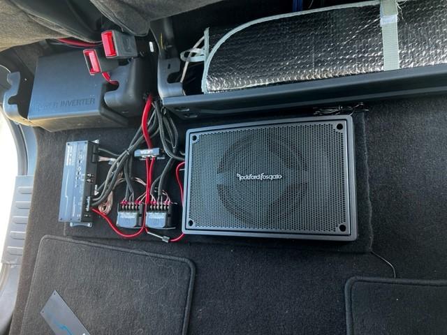

I did Murell speakers with the Rockford Fosgate built in amp, I mounted everything on a board and put it under the rear seat.
The RF sub wont pound your doors but its all I wanted for good listening to my music.
