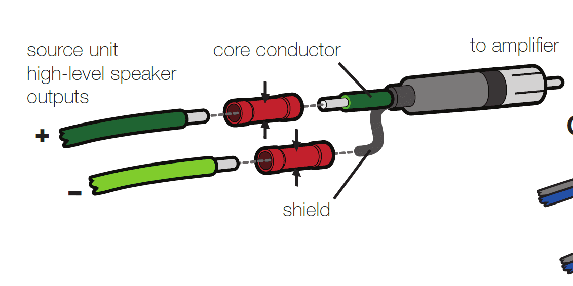

I have attached below a wiring diagram of your system. What they should have done is use "high level inputs" instead of a LOC. The amp only has RCA style inputs therefore they should have used these: (https://www.kicker.com/2-channel-speaker-rca-converter) they are just speaker wire with RCA ends for the amps, but they are NOT low level inputs. You would basically use two of those, one for front and one for rear. This would eliminate the LOC and possible extra noise in the system.

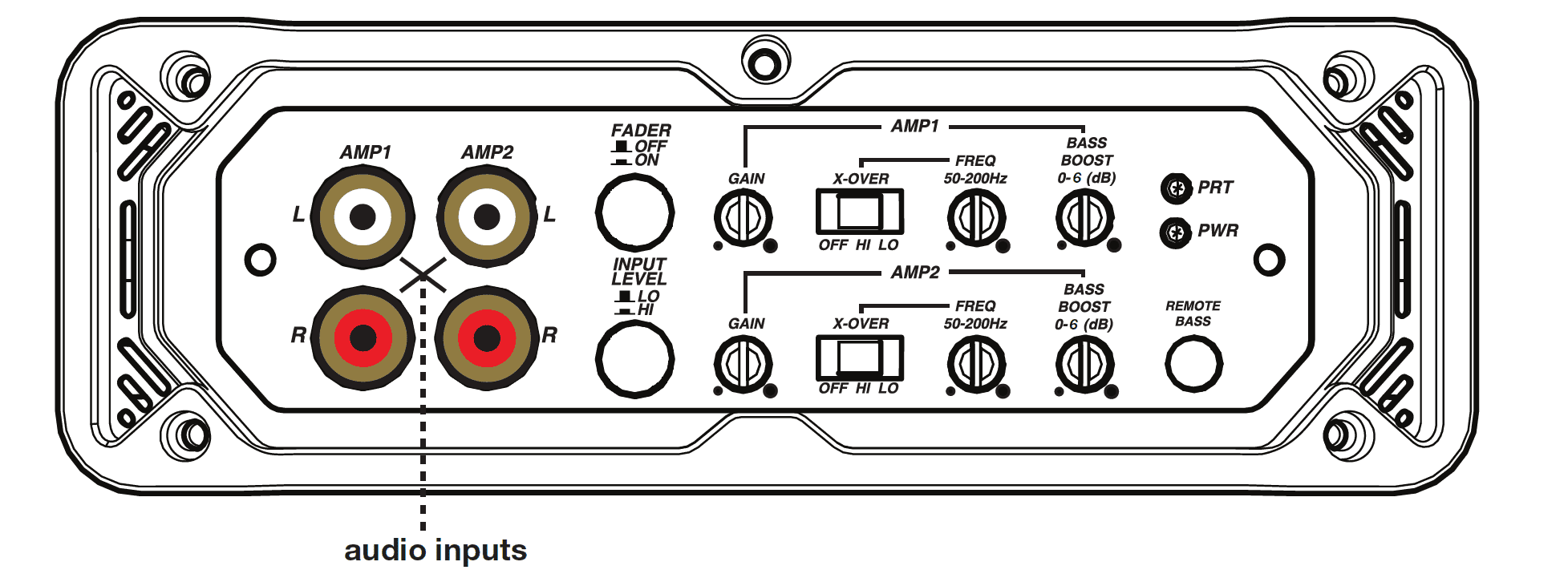

The amp. The amp has a button for high or level, it should be on "low" if they used an LOC and should be on "hi" if you use the method above. The fader should be "on", the input level should be "high" for speaker level input (if you get rid of the LOC). Turn the bass boost all the way left to "0", turn the X-overs off for now, and turn the gains down all the way. Use the manual pg 6 (https://safe.menlosecurity.com/doc/...360a8b131a71b764b5f8d15ec13cebe1051e366c202a9) to set the input gains.
Note: You can play with bass boost and crossovers later to fine tune (I like to high pass crossover door speakers even if only 50 or 60 to keep really low freq from going to the doors). 6x9s aren't going to play really low with any quality, so I like to cut them off.
