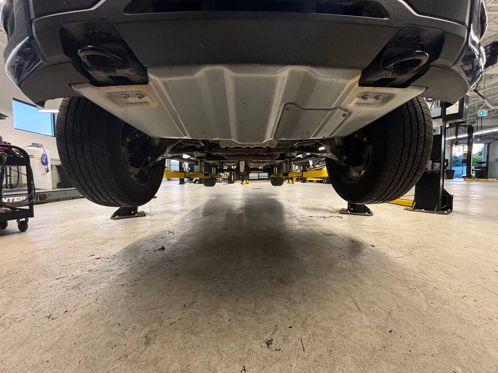

This evening I finally finished my tremor bash plate install, think it turned out good.
We all know there’s the kit out there you can purchase for something over 600$ depending where you’re at. But I thought to myself, these trucks are extremely similar. So I did my research, made sure I got the essentials and that was it.
First thing was to occur a tremor bash plate at a reasonable cost. Didn’t take long, so many wrecked F150s where I’m from. Found a local guy parting a 21 tremor I believe, and scooped up the bash plate for $150 CAD. Little scuffed up but nothing a bit of repainting can’t fix, plus it’s a bash plate. It’s going to get bashed.
Once you’ve gotten a bash plate, all you need is the required listed below. The mounting bracket that bolts to the frame.
Ford F-150 Tremor bash / skid plate install on 2024 F-150 STX 1726804145201-7
These parts cost me after tax $220CAD. Pretty expensive bolts and nuts, if you can source them else where I’d highly recommend that.
Once I got all the parts I needed, it was time to do some trimming and remove the factory air dam system. One the air dam is removed, trim the remaining apron. Test fit the bash plate, I then traced the sides to outside the side trim. The skid plate needs to sit up higher roughly one inch more.
Ford F-150 Tremor bash / skid plate install on 2024 F-150 STX IMG_2377
Once the sides trim you have to trim the lower section with a saw. highly recommend a saw, you will have to cut through a plastic reinforced section. Once that’s completed. The bash plate bolts right up.
Ford F-150 Tremor bash / skid plate install on 2024 F-150 STX IMG_2414
Ford F-150 Tremor bash / skid plate install on 2024 F-150 STX IMG_2417
I drilled a hole, in the centre of the plastic trim for the bumper to add a screw to ensure the trim piece doesn’t flap around from wind. Can’t see it unless you look down. Overall happy with the fitment and result. This all cost me roughly $370 CAD. Next up would be a slight repaint over the bash plate, but might not even bother.
Ford F-150 Tremor bash / skid plate install on 2024 F-150 STX IMG_2419
Easy peezy. 2024 fits like a glove.

Nice work. The FX4 plate on mine is laughably thin, and it doesn't have a door for the oil filter. This looks like a future possibility.

Looks really good!

"Bash" plate? In 'Merican we say "Skid" plate. You'all in the Great White North don't also say underwear has "bash" marks do ya? LOL
PS: Thanks for posting the brackets, etc. I was hesitant to get a bash skid plate off eBay without them.

Great write up!
I’m shopping the local salvage yards. Fingers crossed that they have one they will let go for a decent price.

Turned out nice. Thanks for the write up and i'll add that to the "in the future to do list."

Good job - looks like it was alwasy there from factory

Thank you for the info. By any chance do you know if powerboost would be the same ? I believe it should be ?
