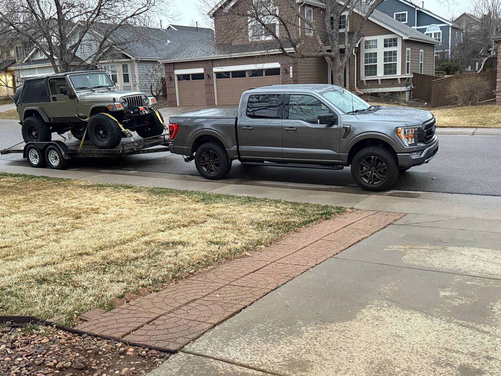

OK, so I have a 2021 F150 XLT Screw with the 3.5 eco-boost. it has the fox 2.5 all around 35 inch tires and 355 gears.
I currently have the CV Fab intercooler and colder spark plugs. I am ordering the 170° thermostat and I am waiting for delivery of the CV Fab downpipe’s with cats.
I am planning to go with a five star tune.
What am I missing? I’ve been told that at about 500 wheel horsepower I should not need any more airflow than the factory air box assembly.
Due to the fact that I tow with this vehicle and go off road I feel as if I would rather stay with the factory paper filter or potentially just go to a KNN what are you guys think about this?
