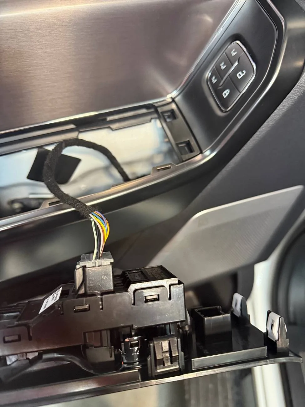

Waiting on something wiring and window switch to start working on the power folding and telescoping
Please let me know how that goes. I know some people have figured out the power fold on the standard mirrors, but not the tow mirrors. The dealership said I could just buy a wiring harness and the switch and I would be good to go. If I can just get power fold working I would be happy. It sounds like the wiring harnesses from the dealership are extremely expensive though. They also told me just to install the switch and the mirrors and see what happens. I found that interesting as well. But I doubt we would be that lucky.
And just to be clear when the parts department was looking up the wiring for me they said I definitely needed the wiring for the telescoping, but when it came to power fold he was wondering if the wiring was already there. So he told me to purchase the switch and the power fold mirrors and see what happens. I don't know if that includes programming. I remember years past power fold would work automatically but that was on my Lariat not an XLT.
Edit: unless you have a Lariat then you obviously don't need to worry about power fold. Mine is an XLT. I'm here in Michigan so this is a spring project for me.

lol it is crazy the lengths that Ford is going through to save a dollar when spending 90k on a truck. Switched the camera and activated the parking lights on the tow mirrors. Everything works like it should even the camera being swapped from my stock mirrors to the tow mirrors worked like a charm. Should not have to get them recalibrated. Thank you OP and everyone for the recommendation. I was ready to return the tow mirrors.
Did you ever get the telescopic feature to work? Looks like you don’t have a plug for the button same as me.
