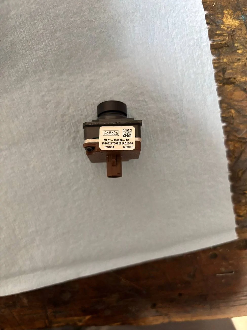

i ended up getting 2 new cameras from ebay.. cost about 350 so i didn't think that was bad sense the dealer wanted 750 for them... installed them and everything work great... i have the 2 old cameras from the tow mirrors... have no idea what year they would work on but I' can tell you they don't
Ford F-150 2024 Tow Mirrors IMG_3398
work on a 24.
