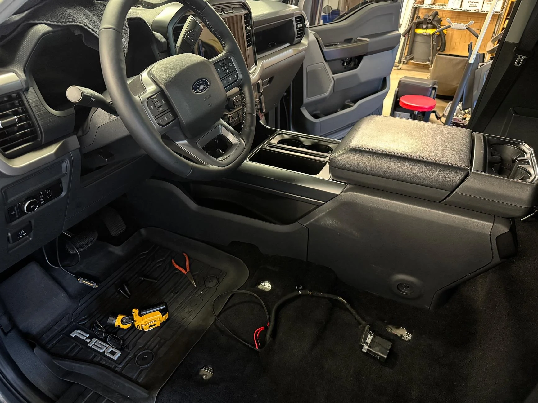

I made a little more progress last night. New black console installed and bolted in. All the dash pieces lined up correctly for a factory fit. Hopefully tonight I can get the seats back in. I need to run a hot wire for the passenger side. The fuse is in the fuse box but the seat does not work when plugged in.
