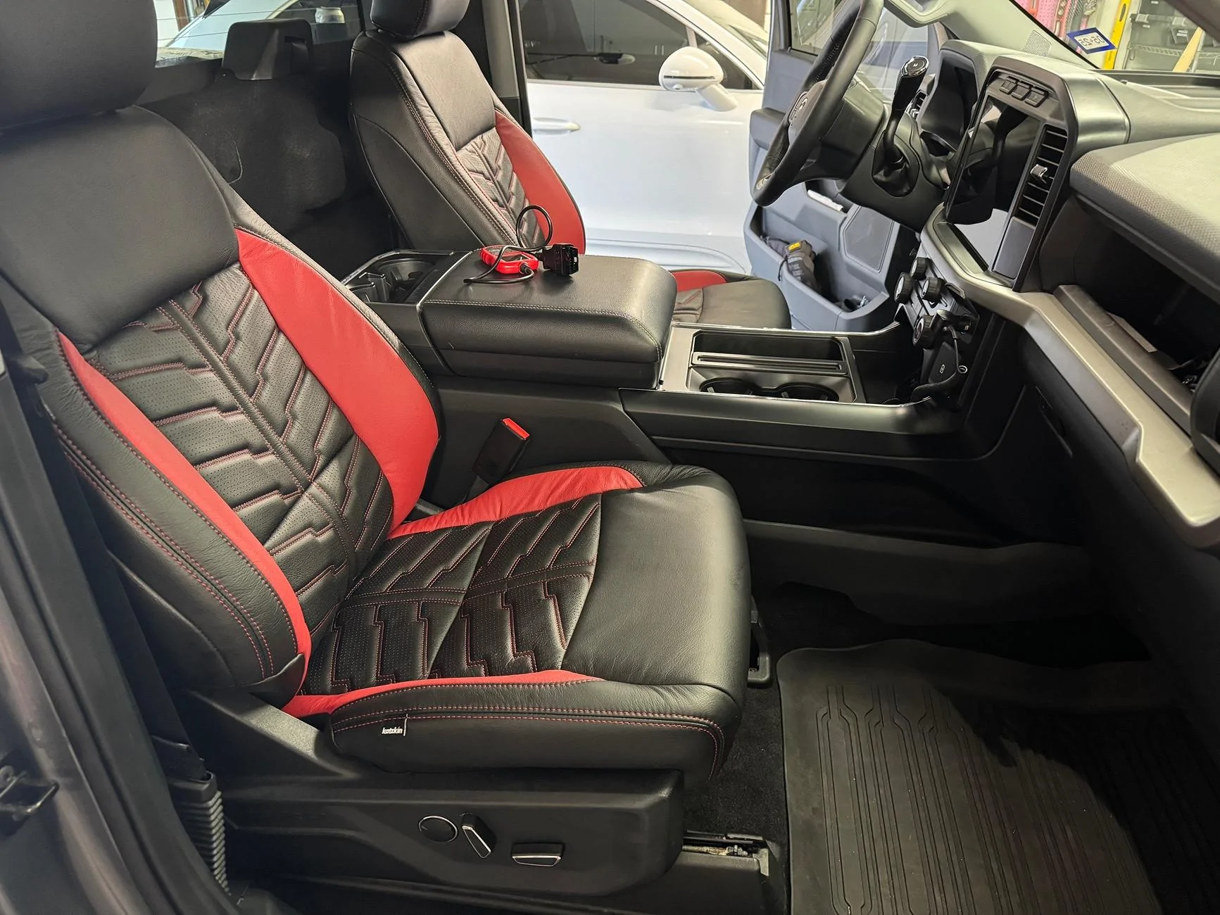

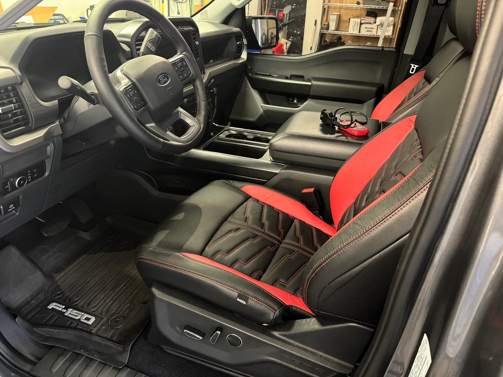

I was able to get the interior 95% finished last night. Both 10 way seats installed and working. The console is installed and working. I need to put the bolt covers back on and a few other odds and ends. I took it for a test drive and the interior is really quiet, it makes me want to do the roof with sound deadening material now.
I still have the same damn shaking and vibration in the rear. I will mess with it a little more this weekend.
I also have a seatbelt and airbag light from removing the jump seat. I will either change the truck setting with Forescan or remote the sensor from the jump seat.
Ford F-150 2024 RCSB build IMG_9905
