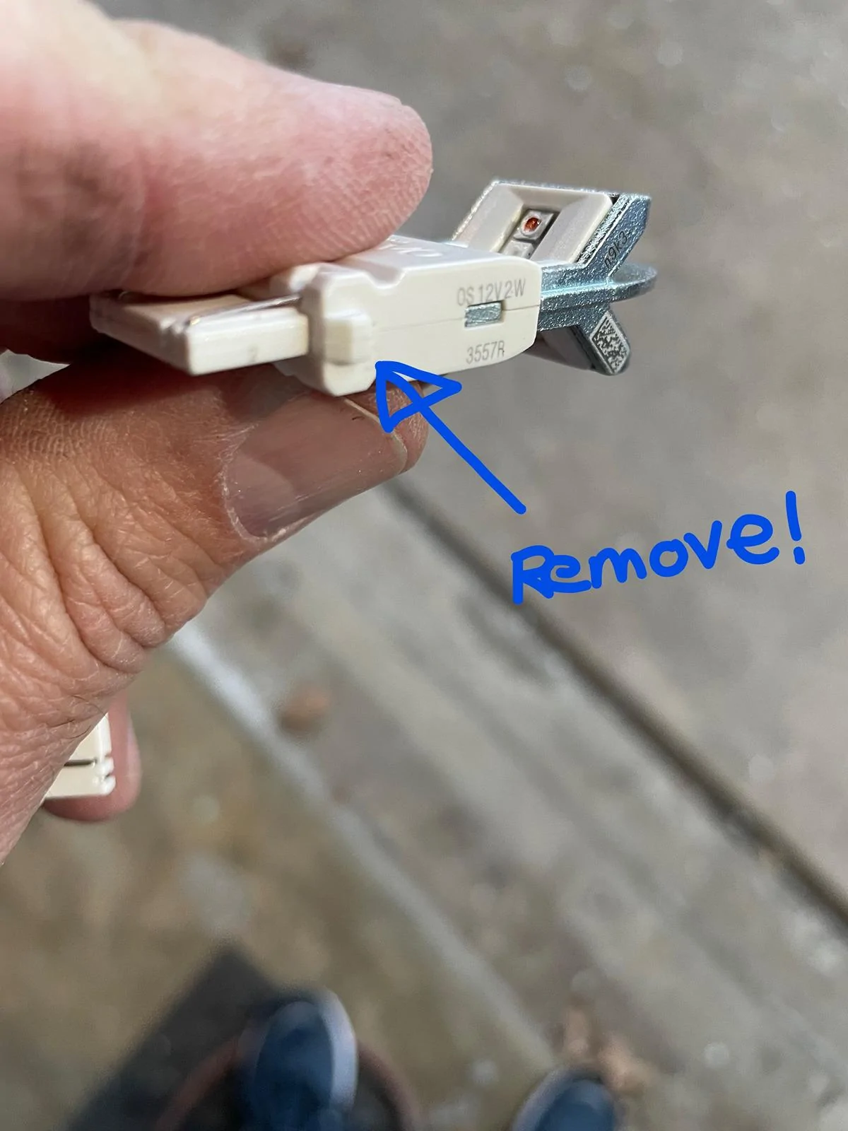

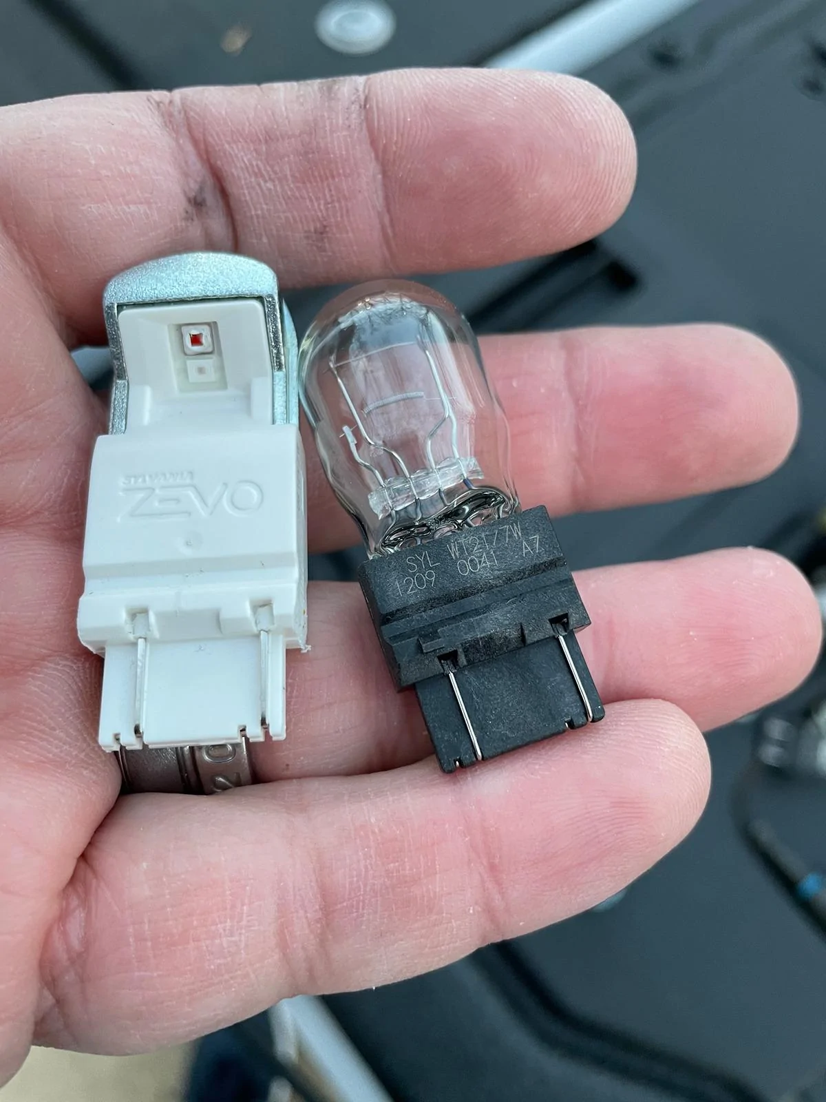

Being someone who can't leave well enough alone, I put Sylvania Zevo bulbs in my 2018 STX, then swapped them over to my 21 XLT PB when I traded up and they still work great. Bright, light up fast, and not to mention, WAY cheaper to replace the 4 bulbs than the OEM LED assembly should it fail. I know I paid less than $30 back in 2018. I think they run about $50 now for a set of 4 bulbs.
I did have to trim a little nib off the sides to allow them to fit the connector. No biggie.

Here's tail lights in daytime. Zevos in the left and regular bulbs in the right. Much brighter.

The PN on the bulb is 3557R but the Sylvania packaging shows a 3157R.
Be sure to use the "R" for red. It will not look right if you use a clear/white bulb.
$25.99 at Auto Zone or O'Reillys right now. You may be able to find them cheaper online though.

I will add one caviat - when I had my 2018, it drove me nuts ordering bulbs because for whatever reason, Ford decided to play a cruel trick on me and use different sockets on different corners of the truck. I ordered LED Switchbacks for the front turn signals and when I went to install, they wouldn't fit. The bulb PN was different than what the Ford manual showed! But then I checked the opposite side and it had the correct bulb - and of course the socket for it. Maybe they were trying to get rid of surplus sockets but they really screwed with my head.
So, moral of the story is pull your tail lights and check the bulb before you buy anything!
And you will most likely need to file down the little nubs on the sides.
FYI - these bulbs are not polarity sensitive, so you should be able to plug them in either way and not harm the bulb. But you will need to use Forscan to tell the truck you are now using LED turn signals in the rear. They will not hyperflash outside but the dash turn signal arrows WILL.
Go to: BCM 726-44-02 **xx xxxx xx--
You should see 01xx xxx xx--
Change them to 00.
