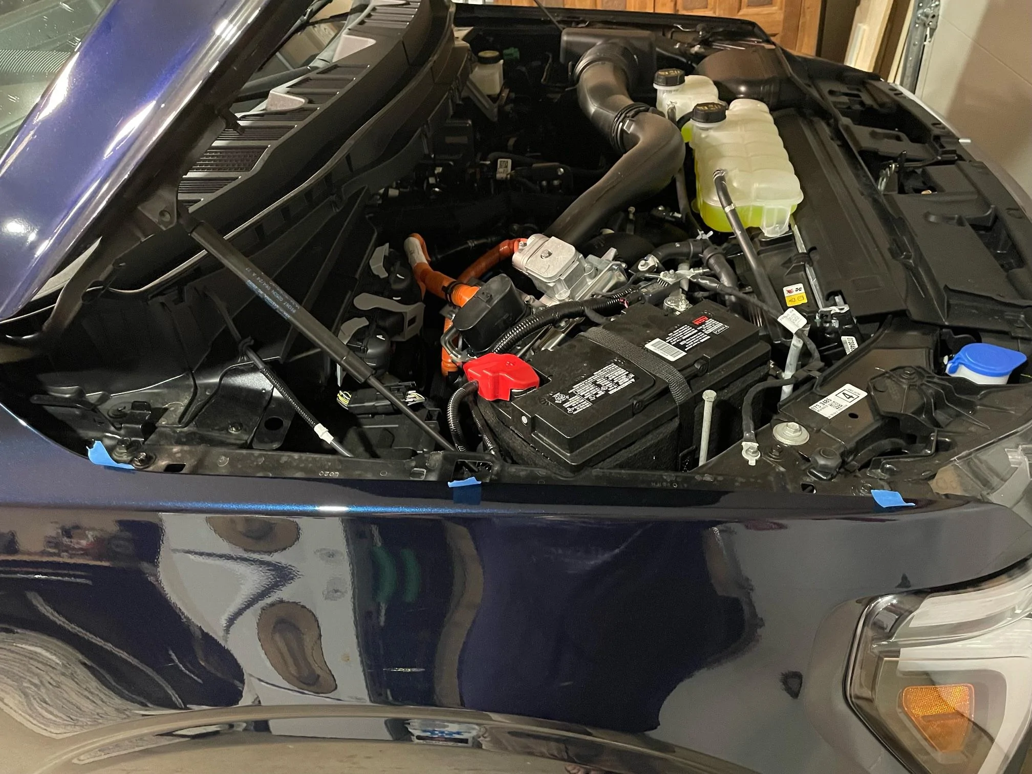

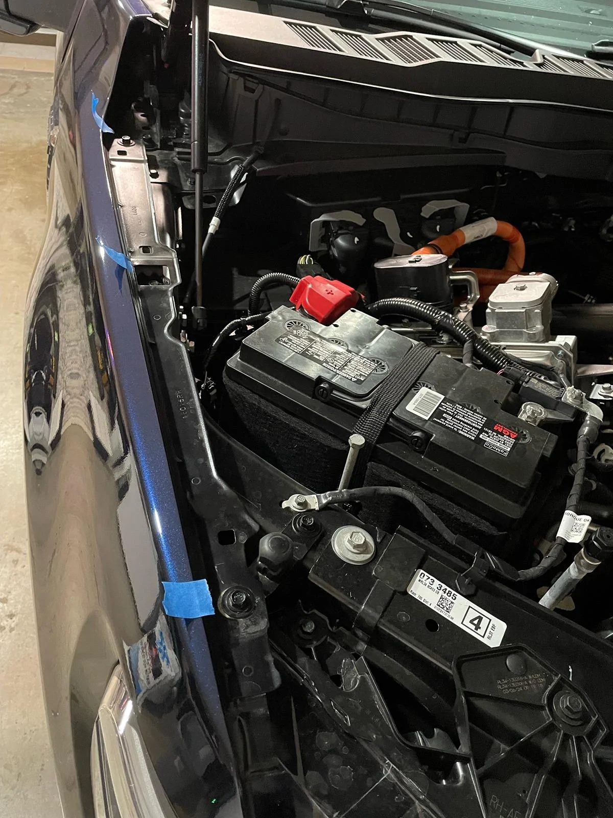

I put blue painters tape near the bolts I loosened. On the last pic, you can see the bolt closest to the front, how much it was out of alignment. Once I loosened these three bolts, I literally didn't do a thing. Once I loosened these bolts, the fender made a "pop" and put itself back into perfect position. As soon as it "popped", I retightened the bolts and it's been perfect.

I did it yesterday, it went as you described. Once I loosened the third bolt, there was a pop/tick sound and went perfectly into position. Totally parallel now!
I'm glad that worked for you and it looks great. I don't know how that happens on the factory floor. It's almost like someone is leaning on the fender while tightening down the bolts. At first I also thought that it was related to the two tone paint on the King Ranch and needed to realign after spraying the two tone but since it happened on your Platinum too, that theory is dismissed. At any rate, I'm glad it worked for you.

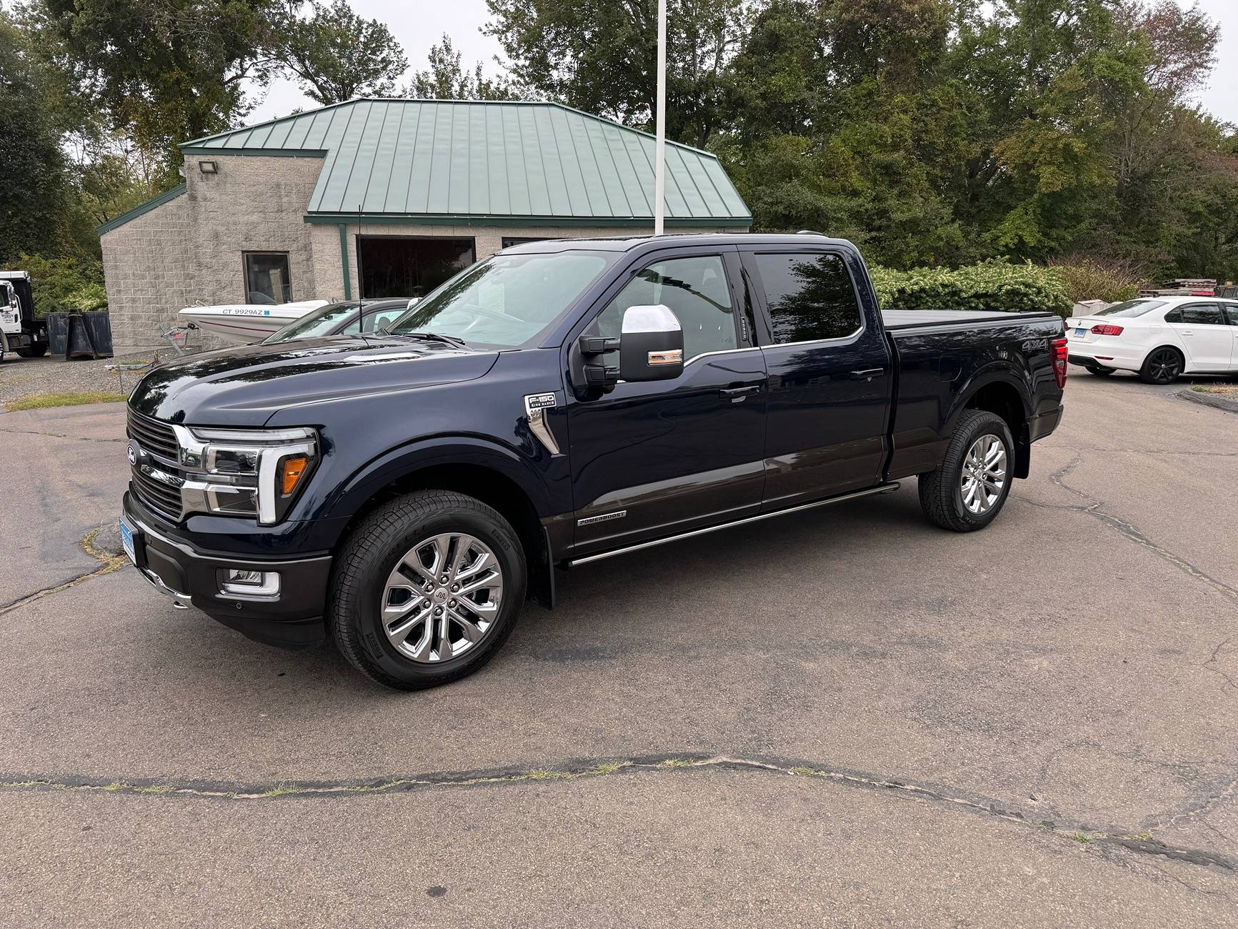

To answer at least some of your questions. 2025 KR will have the “marsh grey” as the two tone color on the lower body panels for King Ranch(2024 had bronze). Won’t see an actual picture for a while based upon production and delivery schedules. Also the two tone is NOT optional on the KR. Here is a picture on my antimatter blue/bronze two-tone:
