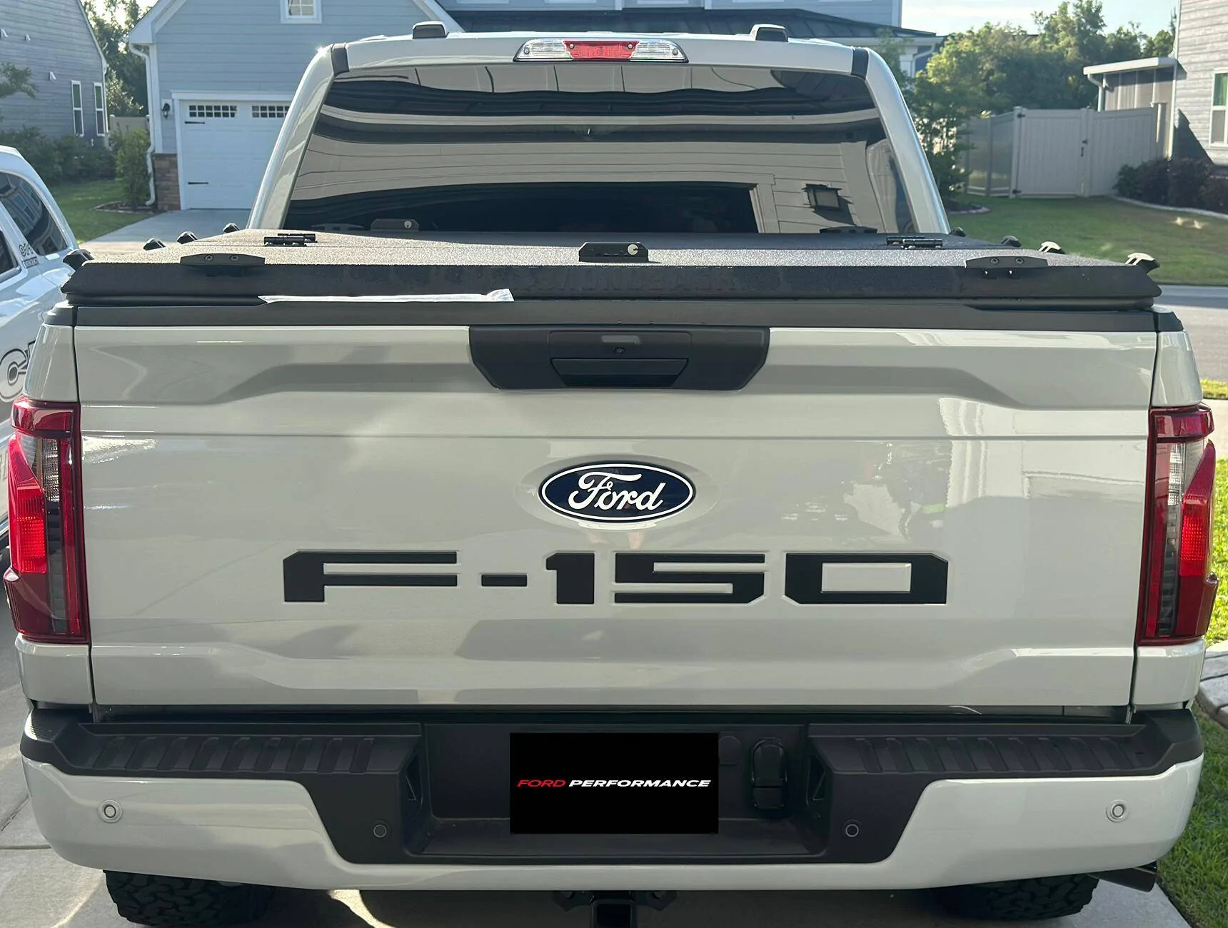

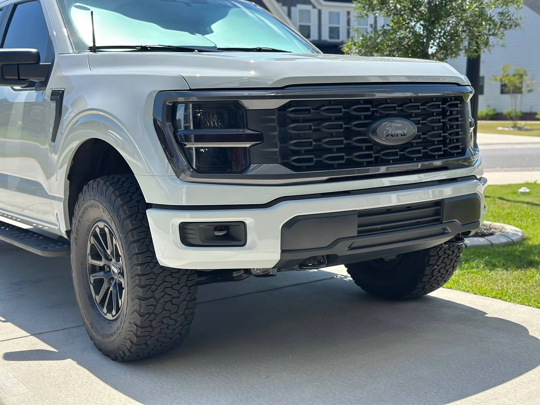

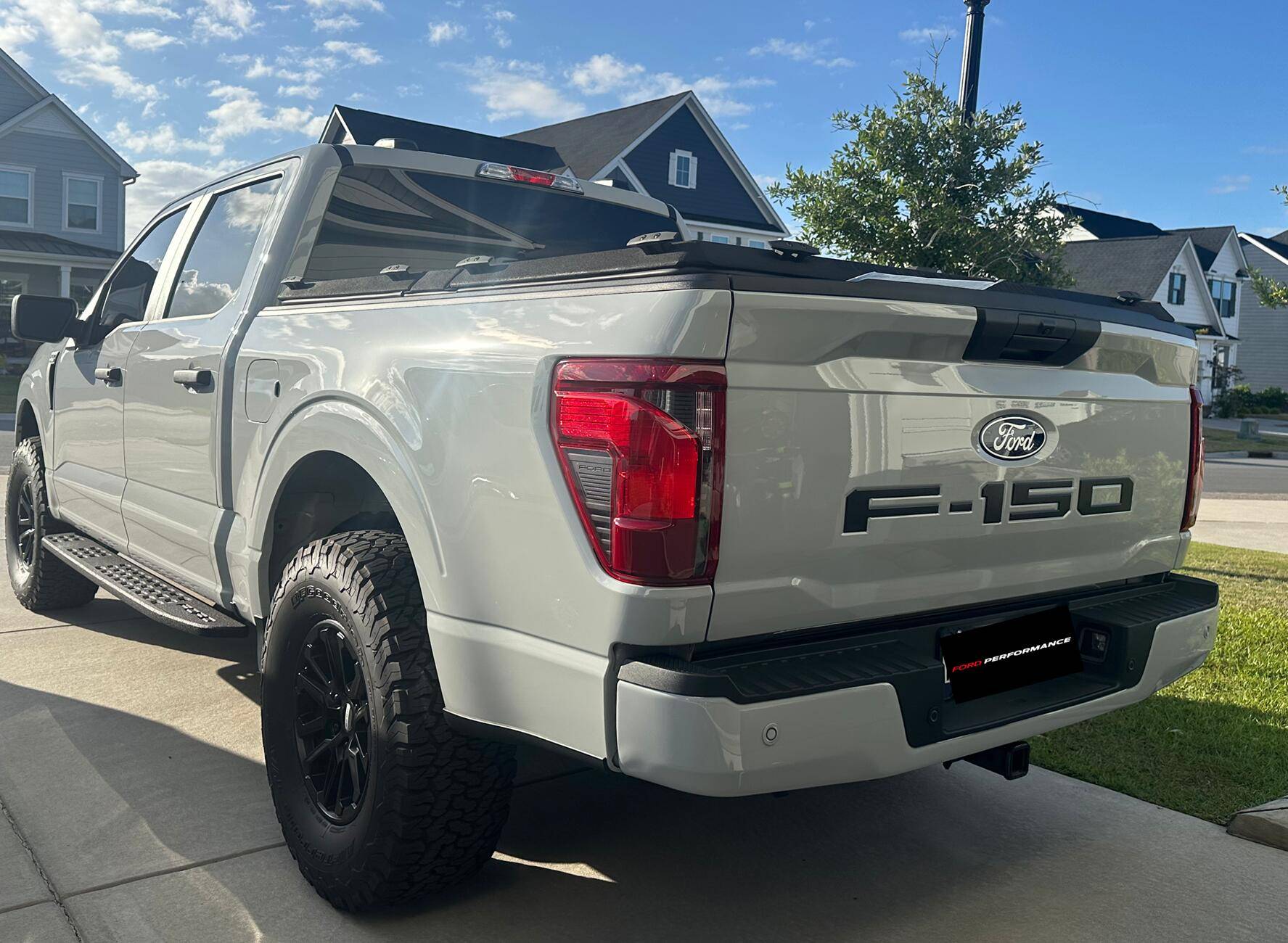

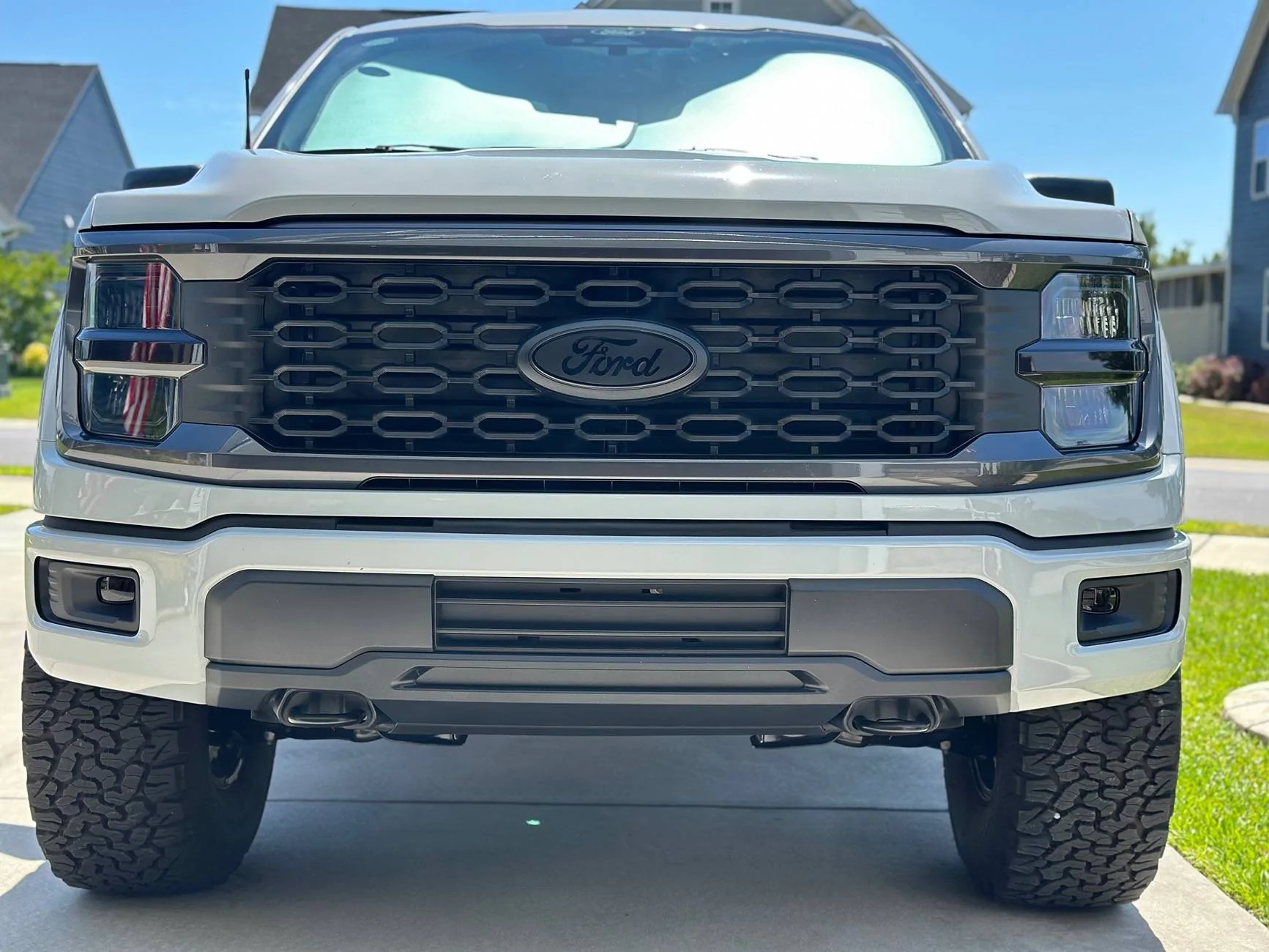

Here is how it currently sits.

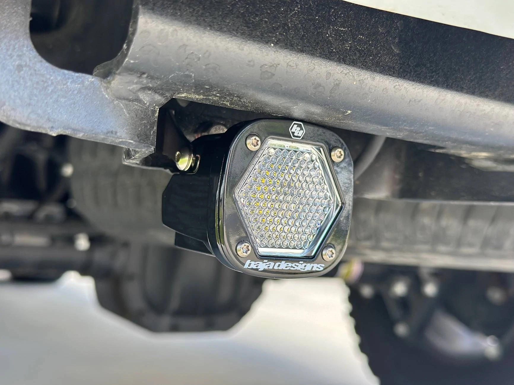

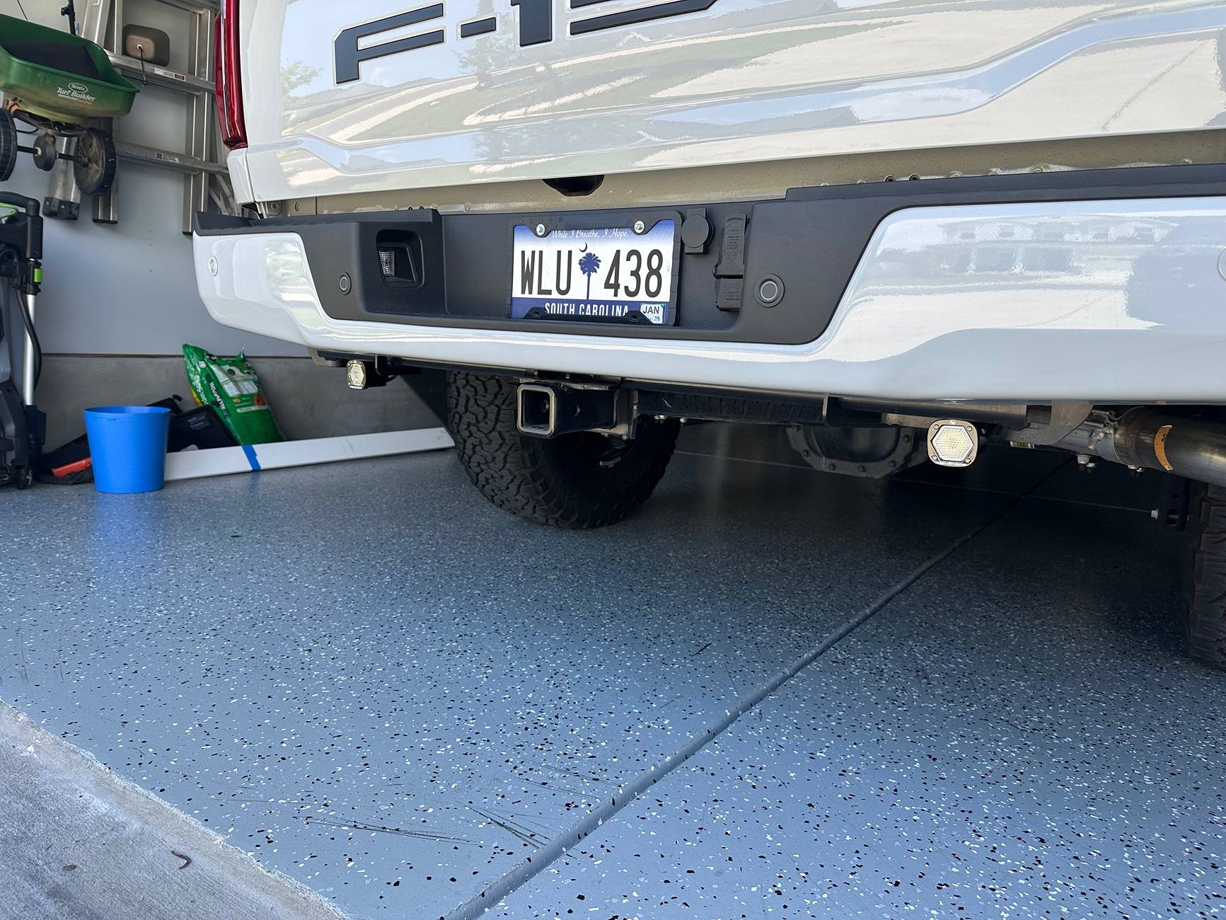

Baja Design S1 lights installed and wired up. You don’t need anything special or any brackets, they bolt perfectly to pre-existing holes in the trailer hitch. Wired them using the factory harness that it comes with into the trailer connector. They come on automatically in reverse. Just got them installed so no night shots.
Ford F-150 2024 Avalanche Build IMG_3932
Ford F-150 2024 Avalanche Build IMG_3931
Ford F-150 2024 Avalanche Build IMG_3926
Ford F-150 2024 Avalanche Build IMG_3925
