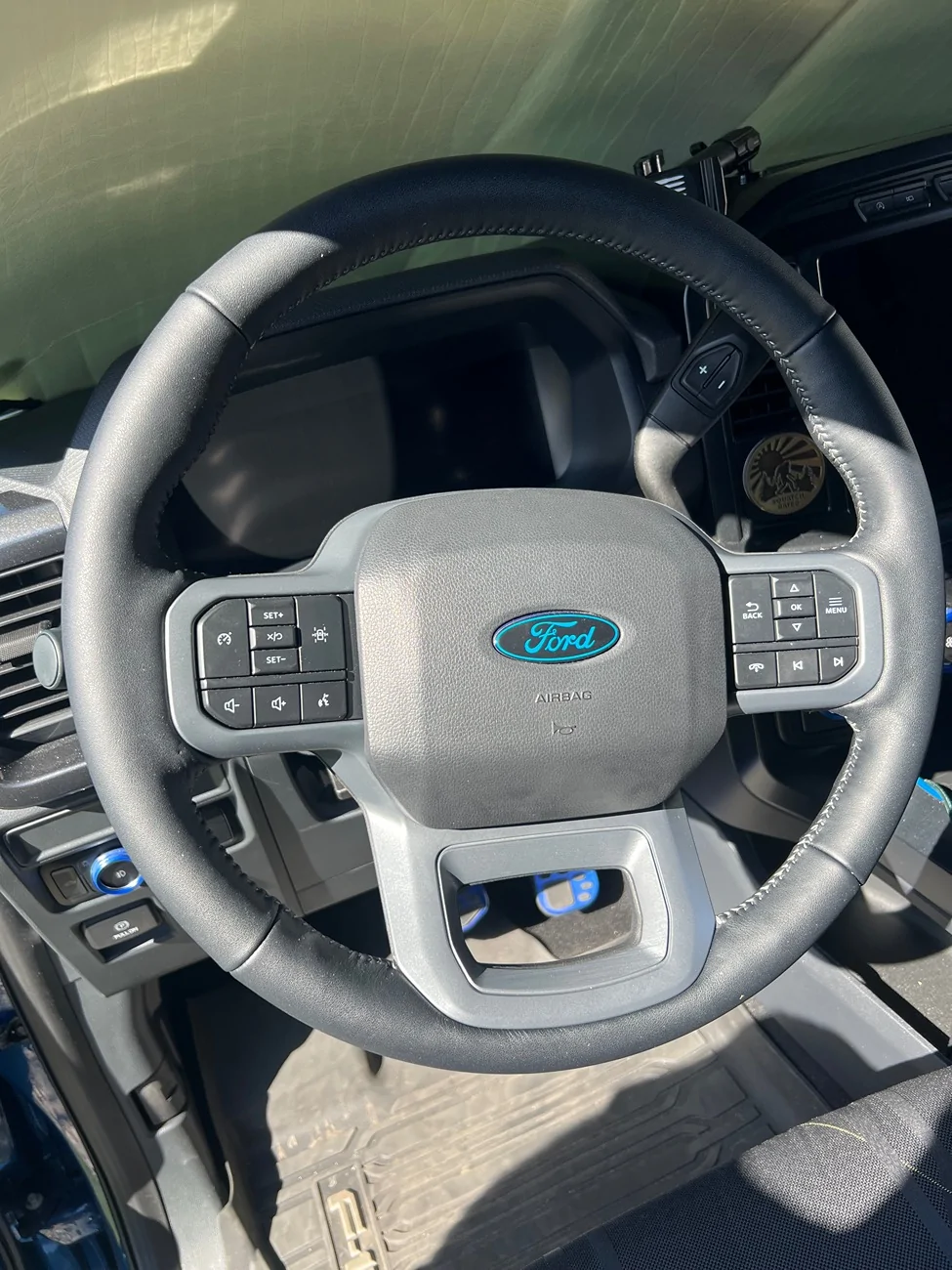

Today I fixed the biggest issue with the STX, the cheap rubber steering wheel. I replaced it with an OEM leather wheel from beat for $200.
I liked the aluminum colored trim the new wheel came with vs the black one on the STX but the buttons on the new wheel were different. No biggie only 3 screws in each side hold the buttons to the trim so I swapped them. Much better
