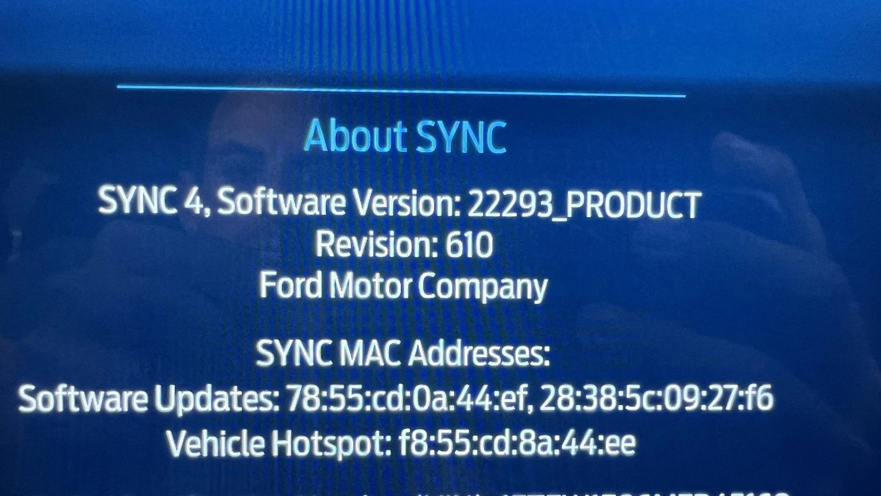

Well the truck saying it is up to date doesn't mean it actually is....Go into settings/General/About Sync and see what revision you are running. You're most likely not up to date.

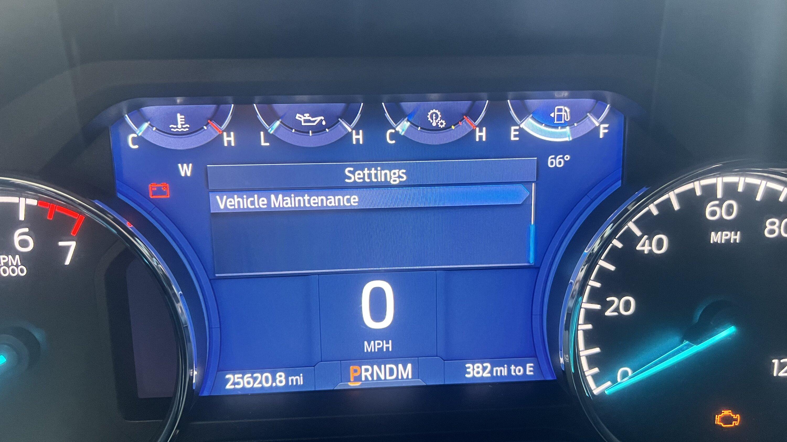

The only option under menu settings is Vehicle maintenance

Use the up arrow on the right side of the wheel . You are at the bottom of the list of options from what I can see. Menu, up arrow x 4,

No that’s the only option. If I go up or down that’s all that shows

So I accidentally solved the problem with the boost gauge. While troubleshooting my SCT tuner over the phone with SCT, they had me disconnect the battery for 15 minutes. After I did this, everything in the truck reset and I now see the configure gauges option and got the boost gauge to come up!!!

Looks like your truck is one that has "skipped" updates as rugedraw has been warning about lately.
You'll need FDRS and maybe more help to get you back on track. Suggest heading over to the VIN lookup thread.
