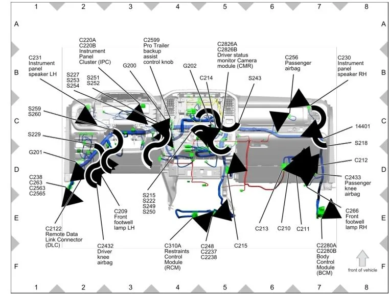

Keep in mind that a multitude of multi-pin plugs are now a fact of life regardless of hybrid or not. I've remarked about ensuring plugs are fully seated. Worth a look-see.
Is a list/map of what connectors we could check ourselves? Is there anthing that the community has compiled that may facilitate troubleshooting?
Thanks
There's a 5000 page wiring document that you can acquire. Similar to the 18000 page factory service manual.
It has pretty much every electrical component/connector found in the truck. Absolutely daunting. Makes me wonder how it is possible that I could get one of these modern vehicles home with EVERY SINGLE pin in every connector connected properly without flaw. ??
Sample of the many thousands of illustrations
(all properly indexed)
You made my point far more eloquently than I. The assembly line discipline to ensure every, and I mean every, multi-pin plug is properly seated is a daunting task.
Not at all. I just cheated and used pictures. You know what they say about pictures. They are worth....... ?
