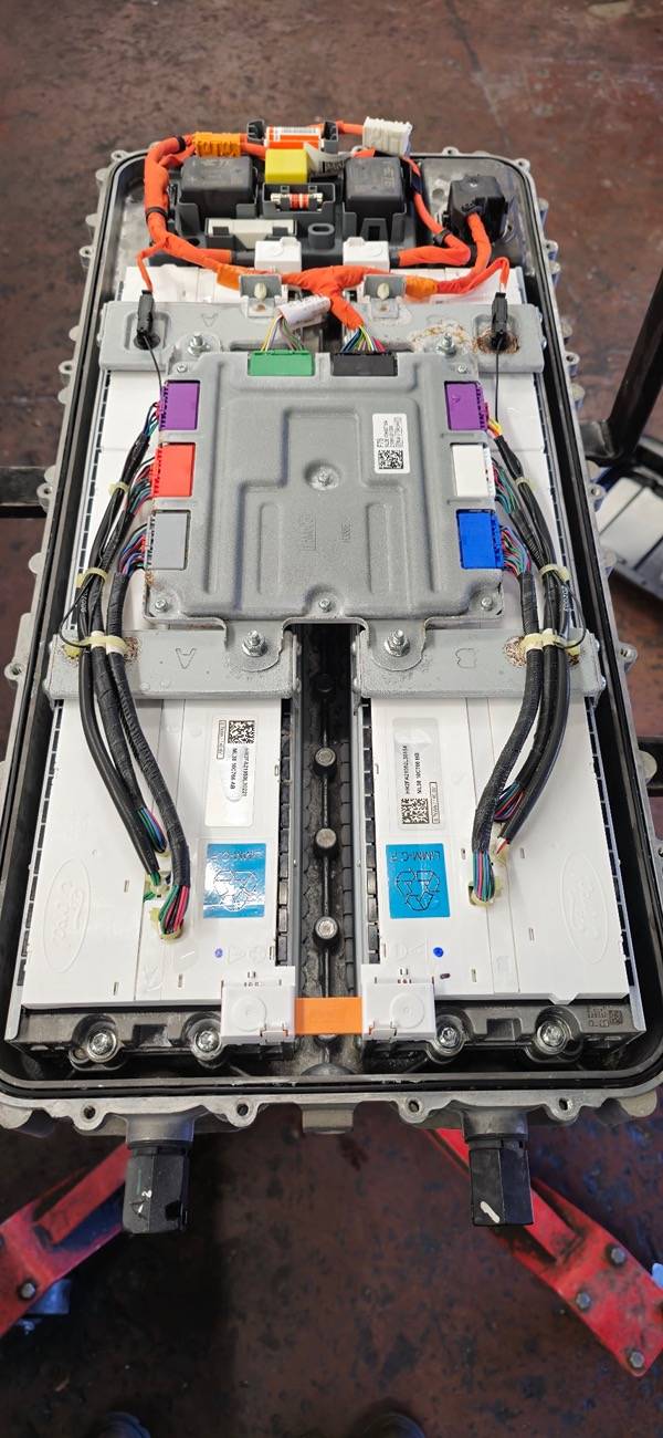

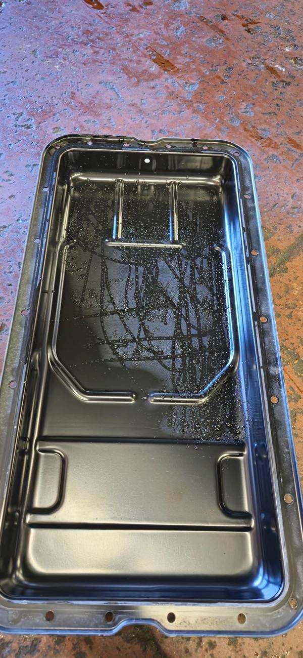

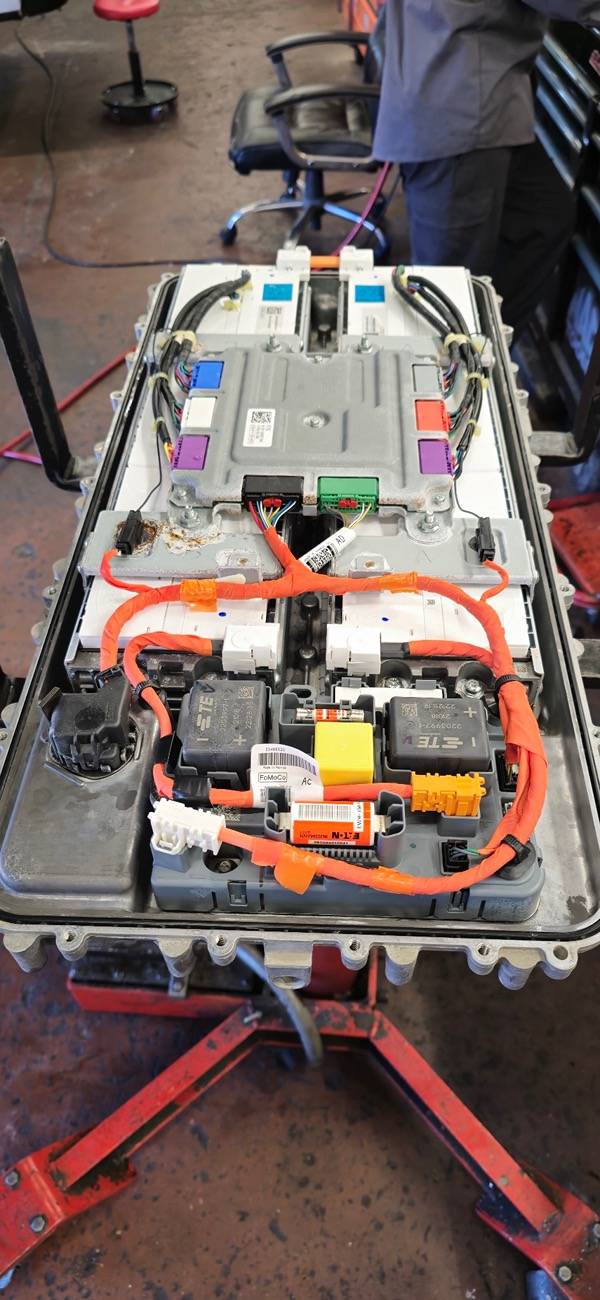

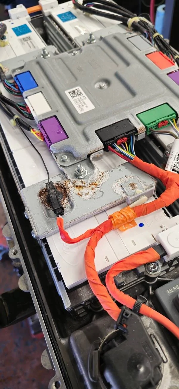

My 2021 PB king ranch (74k/mi) is in the shop now due to the “Stop Safely Now” alert. It disabled the truck in my driveway. Had to be flatbed towed to dealership. They replaced alternator and battery under hood. No fix. They then got into the hybrid battery and saw corrosion and moisture. They are now wanting me to cover it because warranty does not cover water damage. They said the only way this is possible is that the truck was submerged! Which it absolutely has not been. I don’t even own a boat. So the boat launch excuse they tried to say, is out. My ticket is 6400$ Anyone heard of this happening before? I’d really rather not get my lawyer involved. But what else can I do, then just pay it..? See ‘as found’ photos I was sent by dealer attached.

If you haven’t already I would do what I mentioned above- ask the dealer to reach out to Ford about financial assistance and call Ford directly and open a case. I would keep pushing for Ford to cover it. If you haven’t had it submerged like they suggest, and I’m sure you haven’t, there is obviously something wrong with a seal somewhere to let water get in there.
I am no ford battery engineer
But is thst a hole for some sort of plug or wire harness in the cover right near all that condensation??
Imo
I would be interested in what passes through or sealed
I asked the same thing when I went up there to see the “submersion” damage they were claiming. It is a hole with a thin see through paper type material over it. They call it a breather.

Breather lines are common, for example your differentials will have one. However, they almost always have a "riser tube" leading well above the differential. They also usually have a one-way valve at the top. A breather that is "paper" taped over a hole is not a breather, it is a manufacturing defect.
Agree with above
A hole with a thin film over it..is not a breather.
Any pb owners here ...is there a tube hooked there?
Logic says yes
No way ...well
I wouldn't think there is no breather tube attached to that hole...it's obvious..at least in pic....it's hmmm nor keeping water out.
Could this possibly be caused by an automatic car wash underbelly spray?

Pretty much every lithium batteries on vehicles have these. It's a gortex patch to let water vapor out and keep liquid water out.
The dealer is full of shit. That level of corrosion takes months to occur.
You can get a replacement batt on ebay for $500 but the BMS unit (has all of the connectors attached) needs to be brought over. Looks like it's isolated to that one connector. Biggest concern is that level of water isn't coming through the gortex. How's the rest of the frame look? You can't be in water that long w/out having witness marks on the rotors for water submersion.
Call ford and get them involved, no way that happened in that low of mileage on a new truck.
