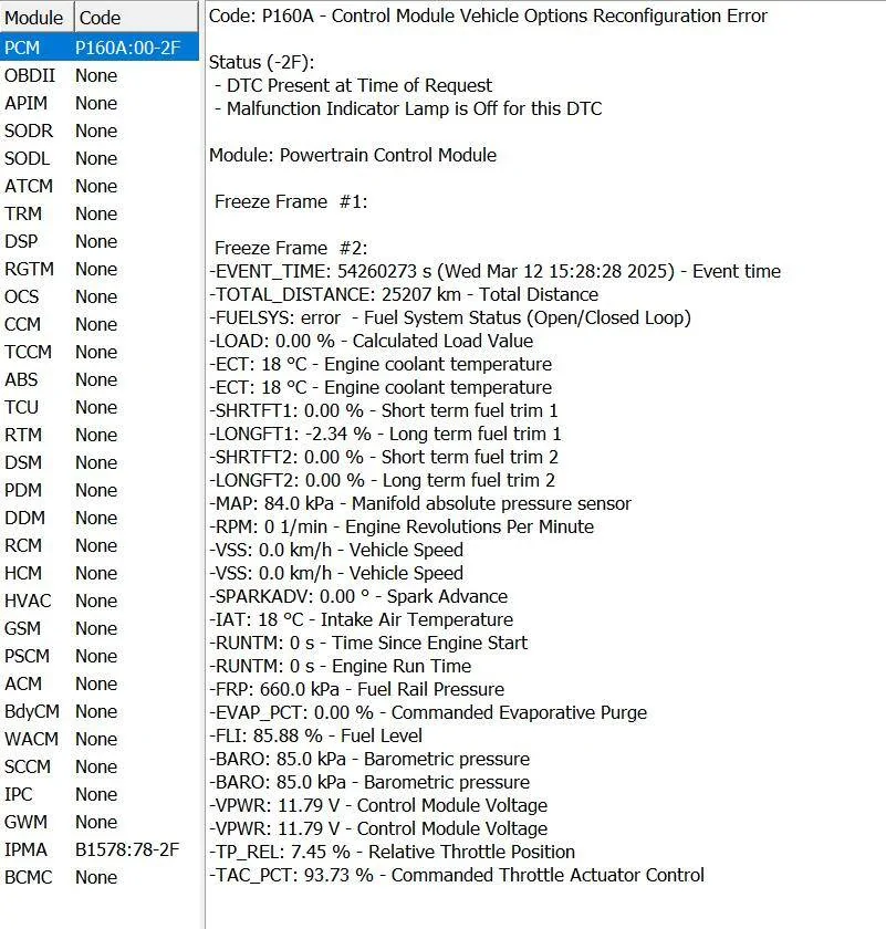

Hey guys. I have a 2023 F150 Tremor 402A. I need some help clearing DTC's. I have done several programming and now I realize I have these. I tried clearing them but its not working. (See errors in the pictures)
Some questions and comments on the programming done has been:
1. DRL Full Brightness (Set to 75%. and 60%. Deciding still which one. Is this change only when headlights are on? Or same if they are off? I didn't notice much during daylight)- Worked
2. DRL Allow Fog Light (when driving and I try to turn on fog light it doesn't work. I want to revert it but didn't save the prior value/number that was present before putting 00. I do have original built BdyCM backup but that will revert a lot of things already done) What goes in BCM 726-38-02 originally? So I can rever this?
3. Auto Start/Stop Disable: My vehicle came with this off from factory but after the last update it turned on so I did Forscan)-Worked
4. Double Horn Honk Disable (when leaving with key)- Worked
5. Tire Size. I have a 315/70R17 Raptor take offs. I initially changed the mm in the easy mode but didn't account or know about the .967 ratio and I also didn't do the relearn procedure. After driving I noticed it didn't work and I revert it back to a 2547. And again I failed to write down what mm was there originally for my 275/70R18 stock so hoping the 2547 was right. I was going to follow the instructions in the excel sheet to change tire size but I didn't want to mess with it more until finding out about these DTC's).
6. I did do the Auto seat temp mod. However I reverted it back. I didn't like that I couldn't see what was the current temp of the hvac for driver or passenger on the top of the screen.
7. Turned on the double honk once you lock your car twice with the key. I like this because sometimes from far away I want to ensure the vehicle locked or trying to find it in a parking lot.-Worked
8. F Temperature to show in gauges -Worked
Your help is appreciated.

I can only speak on the p160 code. Your tire value is off..I have seen this several times changing tire sizes on a few of my sons trucks…after you set your tires size. Did you do a pcm relearn. Then try to clear DTC …if this doesn’t work. You can go back to the original tire size the slowly go up or down to get close to the size you need..I had to do this on a friends 15 f150 …also if your tire size did not set a cel you can still roll with your different value and not have any issues…had this on a f250..I’m sure some other guys on here can help on the other issues..
