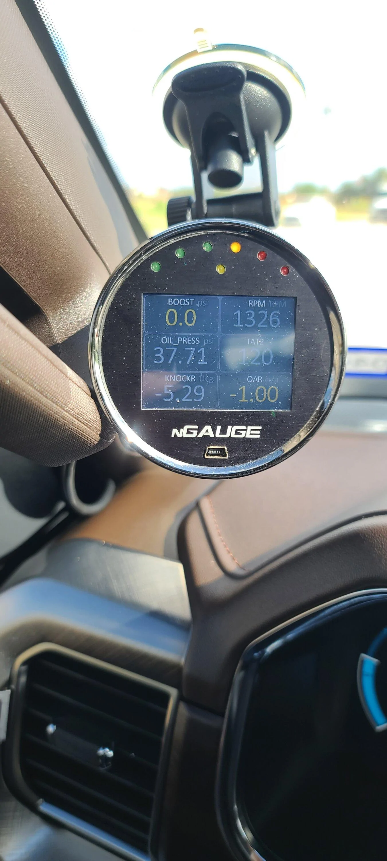

I believe oil pressure is like every other vehicle after 2010 and it's just dummy gauge. Pressure good or pressure bad. There was discussion recently because there is no PID to get a number on scan tools.
There is an oil pressure pid in Forscan and HPTuners for the Ecoboost. And it's not weighted at all. Very granular and reactive. Definitely reflects the 2-stage "variable pressure" oil pump.
I'd right a check for steak dinner for the whole family if someone could crack/sniff that PID address and formula, so I could add it to my OBDLink dashboard.
And doesn't the Raptor IPC have oil pressure?
Edit: The oil pressure Pid has been cracked by @fordtruckman2003
He is refusing the steak dinner, but I just want to give credit for his generosity and cleverness. :)
Hmm so I read wrong then.
Surely it's a standard Ford PID? ?
It's definitely not SAE
And the guys at Forscan and HPTuners knows what the PID parameters are. I just don't want to use a Windows tablet or legacy Ngauge to monitor oil pressure when neither can compete with the OBDLink app for the electric side of the Hybrid.

Ford has history of not having any PID for oil pressure across multiple vehicles. Interesting they would add one with real value to these trucks. Or is it just reading the fake number on the dash? ?
