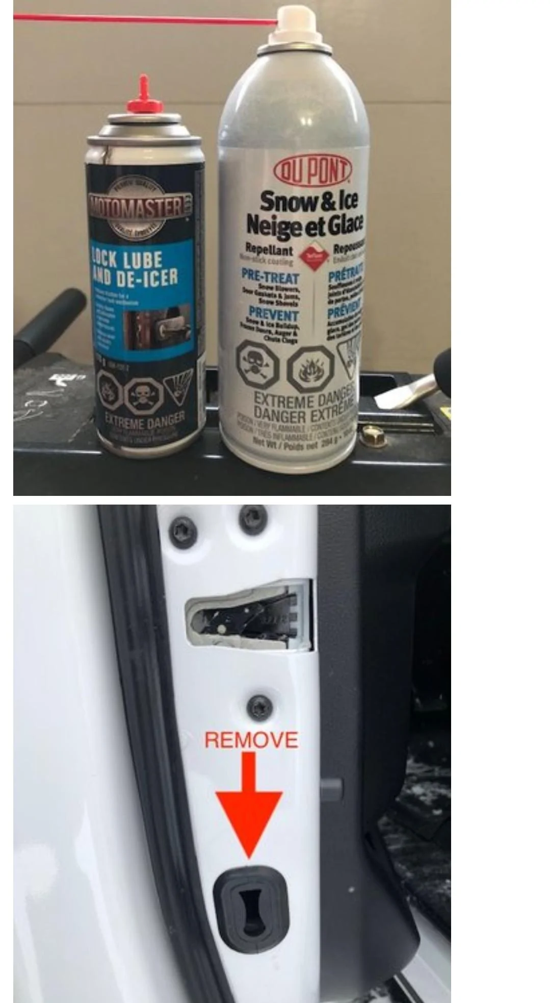

Temps dipped down into the teens overnight/this morning. And I had the issue again. Either I didn't spray well enough, or because I didn't use the same product. One thing I have noticed the last couple times this has happened is if I punch in the SecuriCode # on the door, it let's me right in, but the other unlock methods don't. It doesn't make any sense to me.
What product did you use? Just curious.
Were you able to see exactly what you were spraying?

A bit of an interesting update to mine. I have had it happen again now that the very cold temps have returned. I do notice if I go for a drive / trip and immediately lock the doors, I can no longer open the driver door with the issue. If I leave them unlocked until everything returns to a below freezing temperature, the door seems to work fine. Tonight I went out and it was about 14ºF and tried the method of leaving it unlocked and the door opened just fine. Ran some errands and never let the truck get cooled off. Returned home, locked immediately because I figured I was in for the night. Well had to go back out (currently 2ºF) and have found the lock stuck.
