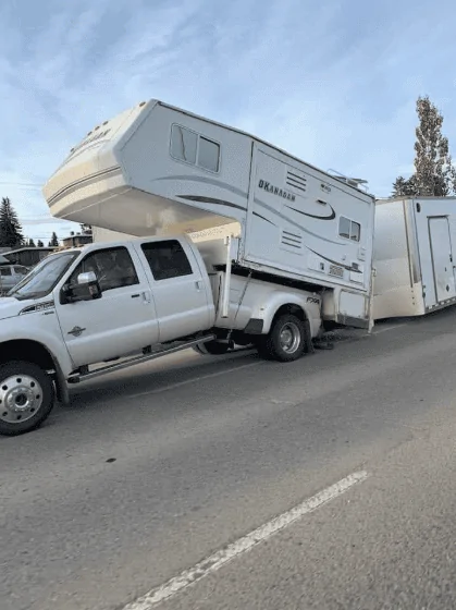

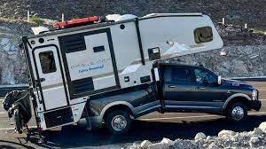

The problem with this wasn't so much of a payload rating -- regardless the options, that would have broken any of the 3500 frames in the exact same manner. This had to do with where the weight was. I wouldn't be surprised to hear that at least 3klbs were behind the tailgate. Poor mass placement combined with shitty roads = fatigue crack. Had the weight been over the rear axle instead of 5' behind it, this wouldn't have occurred. Given that's where most of the storage space was, I'd bet this guy had all the weight in the rear because it was the easiest spot to load it.
I'd love to have seen a scale ticket as configured, vs empty truck. I'm surprised he didn't notice how much weight was missing from the front axle. I bet "it drove great, the steering was very light!"
you are applying logic
not to beat up some drivers, but the consenus from RAM folks is the 3500 is the top dawg and can pull anything and carry anything because it has a cummins engine
its the mindset and i see it everyday at rv parks
same with dipsticks using a f250 to pull 25k lb fifth wheel campers with 3.31 gears and wonder why the truck is beat to crap
very few actually load or weigh the load or rv
but yes a look at his actual weight sheet would be nice

The e-bikes or motorcycles he had on the back were 8' from the rear axle. Curious what he had on there. One image they're both covered, the next one is missing. No doubt the ultimate straw that broke the camel's back.
I like how he said he'd just get a 5500. Key point -- it's been on it since day one. Someone should tell him if he wants to full-time RV, perhaps consider one. For the same price he could have gotten an RV and a small errand vehicle to pull behind it.

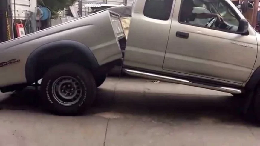

I'm not saying the Ram and the Super Duty weren't overloaded, but if enough salt, moisture, and time is contributed to any truck frame, you can reduce it's payload to zero.
Sure can!
