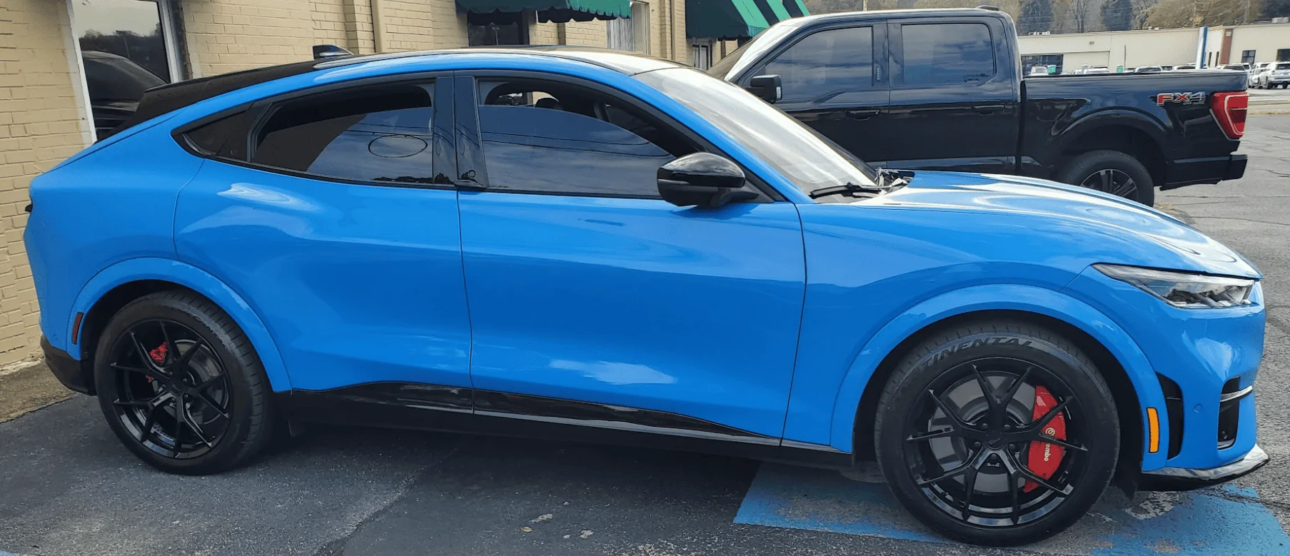

Forgive me, what's "MME"?
Fordphanatic
Mar 6, 2021
669
624
Boothwyn
2021 Platinum F150
Union Carpenter
Pelican
Feb 18, 2022
416
374
2024 F-150 Lariat (502A) Supercrew POWERBOOST
Financial Management
Ok. Thanks. I like the color
