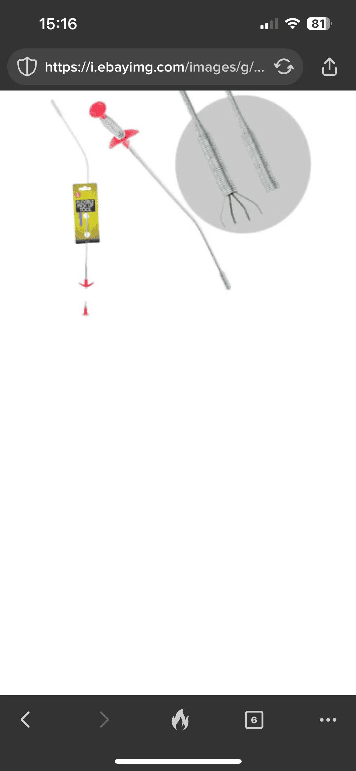

Props to you man! I tried seeing if I could route under the carpet but it just didn’t seem like an option with all the dips and hills. Ended up just coming under the console as there are some decent gaps so the wire was not pinched.i did the slide the console back method and installed the cup holder and such like normal. Then I moved the seats all the way forward and up, flipped up the back seats so I can lay back there, lifted the back of the console up and set it on a small box to keep it in the air. Then fished the wires from the hole in the carpet under the console to the wiring hole under each seat. Of course, you need to run it so that it will not get pinched or cut when the seat moves around and tie wrap it all up. I suggest plugging in the y harness from the cup holder from the top and feeding it down to where you can grab it once you lift the console up. Makesure the connection is good and tight cause I don’t think you’ll be able to see it from the top once it’s all tied up under the seats and in place.
I used one of these.Props to you man! I tried seeing if I could route under the carpet but it just didn’t seem like an option with all the dips and hills. Ended up just coming under the console as there are some decent gaps so the wire was not pinched.
