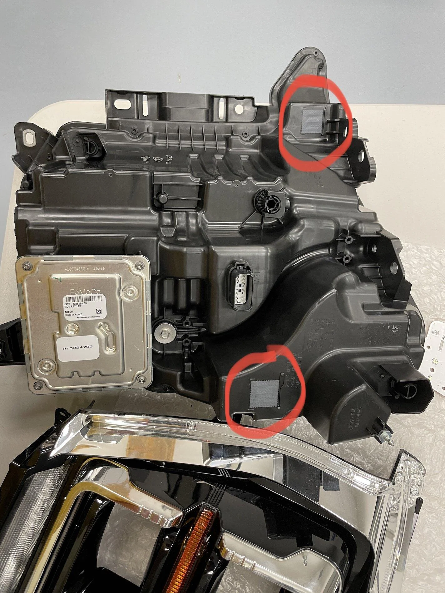

Just following up since I was the OP. The condensation went away as expected.
I made an erroneous comment in a previous post about the headlamp unit being sealed. I was justly corrected by another member. I’ll take my lumps over that one. Embarrassing for me being that I work in the LED automotive lighting business. Not in the design of the headlamp assemblies, but just the light sources and supporting electronics.
That being said, the photo below is a current F-150 ADB HL unit that I have at work that I was benchmarking. The circled areas are the vents on the backside of the unit.
Ford F-150 XLT 302a Condensation in Front HeadLights 1621892316889
I am sure hoping to avoid hitting anything that would damage my headlights as that looks like a single unit replacement that isn’t cheap. Had a leak in a 2012 Maxima headlight that cost $1200 and I really don’t think I want to know what this will cost if damaged. I’m guessing over $2k.
The ADB lamp is certainly going to be a very costly replacement part. Active cooling, servo motors…..quite complex on the inside.
