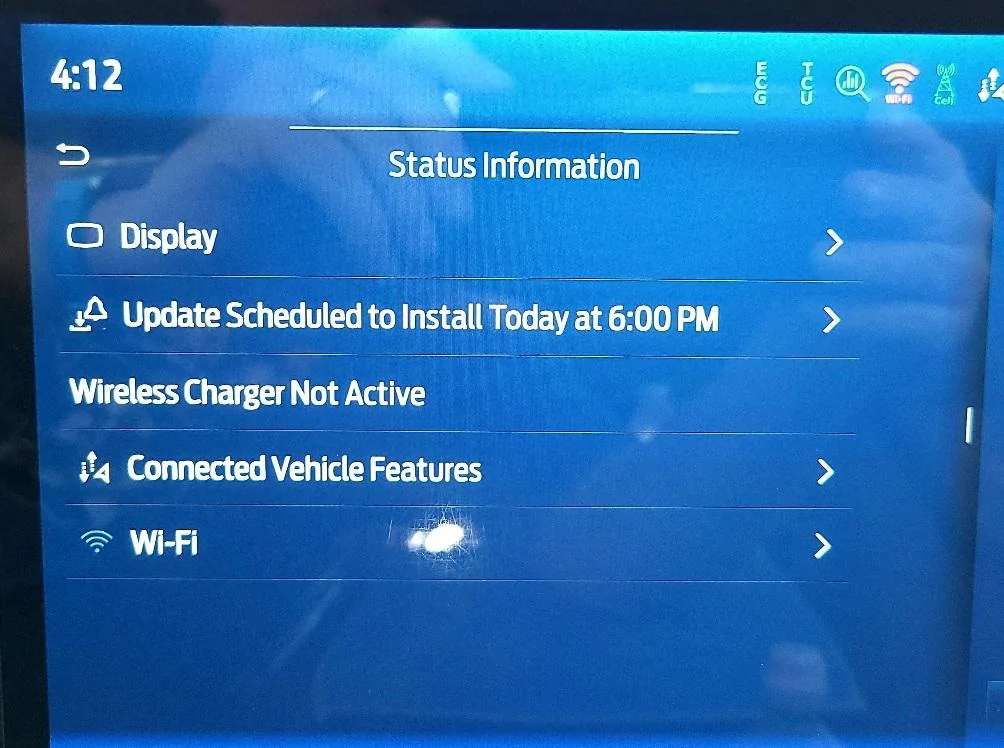

About an hour ago I noticed the icon on Sync notifying that an update had been downloaded. Sure enough there's an update scheduled to install at 6pm. (a few minutes from now)
But in the quest to get more information about the update, I found that I had received a successful OTA the day before yesterday.
It was 23-PU1113-UNX-DC
And I was clueless
How could I have not noticed a PCM update?
And I was clueless
I'm getting too old.
What did the new download turn out to be?
What did the download turn out to be?
It appears to have been a phantom notification? Because nothing happened and at around 6:15 I got in and started the truck.
Nothing new and the message regarding the 6pm install was gone.
Perhaps it was a lagging notification for the update on February 22?
This was what I got on Sync screen around 4pm
Ford F-150 Wrench Light after PCM OTA 20240224_161206
FordPass shows update for 2 nights ago though
Ford F-150 Wrench Light after PCM OTA Screenshot_20240224_162733_FordPass
Not sure what to think about it.

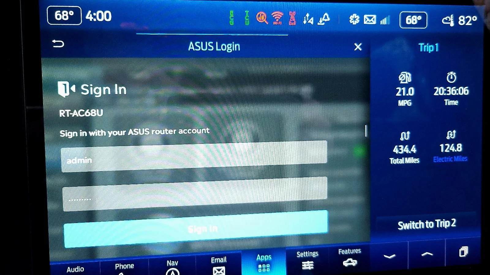

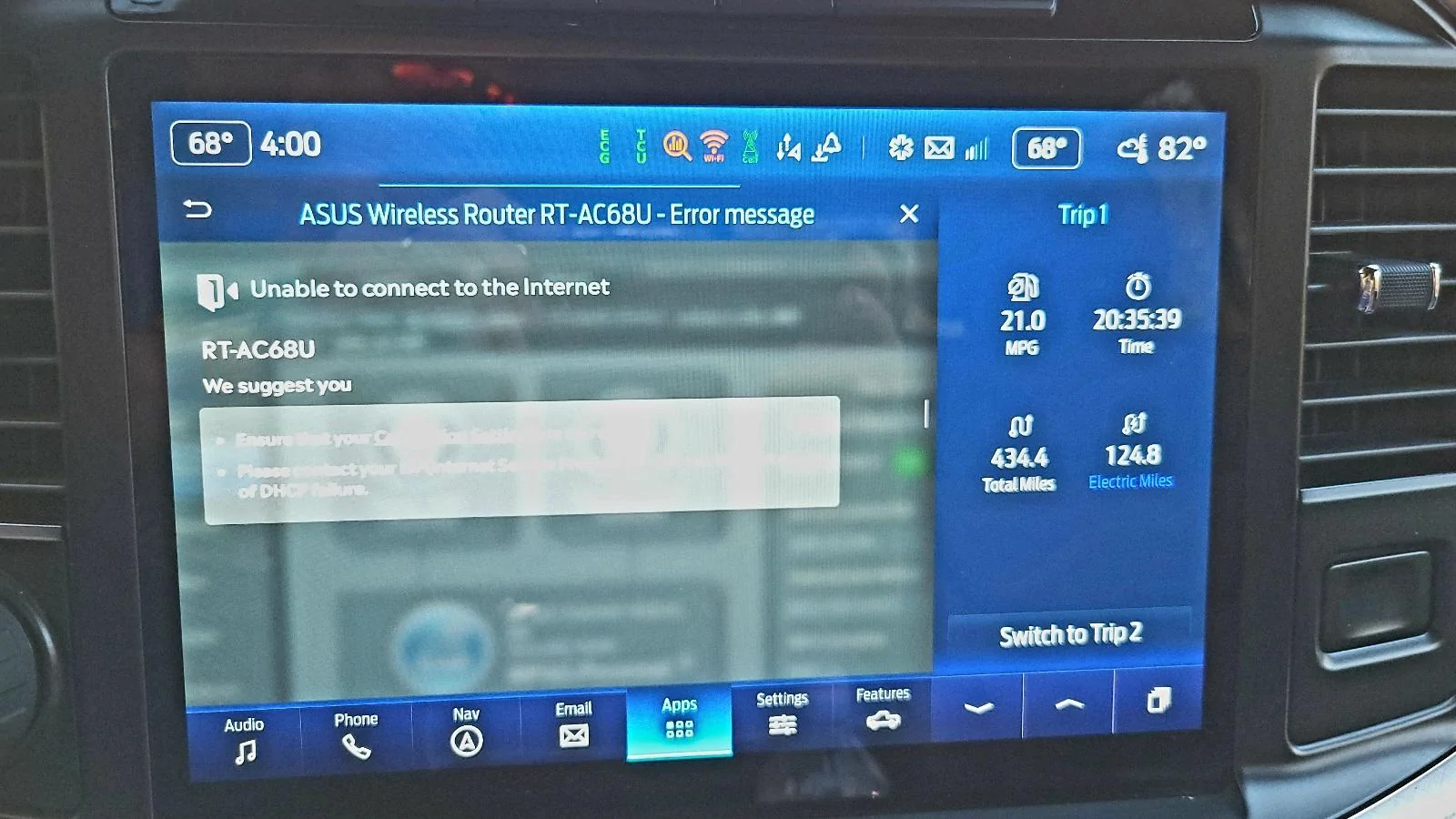

But that's not nearly as interesting as what popped up on the screen when I got to the RV and the truck connected to my Wi-Fi.
Sync does this randomly and I can't for the life of me trigger it intentionally.
Ford F-150 Wrench Light after PCM OTA 20240224_160009
That's an html web browser of the Asus router I have in the RV. In this case Sync is letting me see that the WAN connection is down.
Even more amazing is that the Sync screen is supporting touch screen and keyboard for the router web interface.
Ford F-150 Wrench Light after PCM OTA 20240224_160037
I log in and can browse the Asus management interface completely.
Ford F-150 Wrench Light after PCM OTA 20240224_160048
So strange.
I really wish one of the Sync/Forscan gurus could Crack the code for intentionally launching the browser in Sync.
Once I exit this layout in any way, I lose the ability to ever experience it again until it mysteriously is launched again when the truck connects to the Asus router.
So much potential!
But such a mysterious tease.

@Snakebitten I know how much you love PCM updates, and I hate to be the one to burst your bubble on this but 23-PU1113-UNX-DC is a TCU update not a PCM. :( It made only as built changes to the TCU, no software. It installed via wifi or cellular. It corrects cellular connectivity issues on some trucks were having this is why they also sent it via wifi.
@Snakebitten I know how much you love PCM updates, and I hate to be the one to burst your bubble on this but 23-PU1113-UNX-DC is a TCU update not a PCM. :( It made only as built changes to the TCU, no software. It installed via wiri or cellular. It corrects cellular connectivity issues on some trucks were having this is why they also set
Thanks for clarifying.
Why did I think it was a PCM update that was throwing the wrench light on some Coyotes?
I'm not keeping up with which update is doing what, obviously. Lol
Edit: I think I discovered the source of my confusion:
I received the OTA and then came to the forum and searched "23-PU1113-UNX-DC"
This thread was the first hit.
(It was referenced in a couple of posts)
And it was the PCM/wrench thread.
I jumped to conclusions. ?
