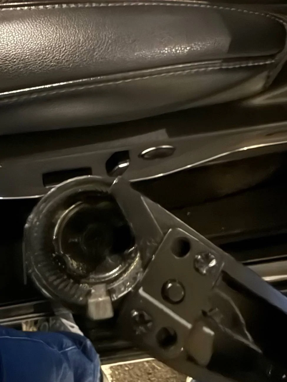

So of course in the middle of downpours my wiper arm broke off. When I put it back on it just comes off again. I did find a metal tab in the area near where it attaches to the motor that looks like it lines up with a notch on both the arm and silver circle on the motor. I tried to line it up and put it back together but it just came apart the same way. The teeth inside the arm seem to be worn down so probably at least part of my issue. It’s raining too hard to pull off the other to compare and I don’t want to end up without either. Anyone have any suggestions? Have some terrible pictures but it’s the best I could get. In the top picture I slid the piece into the arm and it is a little distorted by the light/ phone camera. It does not stick outside the circle at the end of the arm.
That metal piece is just an alignment key used during assembly to make sure the wiper doesn’t travel too far and hit the a-pillar. They aren’t necessary for the wiper to function properly and they frequently just fall out if you lift the wiper arm too high. https://www.f150forum.com/f118/whats-small-metal-puck-fell-out-windshield-wiper-base-459497/
If you can get the wiper arm back on, it should work fine without the key. You just might have to take it off and put it back on a couple of times to get the travel right.
EDIT: Correction. There is a difference of opinion as to whether they are needed long term. The current thinking is that they aren’t necessary. https://www.f150forum.com/f118/metal-piece-wiper-528652/. Regardless, in the short term, the wiper should be fine until you decide what you want to do. The keys fell out on my first set and they worked fine. But the arms were eventually replaced under a recall and the new keys appear to be better fixed in place.

For now I made it home after about 100 attempts to get it on and to stay. New arm ordered off Amazon for now. Will try this if it doesn’t work or at least use it to get me by until they can take it in

unfortunately, I couldn’t get it back on and have it stay. I think the teeth are too worn down at this point.

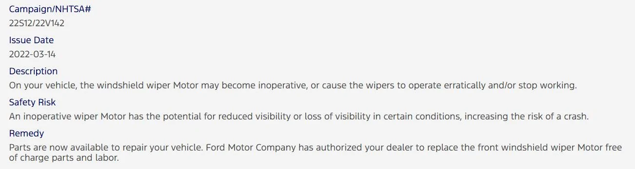

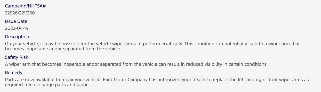

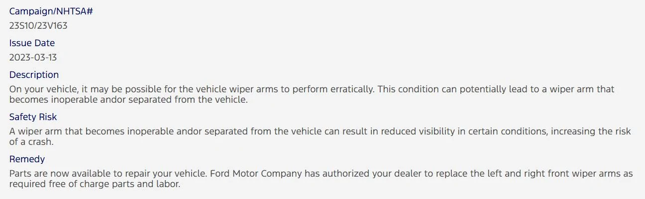

Update: Actually, there was/were/are several F150 wiper ARM (and motor) recalls for my 2021.
Ford F-150 Wiper arm broken.  looking for suggestions 1733968367239-jr
Ford F-150 Wiper arm broken.  looking for suggestions 1733968443461-ya
Wiper motor:
Ford F-150 Wiper arm broken.  looking for suggestions 1733968473907-hl
Ford F-150 Wiper arm broken.  looking for suggestions 1733968496117-mo
