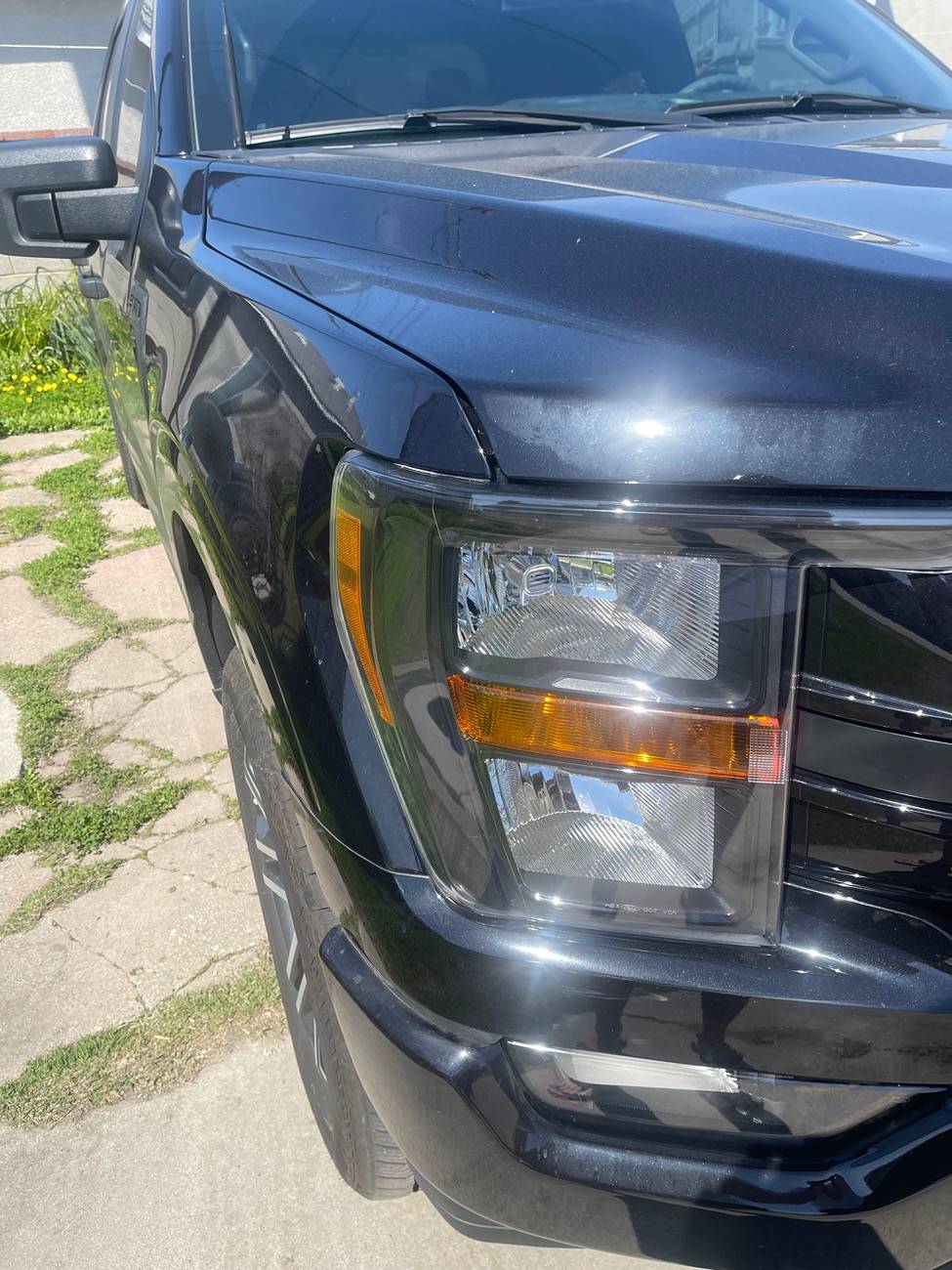

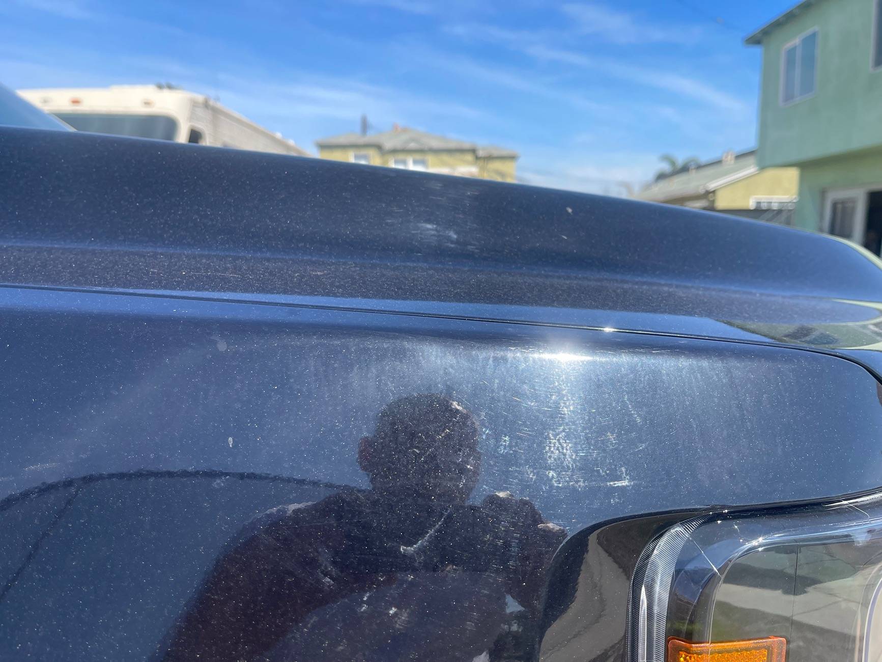

Hello,,
I am having trouble getting these stains off the panels, I washed it, clayed, and applied waxed. Any recommendations?
Thanks in advance.
Ford F-150 Which chemical to clean the exterior? IMG_6968
Ford F-150 Which chemical to clean the exterior? IMG_6967

What is causing the marks. I see some hard water spots but I am not sure if that's what you're referring to.
If waterspots, you'll want to look for a water spot (mineral) remover first. If they've been there awhile, they are likely etched into the clear coat. In that case, water spot remover followed by polishing them out with a polish or light compound that has some abrasives.

I will properly treat it. You will need to remove the wax. Wash the area with Dawn dishwashing soap. Spray the stained area with a 50-50 mixture of water, preferably either distilled water or soft water. Let that sit for about a minute wipe off with a terry cloth or microfiber.

I'm a bit surprised by all the comments that say just go straight to polishing. If they are etched, they will reappear after polishing.
If you don't chemically remove the minerals that caused the water spots, a machine polish drives them into the paint, looks great for about 2 weeks and then they will reappear.
