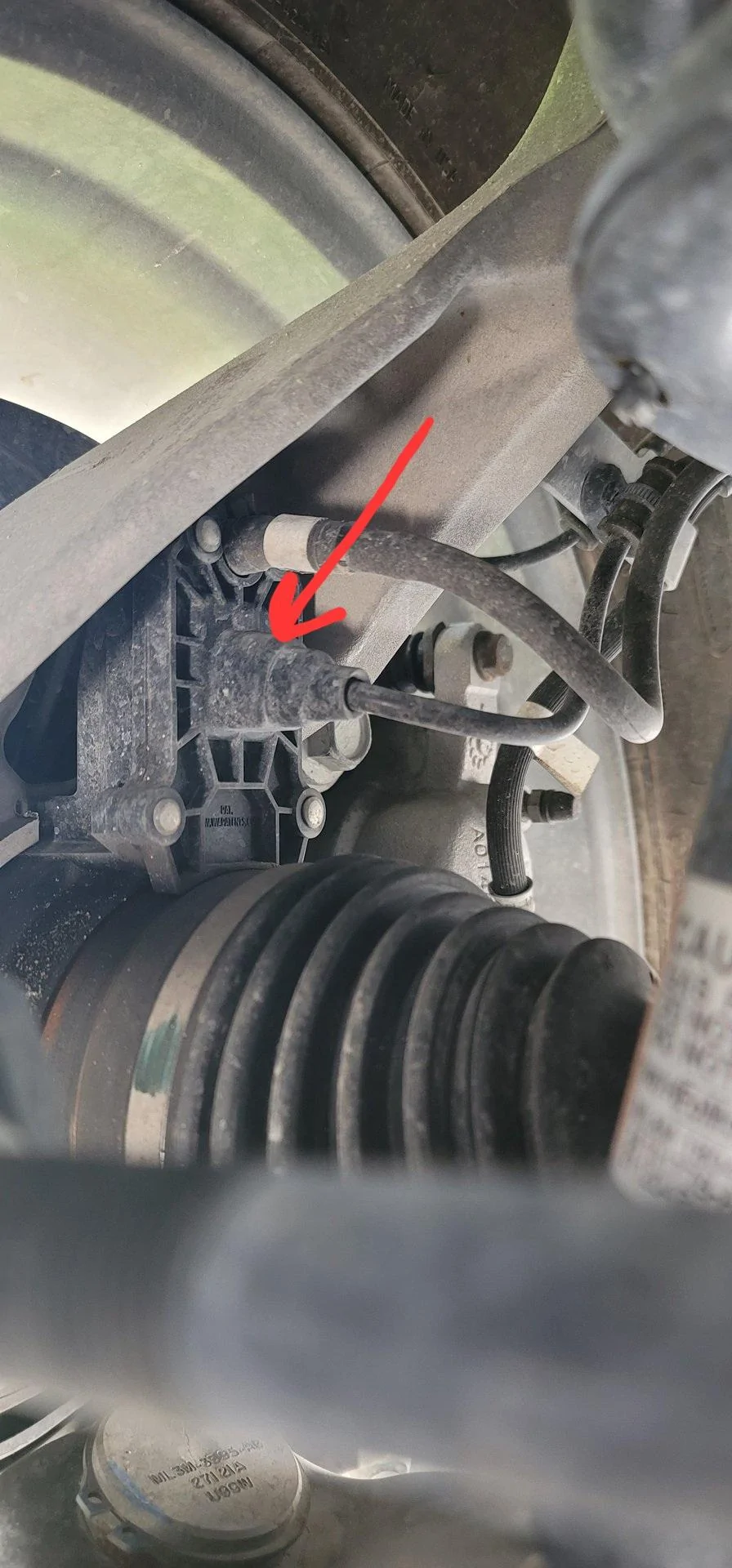

I got a buddy who just got his 2022 Tremor and he still has an IWE, although it is really the new E-IWE introduced in the 2021 F150.
In fact, my 2021 Powerboost Platinum had the E-IWE. Finally Ford dropped the vacuum actuated IWE! (notice the electric harness to a stepper motor)
Ford F-150 Where to see Battery Charge Level indicator? download (5)

This is super interesting - knew about the E-IWE on my 21 Powerboost. I have to wonder if there was a reason for the change other than parts availability.
Agreed that it is probably a driver of the reduction in EPA mileage, but I don’t find this talked about anywhere from my initial googling. Could have decently big implications for people doing the taller level kits (3-3.5 inch ones) as the CVs will burn through boots faster if the boot is rubbing on itself since they will always be spinning now.
Not surprised though - pretty sure most other 4x4s have not had IWE for a while now. They just are always locked in
