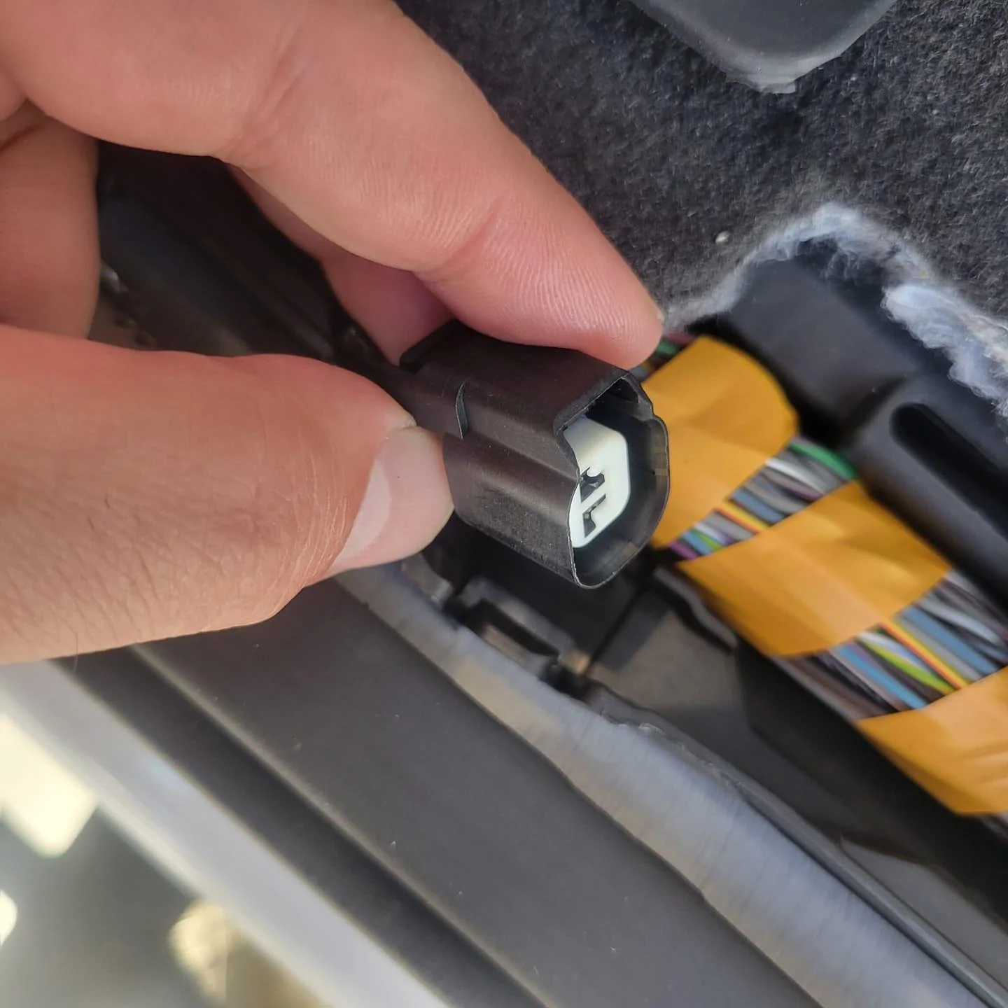

As for wiring for the XLT, I believe this will be very similar to my Lightning in that the wires won't be on your existing harness. So I'm afraid if you want to do it right there's a lot of wiring and yes, some splicing. You'll have to wire the sensor and power cables from each side to locations on 2 of the connectors under the driver's seat. Then on the male end of those connectors, make the new connections to various pins on the 4 or 5 DSM connectors. They are a bit random. Alternatively you could go direct from the PRBs to the DSM connectors, but if the seat ever needs to be removed then it'll be a pain and the service people might be confused and/or break something. I ended up removing my whole console to get the wires from the passenger PRB to the drivers seat connector. There's probably easier but less direct routes, like through the engine bay! You'll also splice the green wires from each PRB in to the existing green wire in the drivers seat connector as that's the shared network communication wire. You'll want to subscribe to the official Ford wiring website for a few days I'm sure.

There is no pigtail. The wires come from multiple places direct to the DSM. See my wiring diagram in earlier post on this thread.
