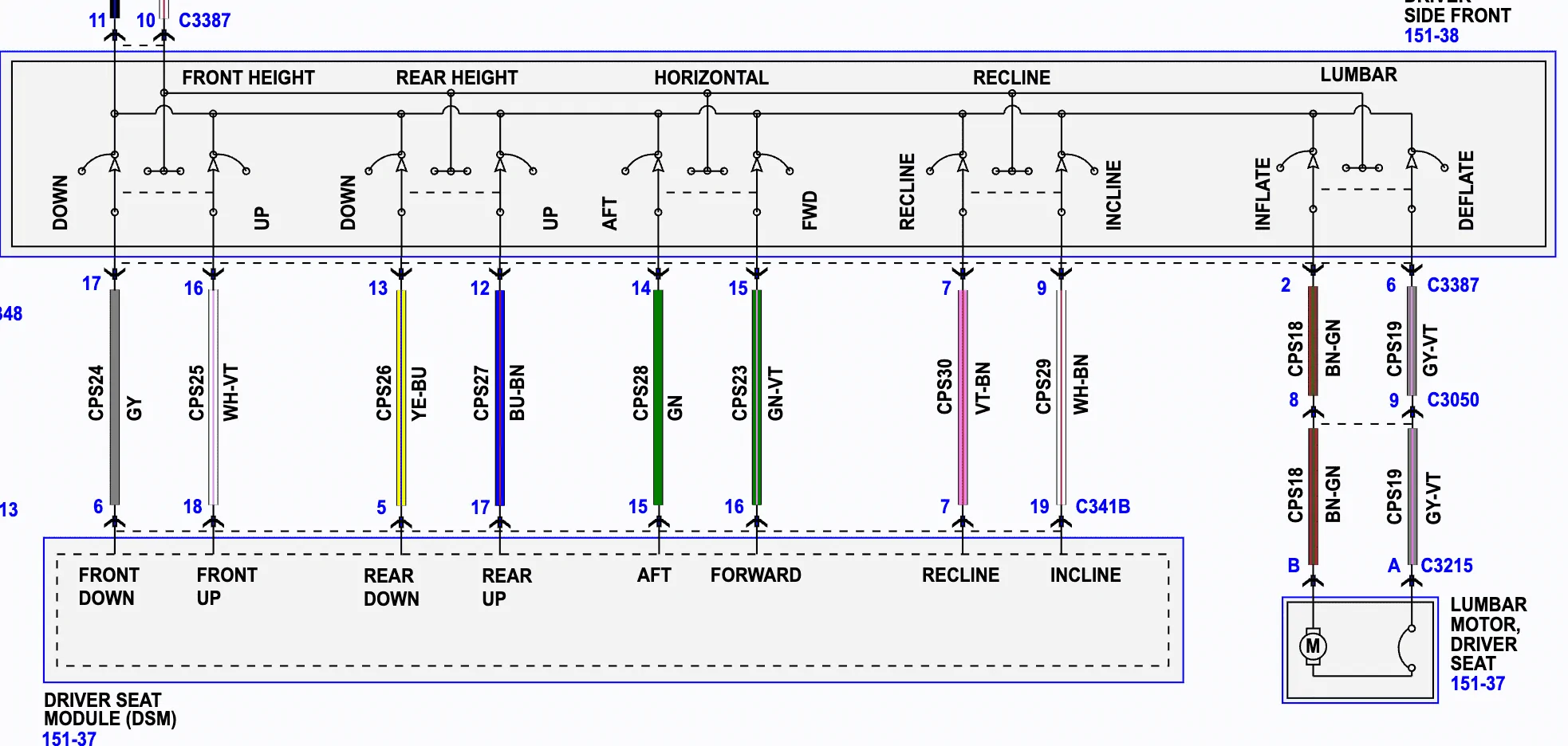

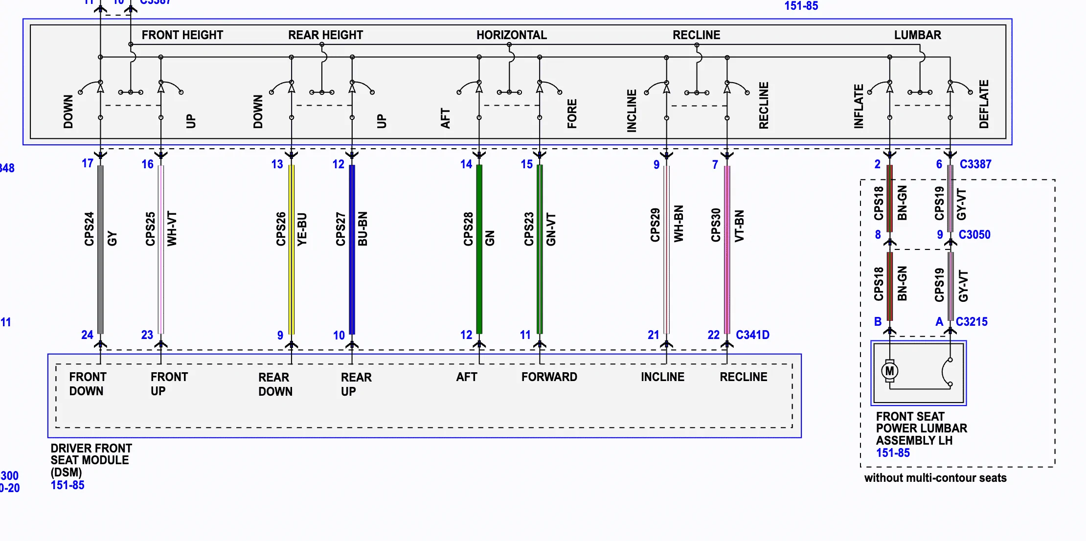

Compare these wiring diagrams for just the regular memory power seat functions of the DSM:
14th gen
13th gen
Notice the different connector names and pin numbers. And yes the connectors have different shapes.

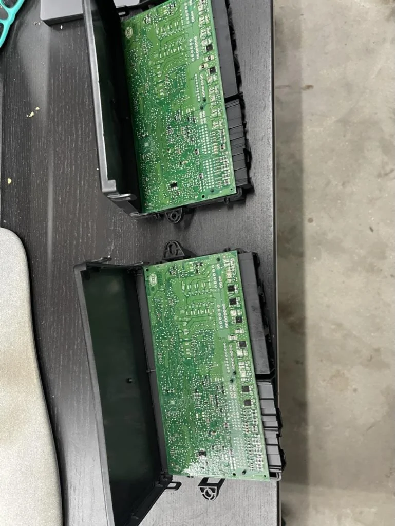

Here's 2 side by side, one that supports PRB and one that does not

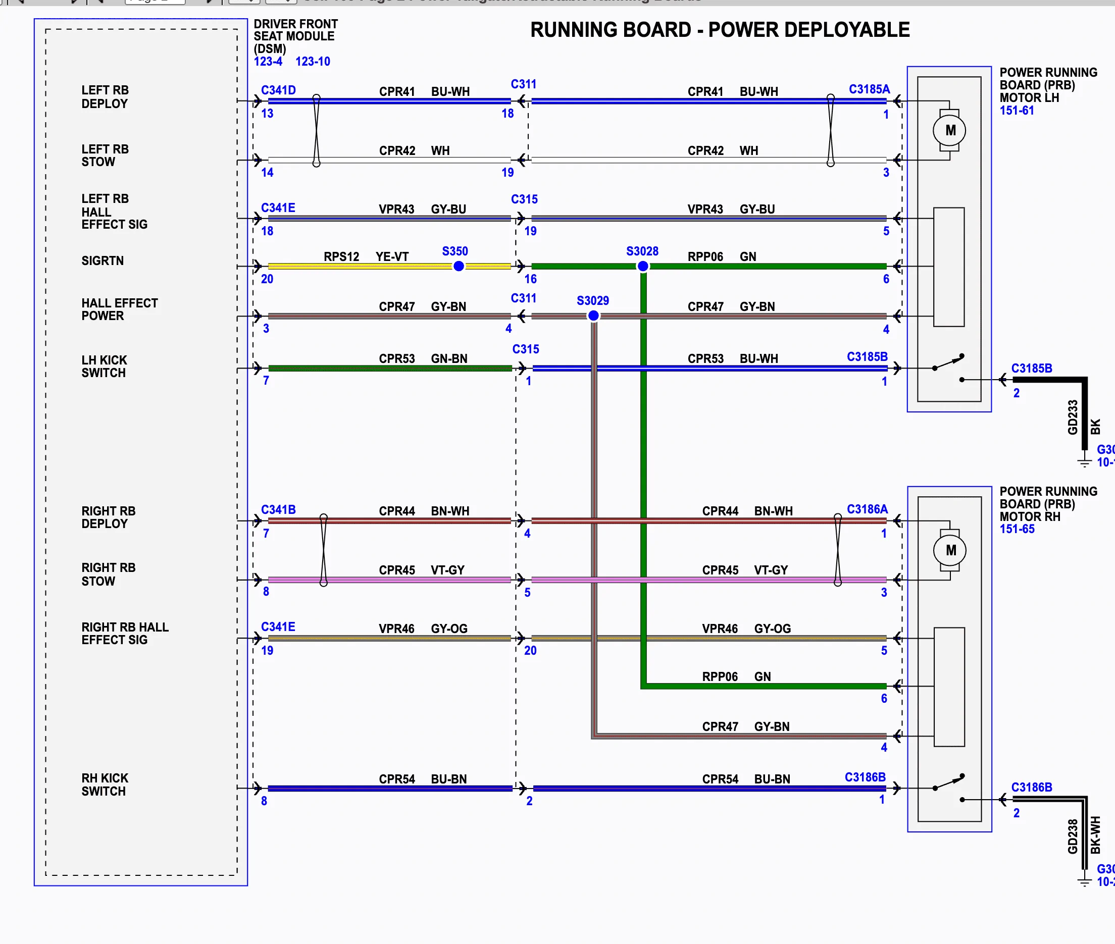

And here's the wiring diagram for the PRB

The entire PRB circuit is identical 13 and 14 gen only different controller. They consolidated it into the DSM rather than the module on the back of the console or wall depending on if you have a TCU or not.
