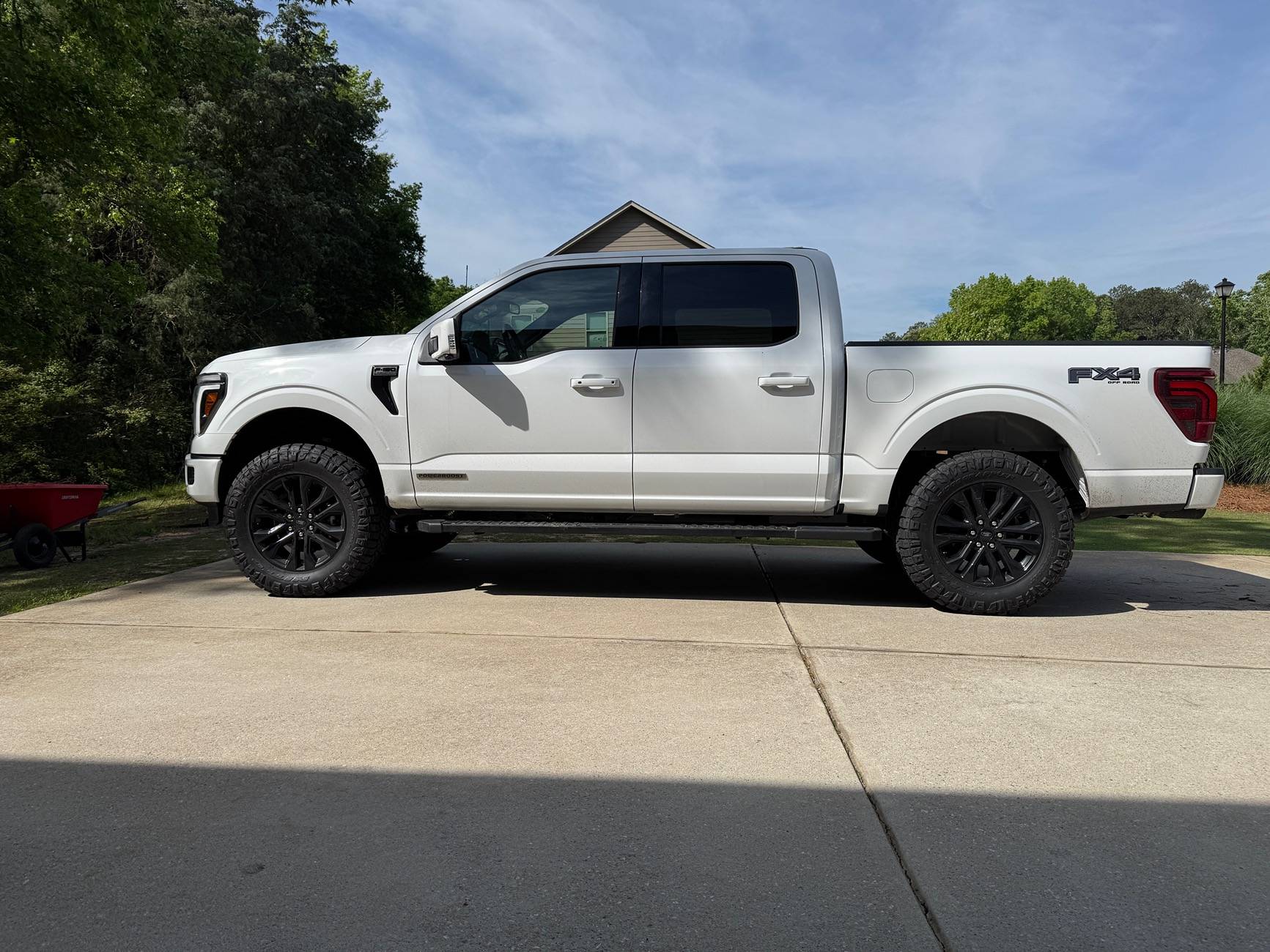

2.5” level with 35-11.50r20 Ridge Grapplers on stock rims. Zero rub, zero trimming. I could have easily gone with 12.50” wide Grapplers. With the 11.50 I have ample room. I could put at least 1” spacers and still have zero rub.
Looks sharp!!
