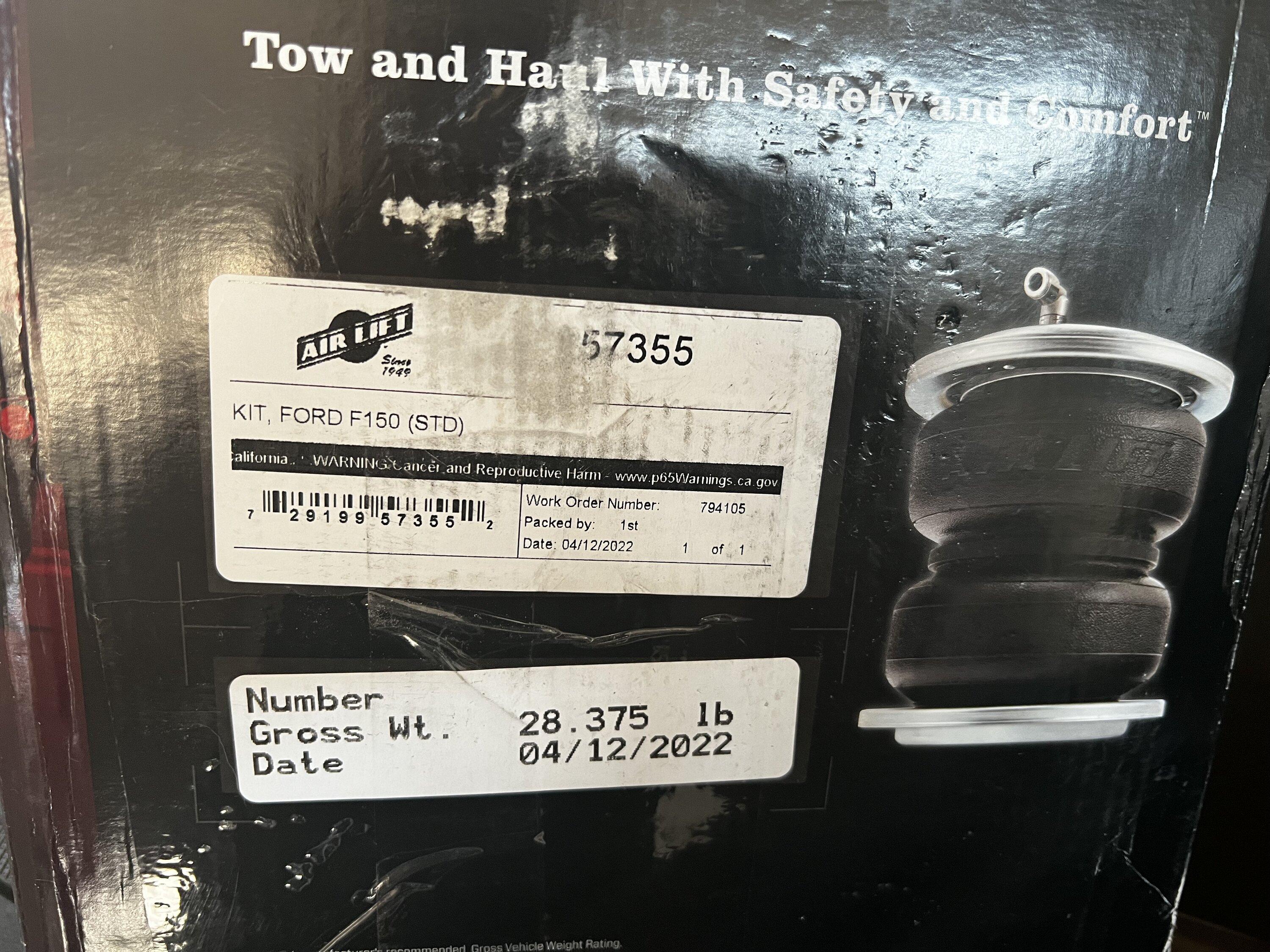

Yes, I did get them with the internal jounce bumpers.
That is your problem in my opinion.
I have AirLift 5k’s without jounce bumpers and my ride is smooth as silk at all times. I usually keep 5-10 PSI in mine to give the rear a little lift just for looks.

Ford F-150 What Rear Shock Upgrade Will Fix My Bumpy Ride? IMG_6563
Part number of mine for reference.
