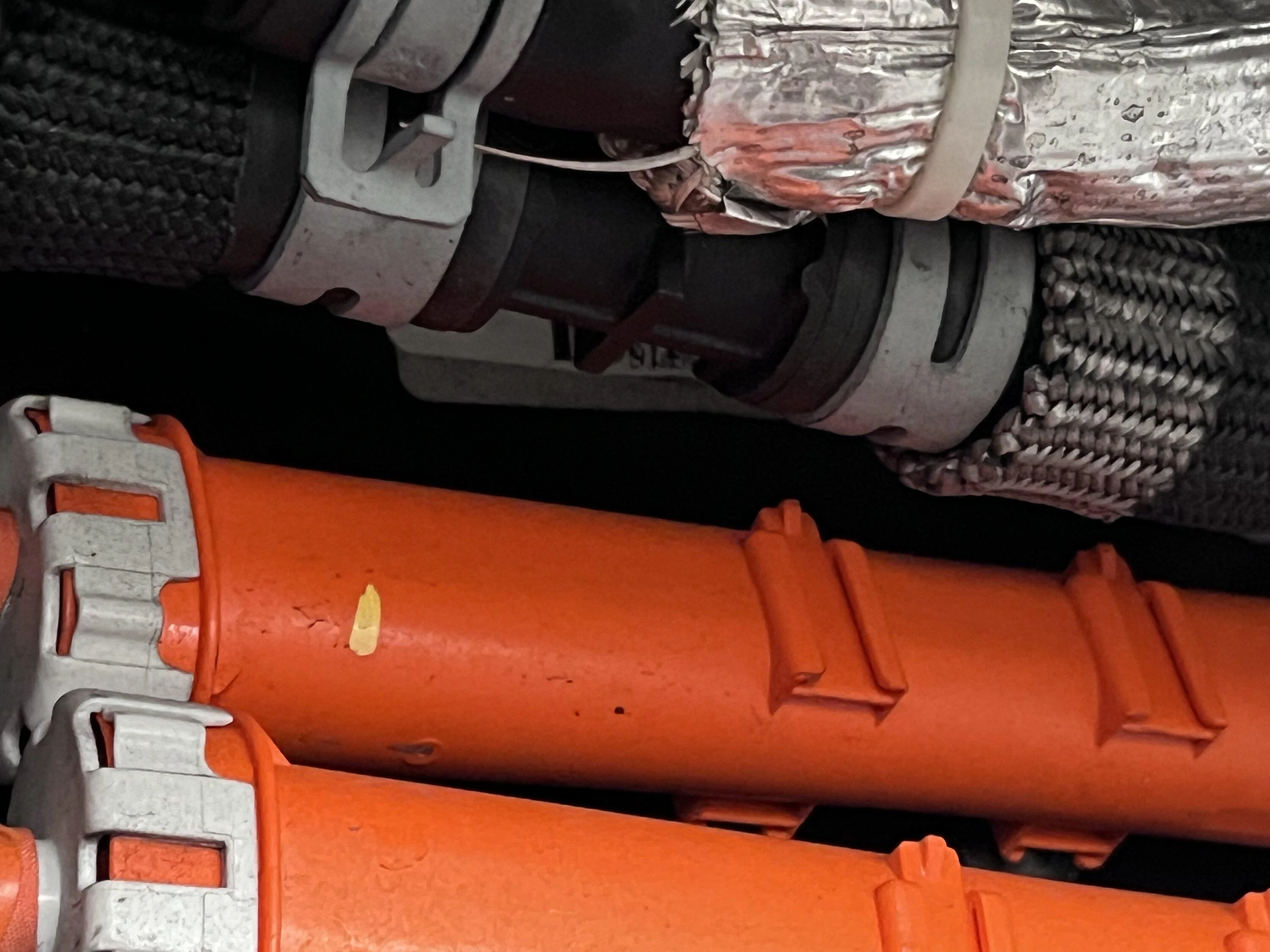

The plug is connected to the generator wiring harness but what do you plug into it ??? Is there some accessory that plugs into it????
Well, it’s wrapped in orange which denotes high voltage. High voltage can be AC or DC. What vehicle do you have? Which side and how far back is the connector? What PPoB if any do you have? By generator do you mean the PowerBoost traction motor, the high voltage DC-DC converter, or the alternator for non PowerBoost models?

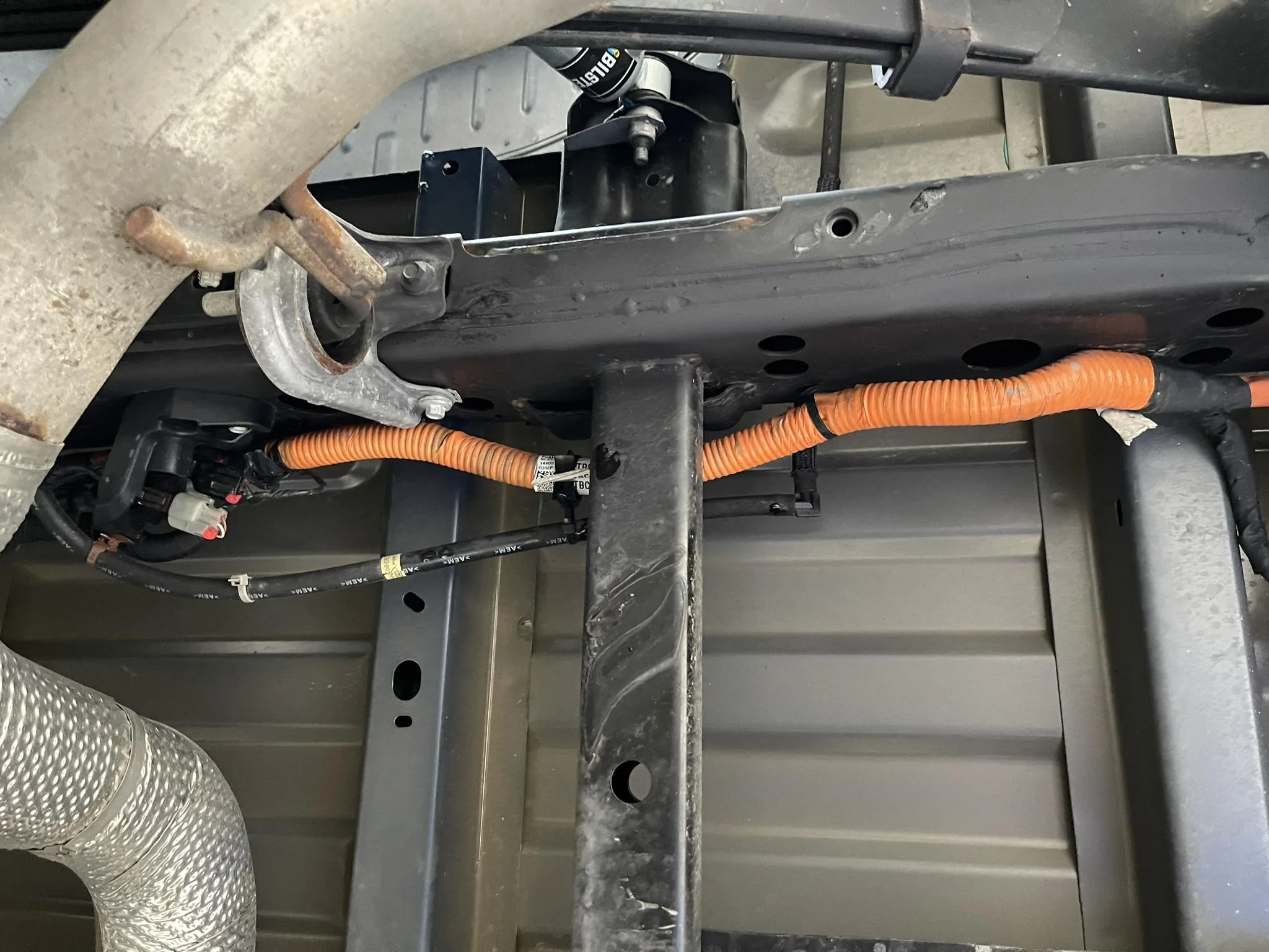

My harness is nice and tidy. In fact, the truck looks really well built from underneath.
Ford F-150 What is this plug used for IMG_2258
Ford F-150 What is this plug used for IMG_2263

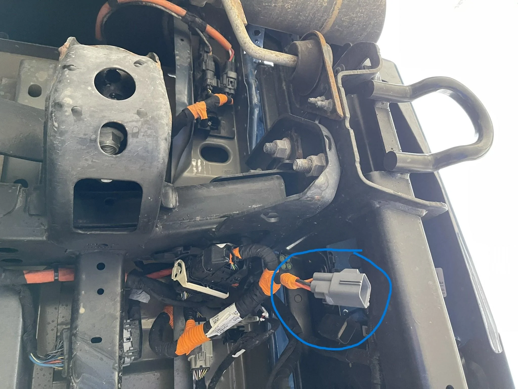

Ford F-150 What is this plug used for IMG_2259

I got a tremor ecoboost 3.5 with PRO POWER ONBOARD - 2KW the line is connect from the outlet to harness and then to the plug which is close to the 7way plug all of which is on the drivers side
If you have the Ecoboost 3.5, then your 2KW inverter only works when your engine is running. You dont have the PowerBoost engine which would require the Pedestrian Alert System.
