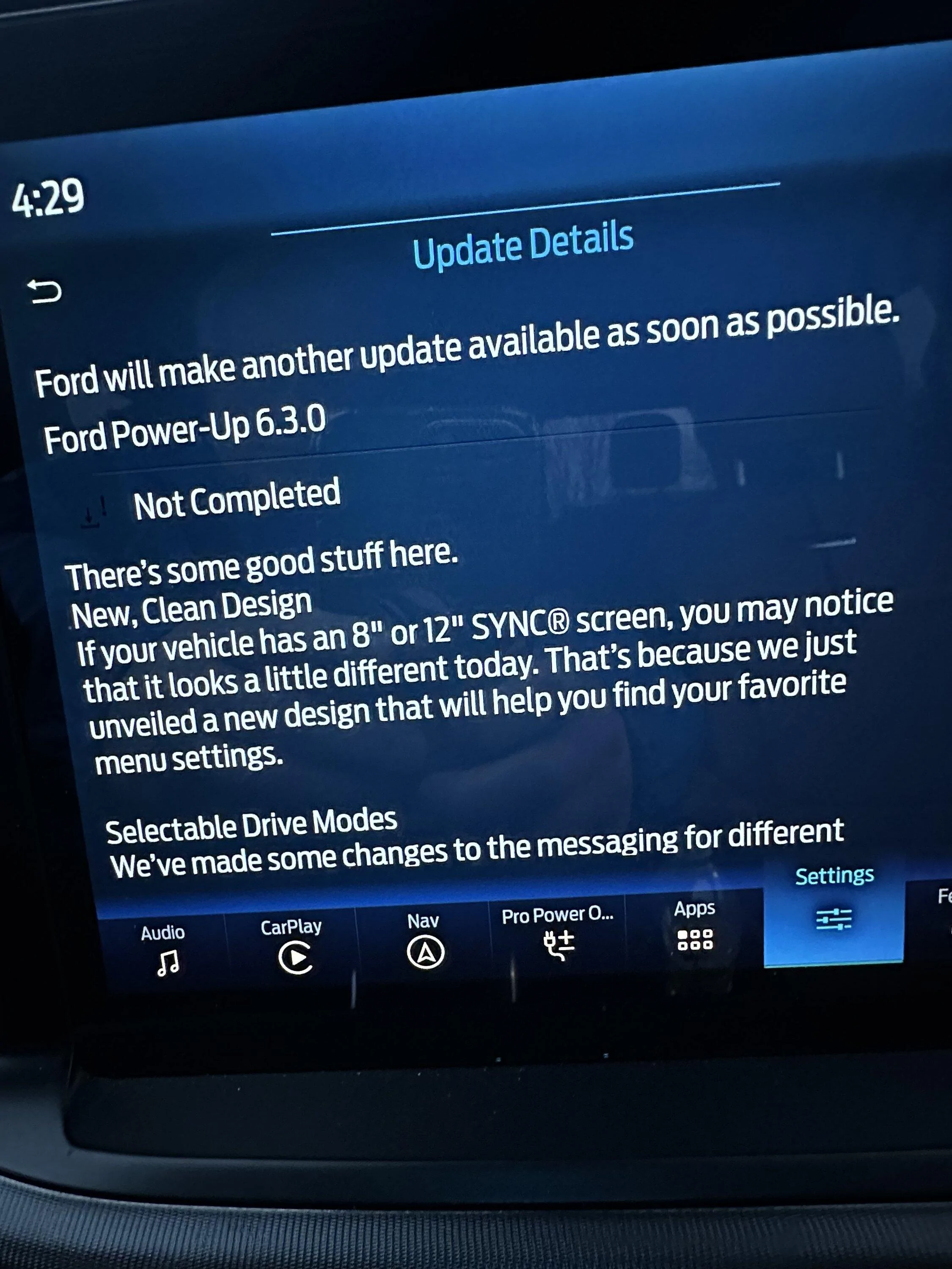

I have gotten this message for several days now. Does this mean that the install and/or the download has failed? Thanks Fredm2002

OTA failed to install. Error code is below. Something happened with one of the files it downloaded for the update. There is nothing you did wrong nor there is anything you could have done differently. You just gotta wait for it to be resent to you.
Over The Air Manager (OTAM) Update Status Logx
Deployment StatusVehicle StatusVehicle Reporting Date/TimeServer Status Received Date/TimeAdditional Parameters
Application Lifecycle Manager Install FailureSIM_E1001December 01, 2023 2:48 PMDecember 01, 2023 3:48 PM"errorCode":"DiffSpaceCheckFailed(83)""errorCategory":"ERROR_CATEGORY_ALM(3)""ecuId":"2000""fpn":"PU5T-14H212-AFF"
