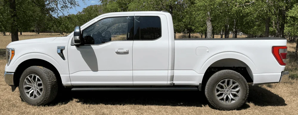

None of the available factory-optional running boards for my Lariat 500A 'rang my bell' but it only took me a few days to realize that something was needed lest I wear out my upholstery dragging my bony old ass across the corner of my driver's seat.
So the search was on for something wheel-to-wheel in black with simple clean lines. I took a chance on these and I'm happy, they're hell-for-stout heavy extruded AL with the solid AL end caps welded on giving a totally one-piece appearance (the traction grooves in the top are part of the extrusion, not a separate rubber piece).
Ford F-150 What did you do TO your F-150 today? 🙋🏻‍♂️ BOARDS 02
Ford F-150 What did you do TO your F-150 today? 🙋🏻‍♂️ BOARDS 01
Note that the extension under the bed has a 130kg / 300lb weight limit warning, not a problem for me at 175#. The mounts use the OE running board mounting studs and a far-rear of the cab mount using OE holes and supplied "T" bolts. All of the hardware is stout and good quality IMO, they include the proper plastic washers for AL/steel isolation, installation was easy, the result is very solid. This is the 5" wide version, delivered price with UPS ground shipping and TX sales tax was $514.
Here's the product page (note the installation instructions can be downloaded), if you like the clean and simple functional look I recommend them.
PS - yep, that "4x4" decal on the box-side mysteriously fell-off when my truck got to Texas :oops: ;)
