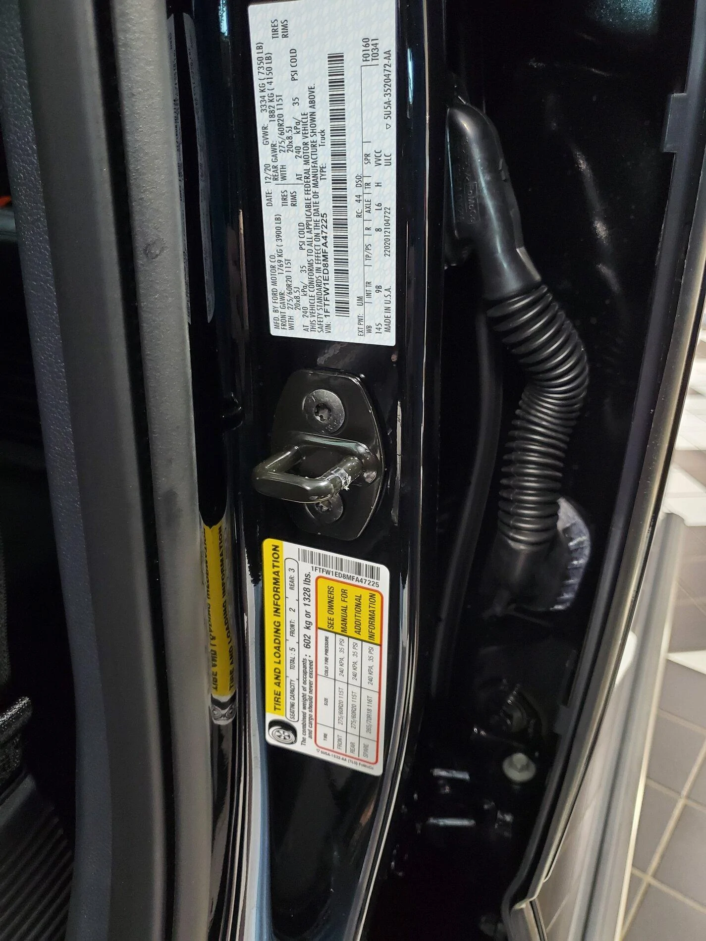

Here is a Plat at my dealer. I am avoiding towing packages and will upgrade sway bar if I want to tow anything heavier than 7k as that is the only improvement for $1k.
Ordering a 701A 4x4 PB shortbed myself.
Ford F-150 What are the heavier options to avoid to increase payload? Screenshot_20210107-171706_Driv
Ford F-150 What are the heavier options to avoid to increase payload? 20210107_122434

My non Fx4 has skid plates on the gas tank. 28bs for the FX4 seems like a lot for 2 Aluminium skid plates.
Ford F-150 What are the heavier options to avoid to increase payload? 20210112_155904[1]
Ford F-150 What are the heavier options to avoid to increase payload? 20210112_155908[1]
