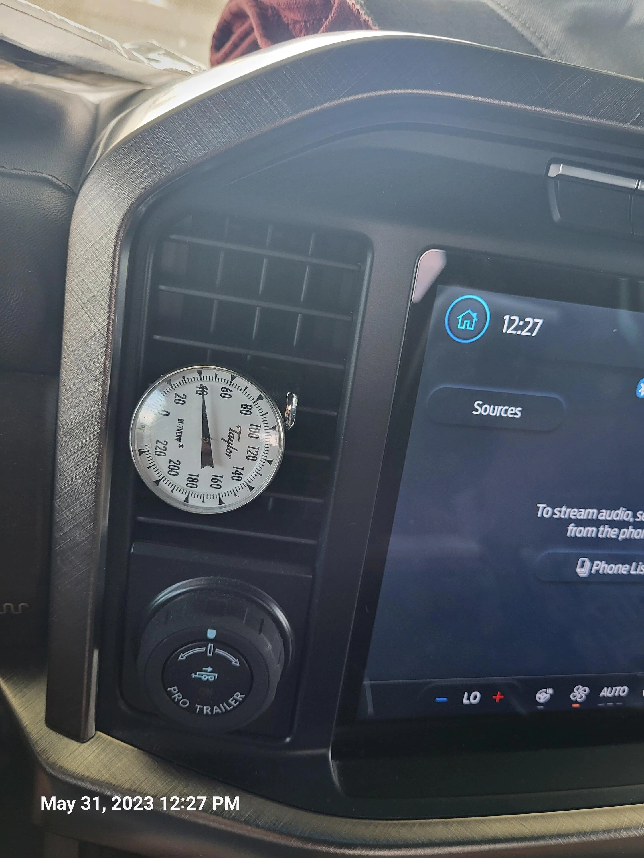

i did a static test a few weeks back
87 oat so i knew it could at least pull 40F in center vents,
my thinking was it froze the evap when i slowed to a stop it had built if of cold and couldn't stay above freezing, it was just weird that it chose that moment to defrost
40 for me center vent is ok, but i can pull 37 in the edge and the bus
i would like to pull dash aprat to see how the vents are run and or wrap them.
imo ac in this truck is not ideal
