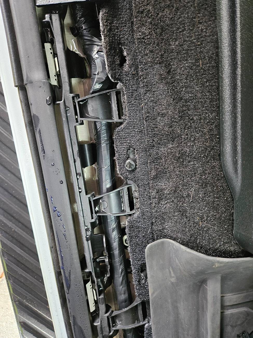

@JohnTrigger thanks for the info! So i cleaned out the drainage holes on the firewall and then went to see about the cabin air filter. I found water pooled up on the passenger side floorboard under the floor mat and it filled up the valley on the rocker panel
I sucked the water up best I could, now I think it's time to see what the local Ford service department will tell me
This is ridiculous!

Did any water come gushing out of the drainage hole once you cleared it on the side that is pictured in that first link, post 23? If so that would have backed up and previously done the other water damage on the floor valleys and up the rocker panel.
Regardless, dry out the fuse area and the BCM module under the carpet there.. I’d use fans and compressed air etc to get that as dry as possible before any longer term damage is done.

No water came out which I figured wasn't good

Well, you’ve exhausted what I know of as the usual suspects that cause water in the vehicle on passenger side. You could try hosing it down and looking for leaks with it parked normally and at various uphill and down hill angles. Or take it to dealer but I’d be surprised if they find it right away either. Leak checking seems like chasing ghosts.

@JohnTrigger I appreciate all of your help with this. I checked that one as well, it wasn't clogged. It was actually very clean. Also, checked the floorboard and rocker panel on the DS and it was all dry. At this point, I'm driving around with a USB powered fan to dry the floor and a bucket of Damprid to pull any moisture out of the air. I have a service appointment Wednesday.
