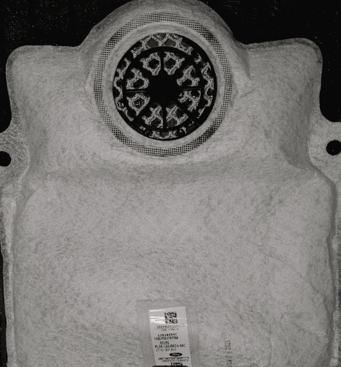

Here's the back of the vent'd seat. Fan sucks from this connection point. Inside the white bladder thing is a series of mesh plastic springy stuff that prevents the 'bag' collapsing as negative pressure is applied, it's open to....
-backside of cushion foam-

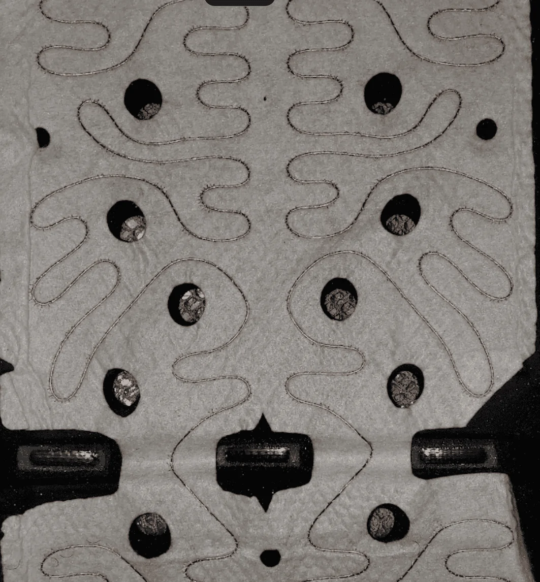

These series of holes through the cushion which is the air passages. You can see the springy mesh through the holes...
Front side of cushion foam, the white is the fabric in which the seat heaters are sewn to and stuck to the foam via adhesives along the sides only.

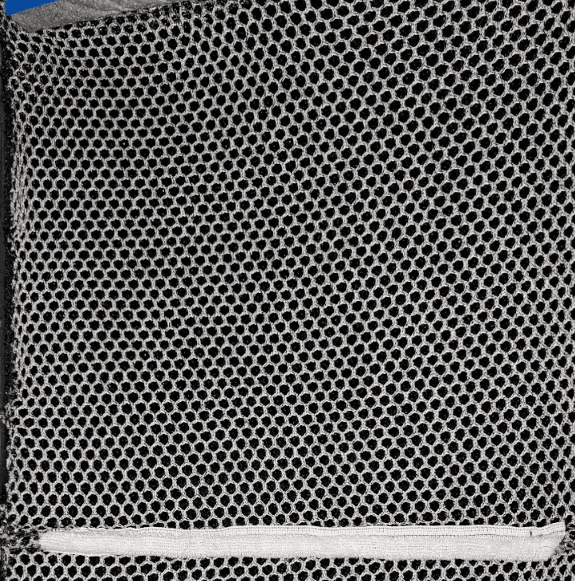

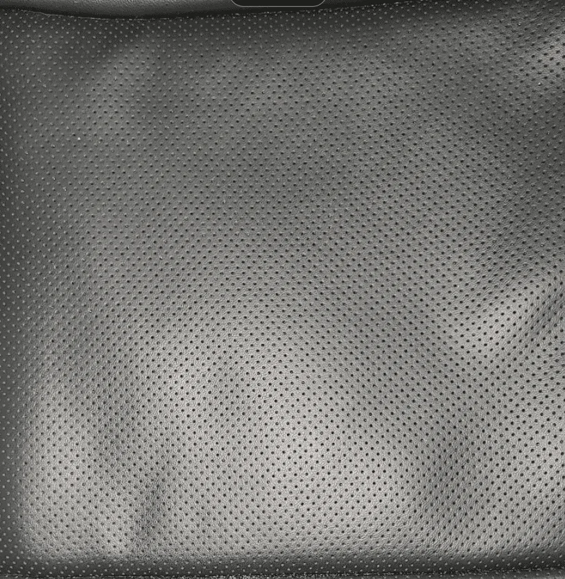

This is the reverse side of the seat cover that makes contact with the above surface. It's just under 3/4" thick and contains 2 different types of springy mesh that opens to the little holes on the cover that you can see...

If the truck is lumbar only, that can push against the top image white bag causing the lower section of the seat back to have weaker flow. That'd be my guess as to a potential issue -- the seat lumbar. The upper part of the seat is where the fan is located so for best results, best to sit back into the seat itself.

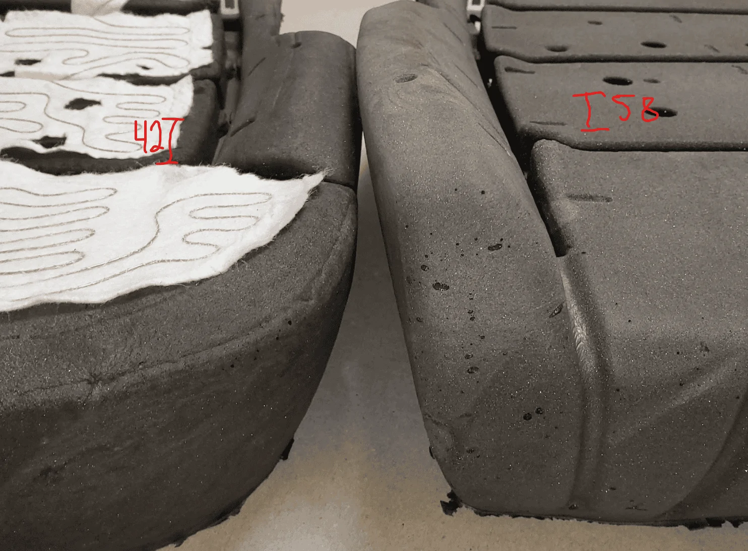

I was going through the cushions and found the raptor's 'foam' seat bottom measures in about 58mm thick whereas the platinum / KR foam only comes in around 42mm. This is the bottom of the seat, not the side bolsters. The rears appear to be about the same thickness (where the back rests, though the side bolsters are larger in the R for slightly sporty / snug fit) Foam density feels identical.
Ford F-150 Ventilated Seats 1686031681250
The bottom side bolsters on raptor measure in at 150mm vs the plat / KR only 114mm thick
