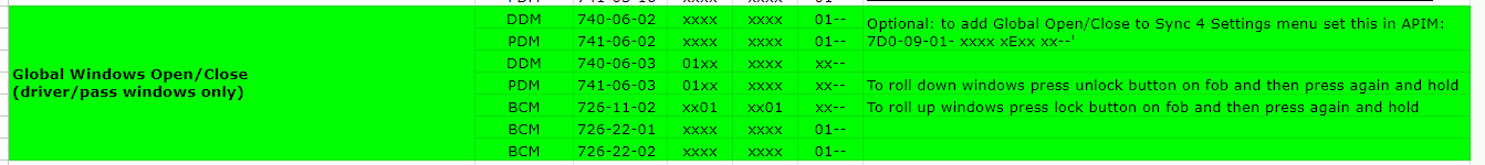

It is available to change in forscan. It's called global windows. Ignore the green highlight, it was on my list of mods to make.
I did and love this but on my 2022 Lariat SuperCab it only works on the front door windows.
Interesting that to unlock and open windows it requires the 'double tap' as described in the spreadsheet, but a single push-and-hold will both lock the doors and close the windows (avoiding the confirming horn beep).
Yep; I added it last weekend to my XLT via this forscan change. Nice feature!
I just did this on my 22 lariat. It didn’t work! I double checked my values. They all looked good. Sad.
SilverPigeon
Apr 27, 2022
1,410
1,511
Australia
Couple of things:
1. You can try rebooting each changed module in Service Procedures
2. When you hit "unlock", wait a second before holding "unlock" down. It needs a good 5 seconds hold down sometimes. It usually doesn't recognise a quick double-tap+hold.

Couple of things:
Thank you! I will try and reboot those 3 modules tomorrow and then try the open/close sequence as you stated!

18-20s would roll all 4 windows down. 21 and up will only roll the front driver and passenger windows.

What do the “—“ mean in the FORScan spreadsheet? I know X means ignore, and a value means change. What’s a dash?
SilverPigeon
Apr 27, 2022
1,410
1,511
Australia
If you enable “global open” and “global close” in the natural language configuration of BCM, do you need to manually touch the DDM and PCM modules still?
Similarly if you go the optional route of enabling the global open/close to Sync settings via APIM, do you not have to do any of the other settings?
They all need to be done except for the option to have the setting in your SYNC settings. If the setting is available in all of the relevant modules (BCM, DDM, PDM and APIM) in "easy mode", it should work from changing all of them. This is because when you use either easy or advanced editing, you are going into each module separately. It won't auto-magically change all the others by doing only one of them.
