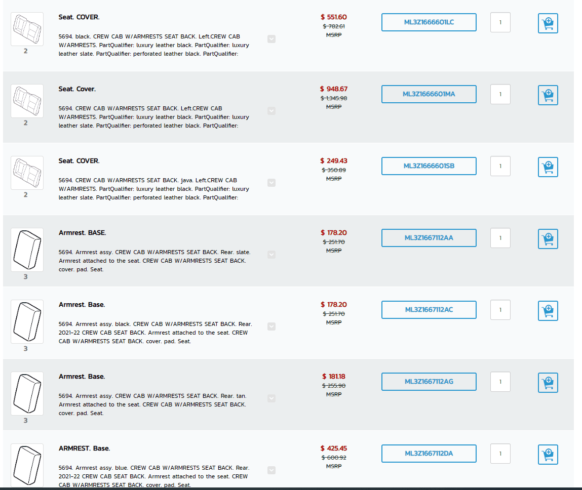

It's looking like best case scenario you're gonna spend $400 assuming you have the least expensive color combo. And that's just for the seat pad and arm rest base. I'm certain there are more parts than just those 2 required.
As mentioned a few times on here, AND I mentioned it to you on the other forum, most likely you'll be better off buying this from a scrap yard
Dont be made I went to another forum for other opinions David... LOL. Yes at this point it looks like trying to find a junked Lariat is my best option, although unlikely at this point.
