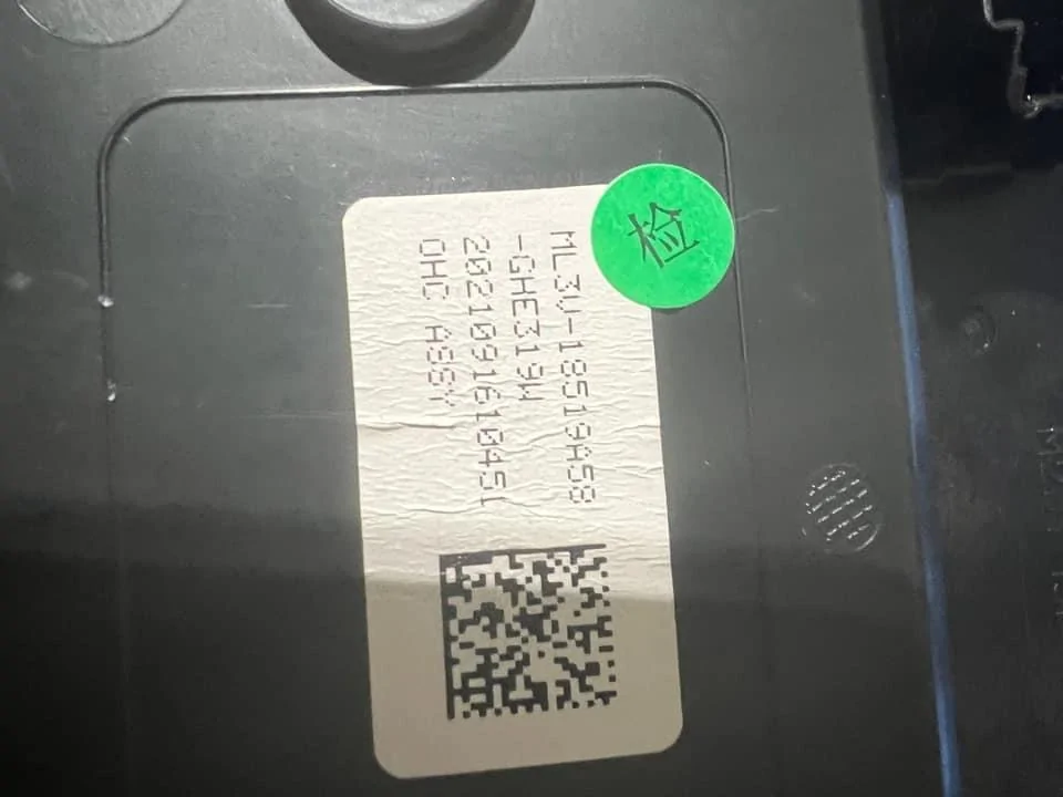

I’m doubting the wires will be there and just needs the switches installed. But that doesn’t mean it can’t be done. A gentleman on Facebook just installed his today and I saw his post. Here is the part he installed with the sunroof and power rear slider console.
Ford F-150 Upfitter Switch installation 5414E65D-7BFF-463E-A082-4DF925AE8783
Ford F-150 Upfitter Switch installation 8A1AFA3F-04DE-46BD-9028-49BD37942E56

Has anyone done this besides the one guy on FB? I'm looking for the actual part numbers. The number above does not come up on Tasca.
