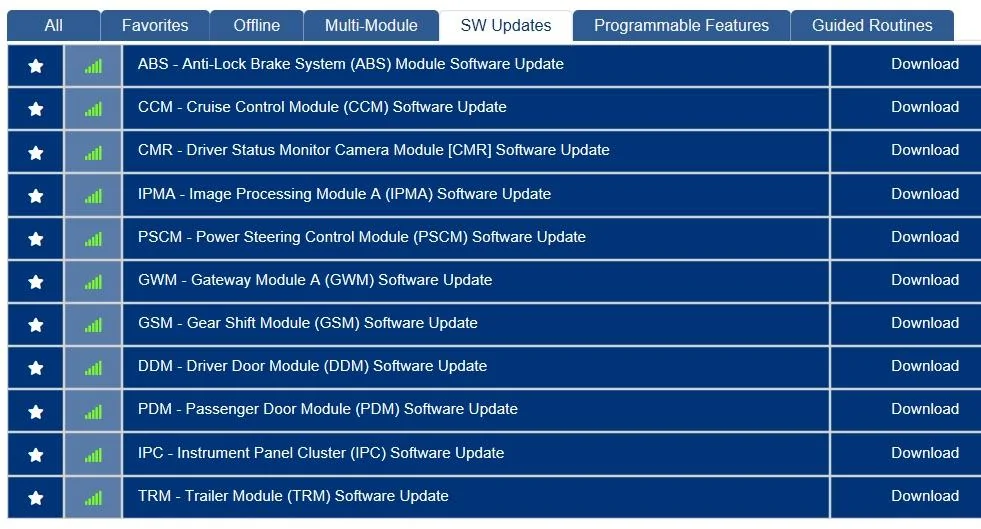

You will need to do all of them.
GDN
Greg
Feb 15, 2022
359
195
Dallas, TX
2022 Lightning -Lariat ER; Model Y Performance
IT
I don't even have a truck yet, but have been following these threads. I would think anyone that is supposed to have BC by now or is stuck in the updating hell of 1.7.1, I believe it is, could use this bulletin to push your dealer to get the updates done.
This text is from the bulletin and it notes that there may be multiple modules. If it were only the map issue they would address just that module.
" 2021-2022 F-150/Mach-E Check For Available Software Updates For GWM And Any Additional Modules Required By The Software Updates Follow The Service Procedure Steps To Correct The Condition On Vehicles (Do Not Use With Any Other Labor Operations) "
I would be using this to push getting all modules updated for BC to activate and work.
