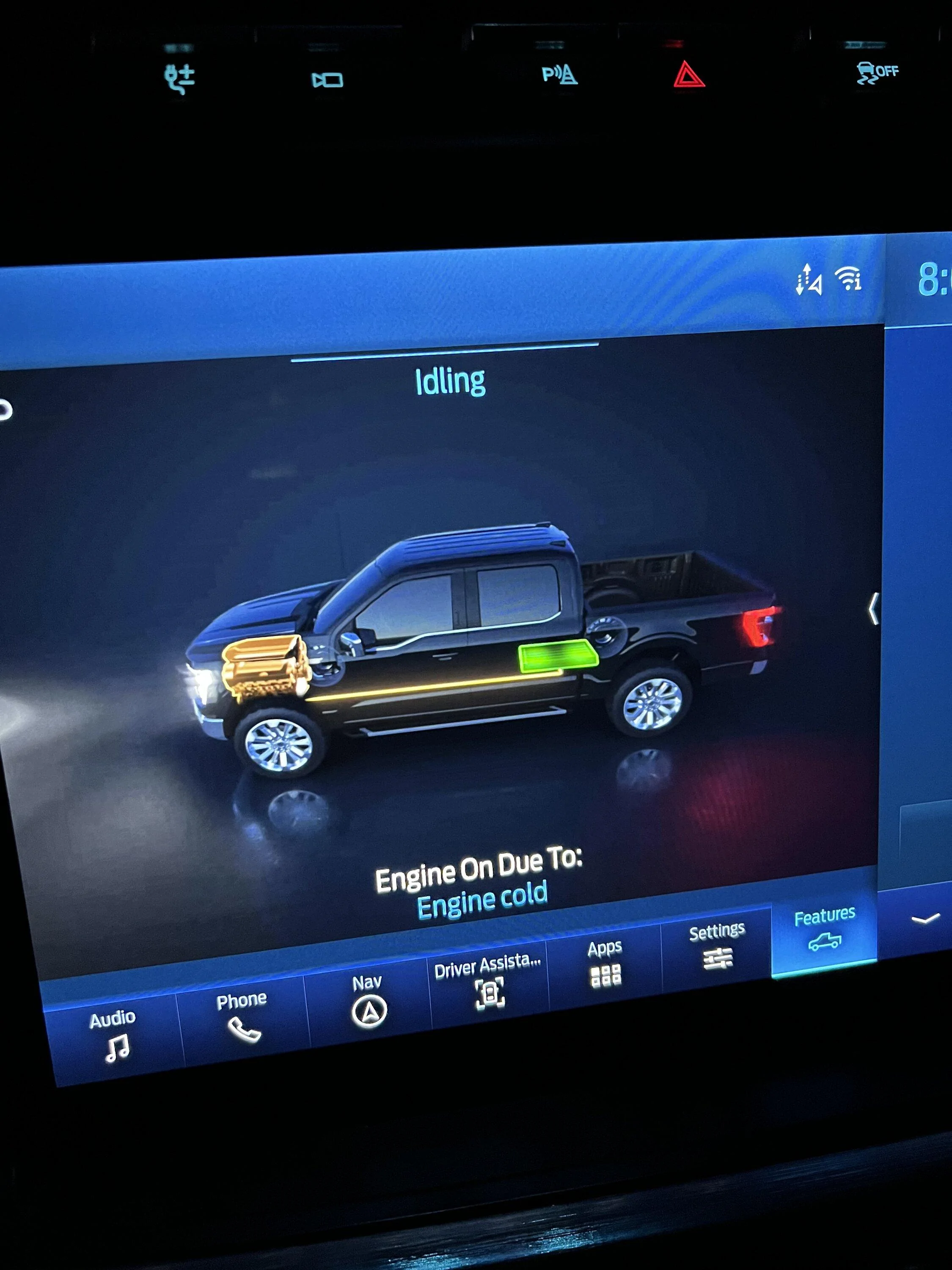

Joined this forum so I could specifically reply to this thread. I have a 2021 Powerboost and experienced the same issue. Was powering my travel trailer and it was a warm night. Truck said engine running due to engine being cold but that was not accurate. Turned off the truck, let sit for a while and turned it back on. Everything worked fine overnight. Next evening it happened again. Something is definitely glitching, but there are no errors being sent to my Ford pass app. Who knows…..
Kinda funny observation: When my truck is at low idle, the display shows the reason for the engine running is because the battery is charging however, when it displays that, the yellow line in the truck icon that is shown on your truck is not there on mine. The engine and the battery icon show up, but it is not connected by the yellow charging line…Strange!

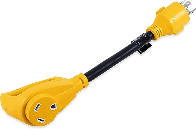

Haven't made the adaptor to use the 30 amp yet but had the gear to plug it in to one of the 20s. I had the trucks AC on. It kept running for some several minutes and had me wondering. Turned off the truck's AC and as soon as I did, the ICE shut off and the batt took over as it should.

Made the cord to run the camper off the 30 amp last eve.

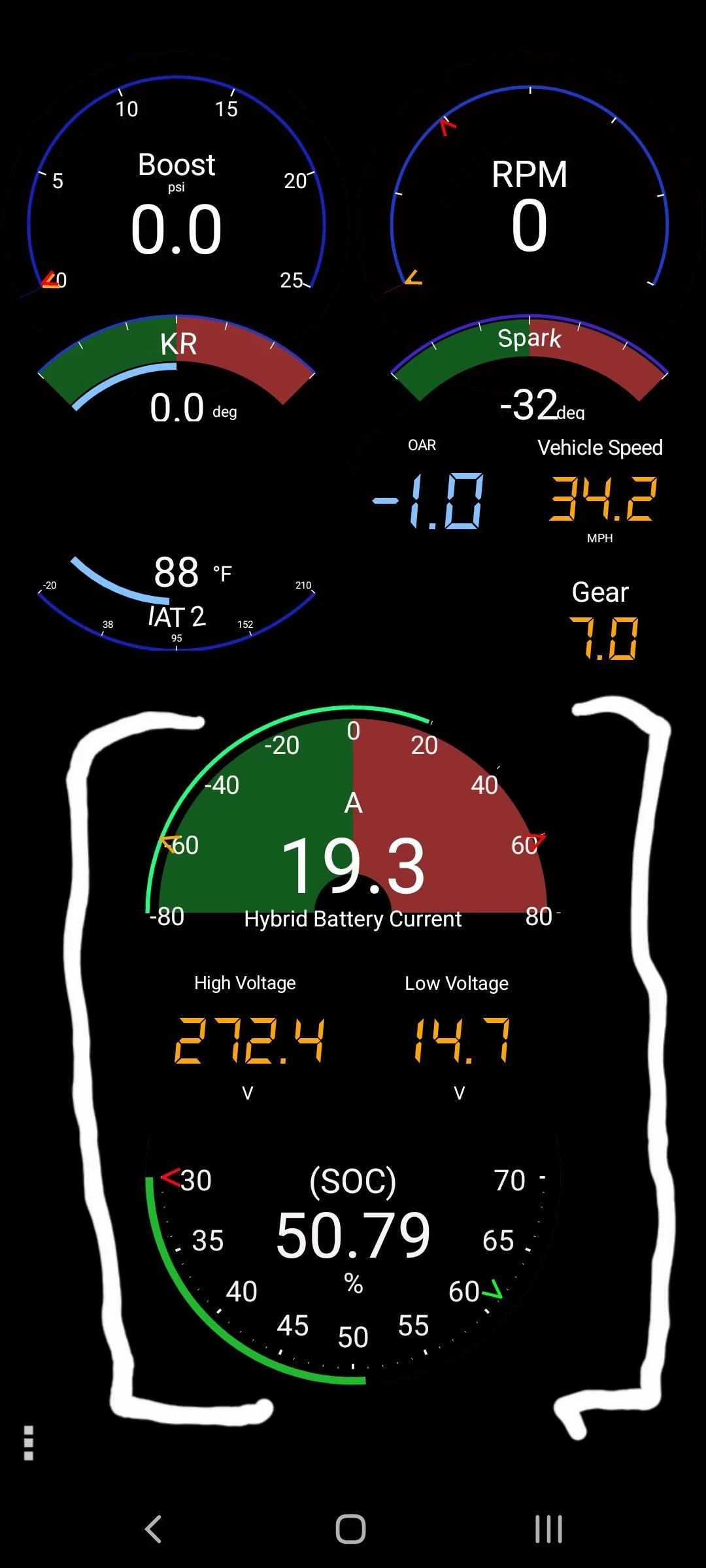

If you grab an OBDLink adapter, and you aren't too far from the truck (I am sitting in the RV with no issue connecting), you can monitor things like RPM and SOC of the Hybrid battery, as well as the real draw in Amps from the battery.
After a while, you'll learn the pattern for "normal" and it will take just a glance to see if it's working outside those expected parameters.
Below is an Android phone (or tablet) dashboard layout that I built using the free software that is manufactured by the company that builds/sells the adapter.
The gauges at the top are the Ecoboost gauges, and the gauges at the bottom are the Hybrid/ProPower gauges

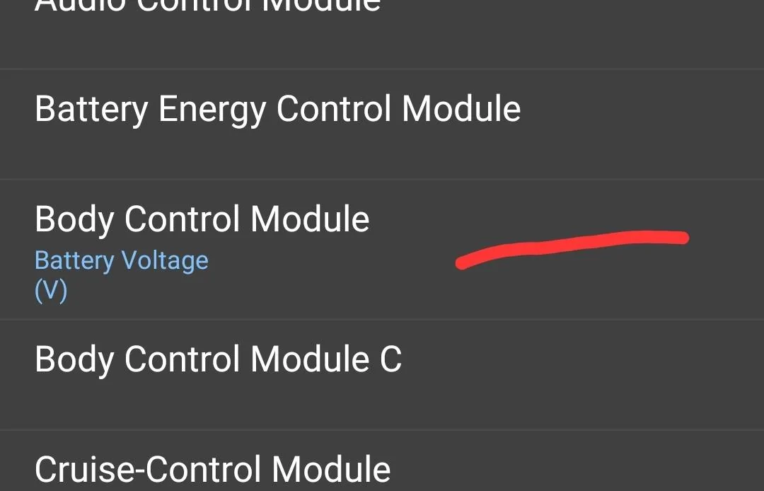

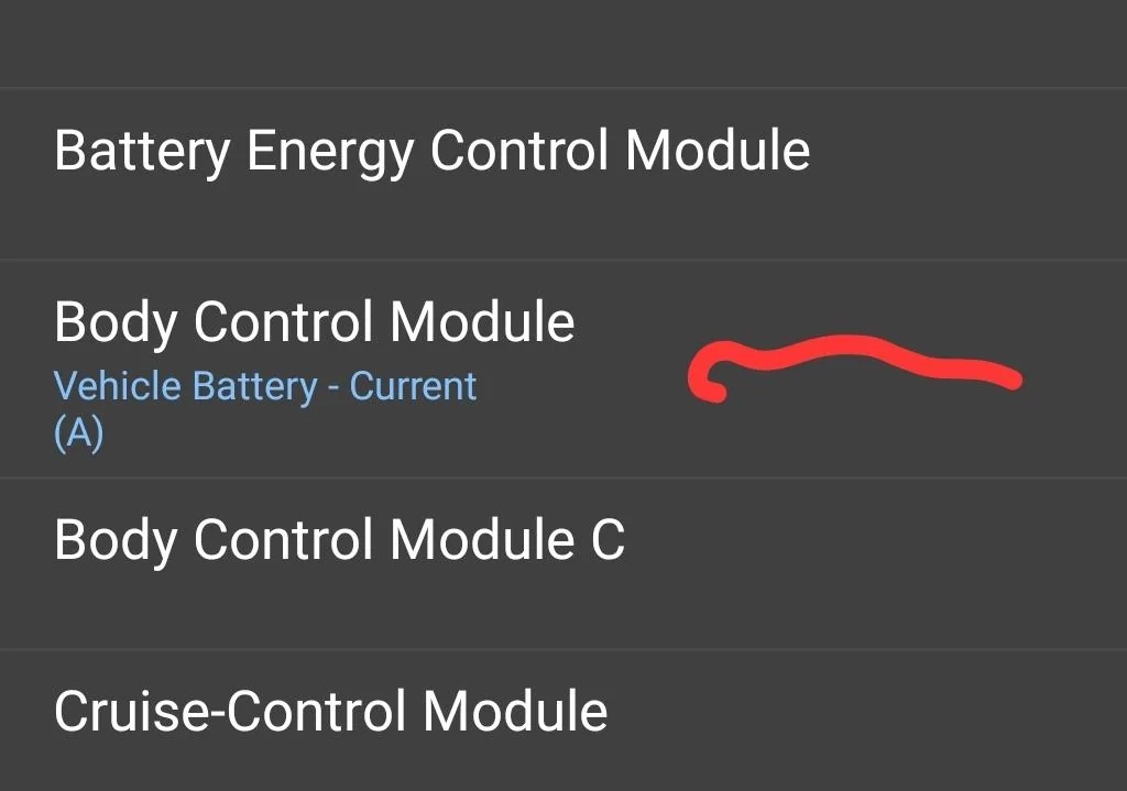

Snake I have the OBDLINK MX+, I have added the hybrid battery info to make dashboard but am looking for the 12v battery SOC, have you had any luck finding that?

This is my current dashboard (below) and you will see all the "electric" pids I currently monitor at the bottom. (circled in yellow are the low voltage pids) I will add the PID-mapping location for those pids.
There's a thread around here somewhere that has the location of every pid on the dashboard. I'll try to find it and post a link.
Note that @turbopilot has developed a much more granular dashboard and has shared it as well. Hopefully he'll see the tag and point you at the most current thread related to getting a nice OBDLink dashboard up.

Thank You!! I was looking for all of the low voltage stuff in the BECM
