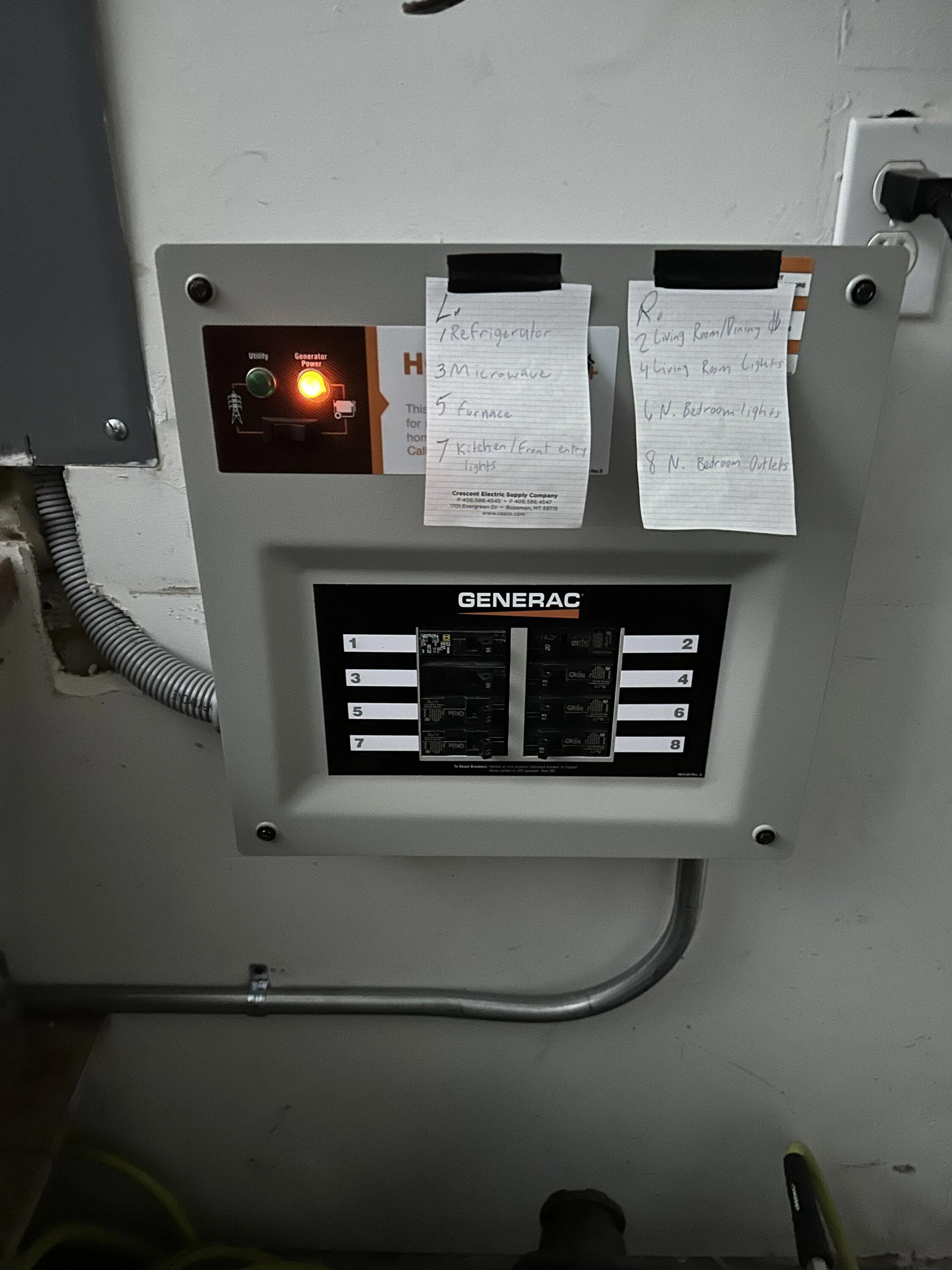

So, looks like my electrician made his own transfer switch, when I returned the Pro/Tran 2, because it was not code compliant, he just wired his own. Now I am checking with him if it is bonded neutral.
electrician confirmed today, all god from my side. Look forward to taking delivery and trying a test run.

Might be a dumb question … if you already have a generac why do you need to plug your truck into house ?
Generac transfer switch, not a Generac generator.
