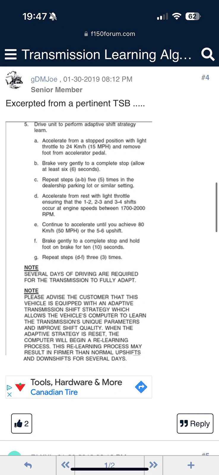

Thanks. This is it here.
One last thing - any forscan issues or risk with the resetting of tables? Or straight forward.
Ford F-150 Transmission ECU Adaptive Learning - Quick question? IMG_4596

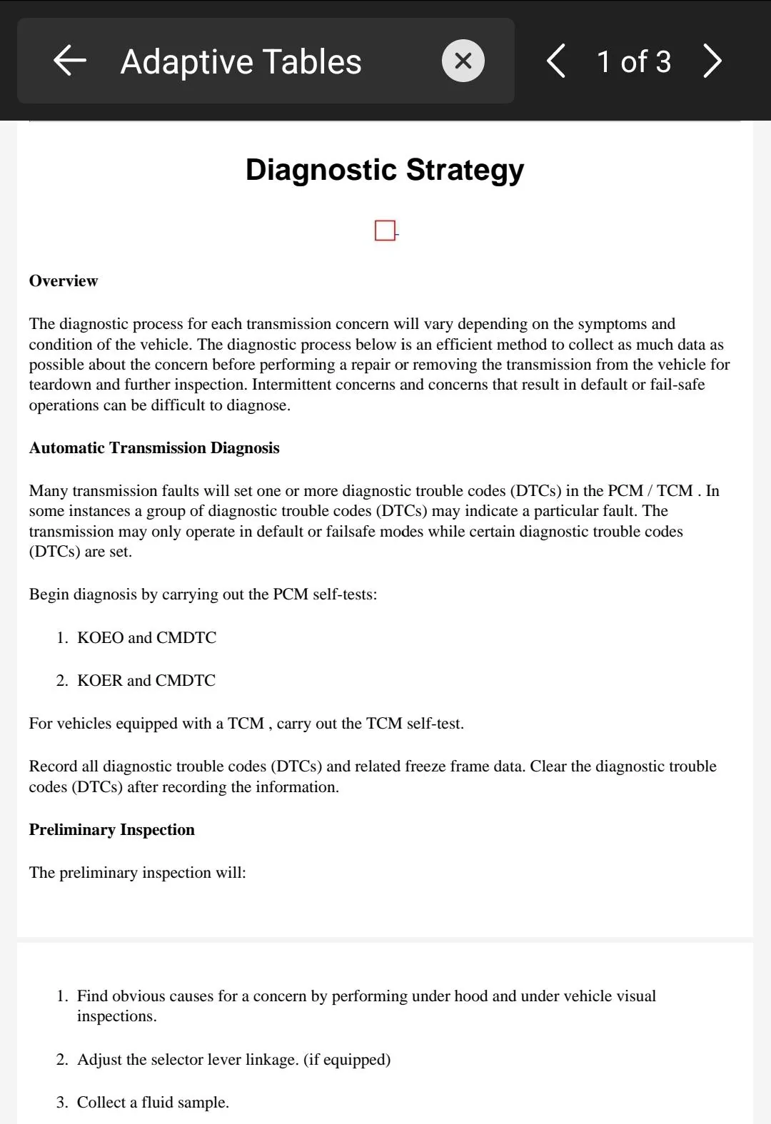

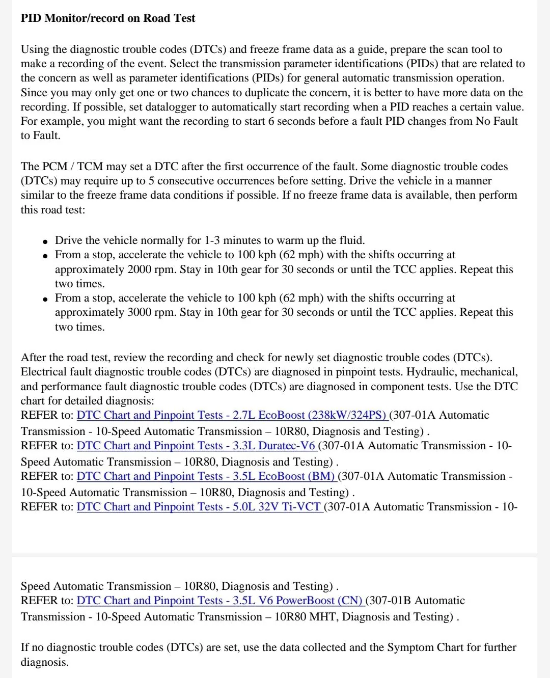

Here's a general blurb regarding the language Ford uses with the technician while discussing clearing and relopulating the Adaptive Tables during transmission service
Ford F-150 Transmission ECU Adaptive Learning - Quick question? Screenshot_20240416_120755_OneDriv
Ford F-150 Transmission ECU Adaptive Learning - Quick question? Screenshot_20240416_120820_OneDriv
Yep!
Nice find.
I can't think of a single reason to be concerned with clearing the tables.
The shift strategy (programming logic) for the 10r80 doesn't require the Adaptive Tables to manage the transmission. Every truck that comes off the assembly line has empty tables.

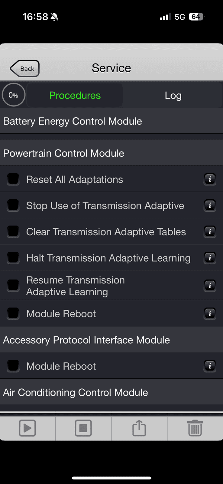

Hey, turns out you can do it on forscan lite. Snakebitten do I just do the Clear transmission tables?
also, there’s a ton of module reboots. Any other worth looking into or stay away? Thanks!
Ford F-150 Transmission ECU Adaptive Learning - Quick question? IMG_4633

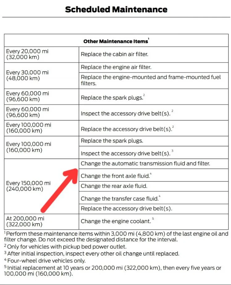

My personal opinion is (and im not qualified for this I just watch Rainman Rays Repairs/FordTech Mac on YouTube and use my common sense to problem solve) even tho they checked the fluid and said it was “ok” with me having 57k miles on this truck and it being so cold the mileage of the trans fluid and cold weather effect on the viscosity is making it shift hard because once it’s warm it’s fine. Truck didn’t do this last winter or when I got it in 22’. Ford recommends a fluid exchange at 60k miles which I’m gonna do and will report back.
I wish Ford recommended a transmission fluid exchange at 60K. Then I could easily defend cutting that interval in half, similar to the 10,000 mile oil change interval.
But that's not what they recommend for the 10r80
Ford F-150 Transmission ECU Adaptive Learning - Quick question? 20250110_084736
Let me clarify, I asked the service department at the dealer I go to and they said they (their service department) are recommending it be done at 60k.
