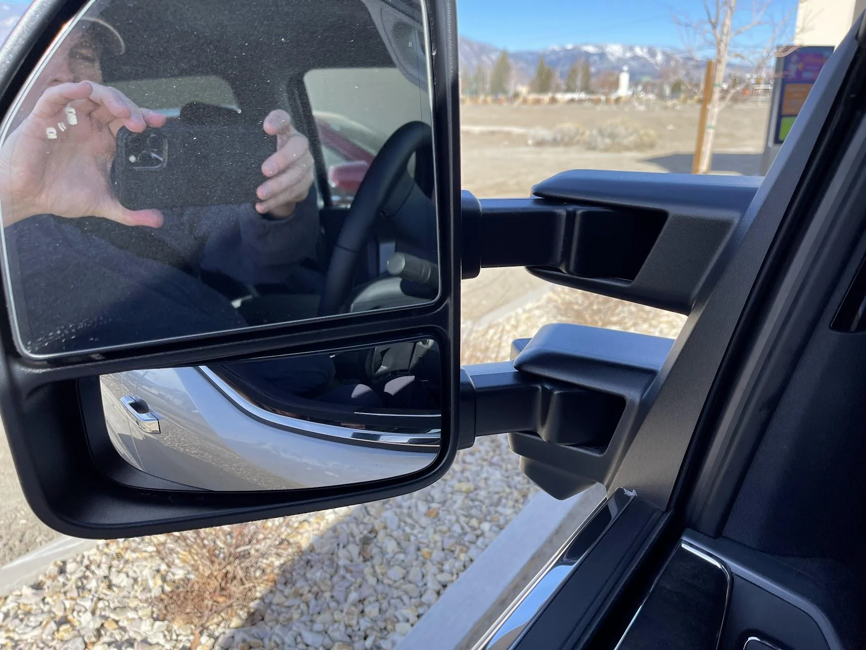

Anyone experienced this or have any idea? I take truck through carwash weekly so have to fold mirrors. Left only folds halfway until cycled a few times. Right folds completely. Bad driver cabling? Not enough lubrication?
I'll likely take it in for warranty look at next service unless someone knows a simple fix.
Picture of mirror "fully" retracted error:
Ford F-150 Trailer Mirror Not Folding Fully IMG_0847

Had that happen to me 1 maybe 2 times in 7 months (8,000 miles). I park my truck in a 'narrow' garage, so I fold them in/out at least twice a day. When it happened to me all I did was fold them back out, then when they came in the second time, they folded all the way in.
If it is a frequent occurrence, I believe there is 'resetting' procedure for them...

NO. The Ford rep. put me through a "call here" "call there" maze. They ended up only referring me to the local dealership after wasting my time making me think that they were going to take charge of the situation.
When it does not fold completely, I manually do it. The unfold works as the motor eventually catches.
Mine is also the Left side. I plan to put the item on my to do list along with the pending recalls, for my next dealership visit. I run a lot of social media and might have to threaten putting public pressure on Ford if they do not address this.
The hangup like usual is that "well if it does not duplicate for us then we can't fix it" This has led me to video record EVERY time I retract the mirrors so I do catch it live so they can not argue. Pictures aren't good enough. I have an unlimited car wash pass so I retract the mirror 2-3 times per week.

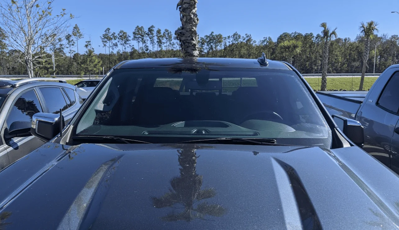

Ford F-150 Trailer Mirror Not Folding Fully 1657719997592

I’m having this same issue. My driver’s side tow mirror doesn’t always unfold.
