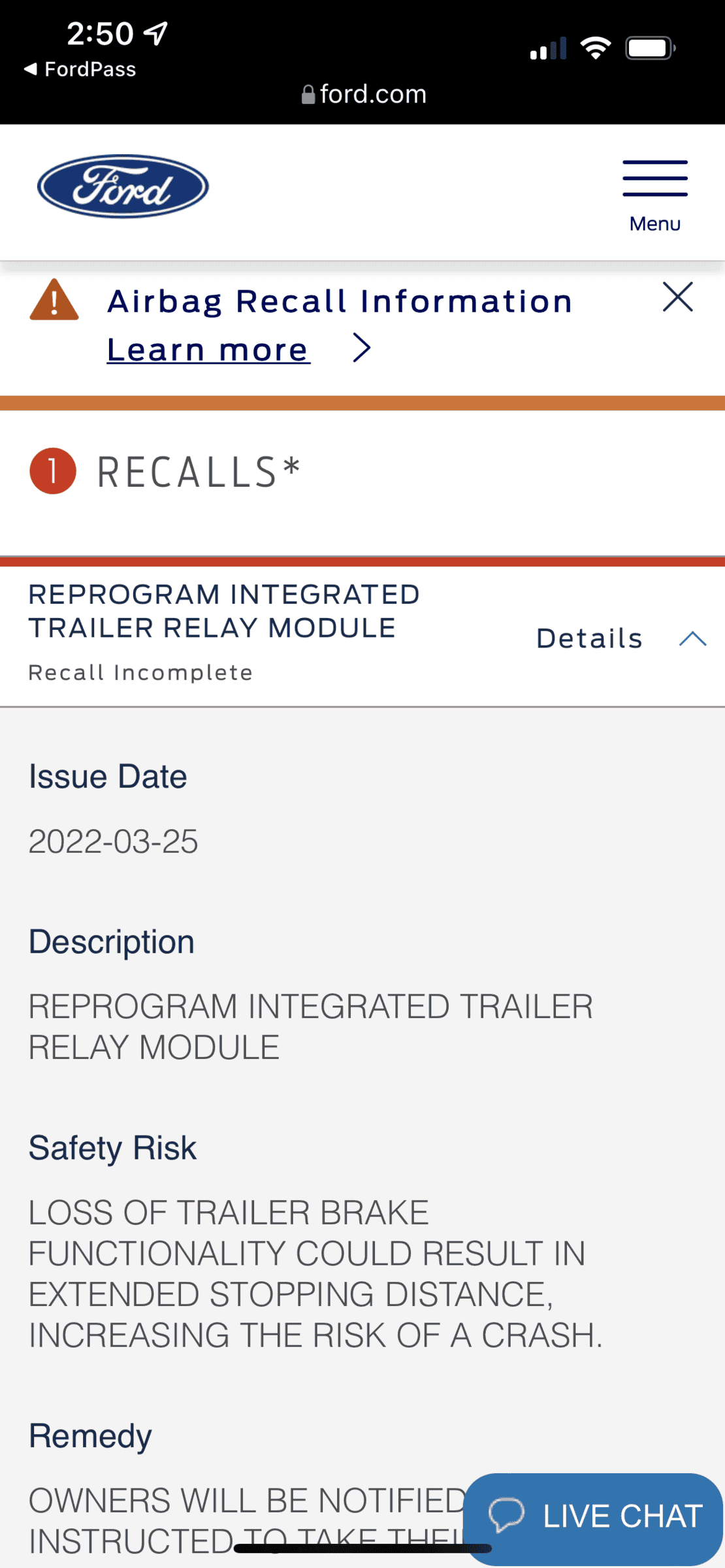

Guys there’s a new recall out for this issue. 22S17. It’s only a reprogram

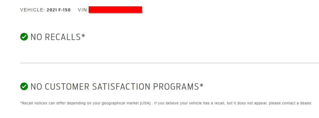

I don't see that on mine and nothing when google searching the campaign or nhtsa #. Any additional details ?
I’ve got a copy of the service procedure for the recall. Nothing interesting except some inconsistent terminology. My truck has a module called the TRM that I updated earlier this month, the service procedure refers to something called the ITRM (Integrated Trailer Relay Module), but everything else lines up and I confirmed that my VIN is part of the recall.
Unfortunately, the software is not on FDRS yet so I can’t apply it. My source thinks it will be available within a few days.

There were a few NHTSA complaints filed toward the end of last year and an investigation file was opened. The case number is referenced in the recall. I think that got Ford’s attention.
I know you’re a big fan of the P3. It’s a good controller. I’ve used it. But it’s not as good as the factory controller. I’d really like to get it working reliably.
