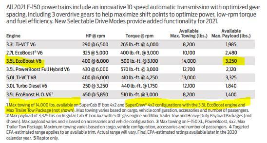

Wish I would have saved the calculator output.
The towing guide has what I was after. Trailer weight shows 11,200 and the below package option table. Didn't realize that I was getting a different axle or bumper with the max tow.

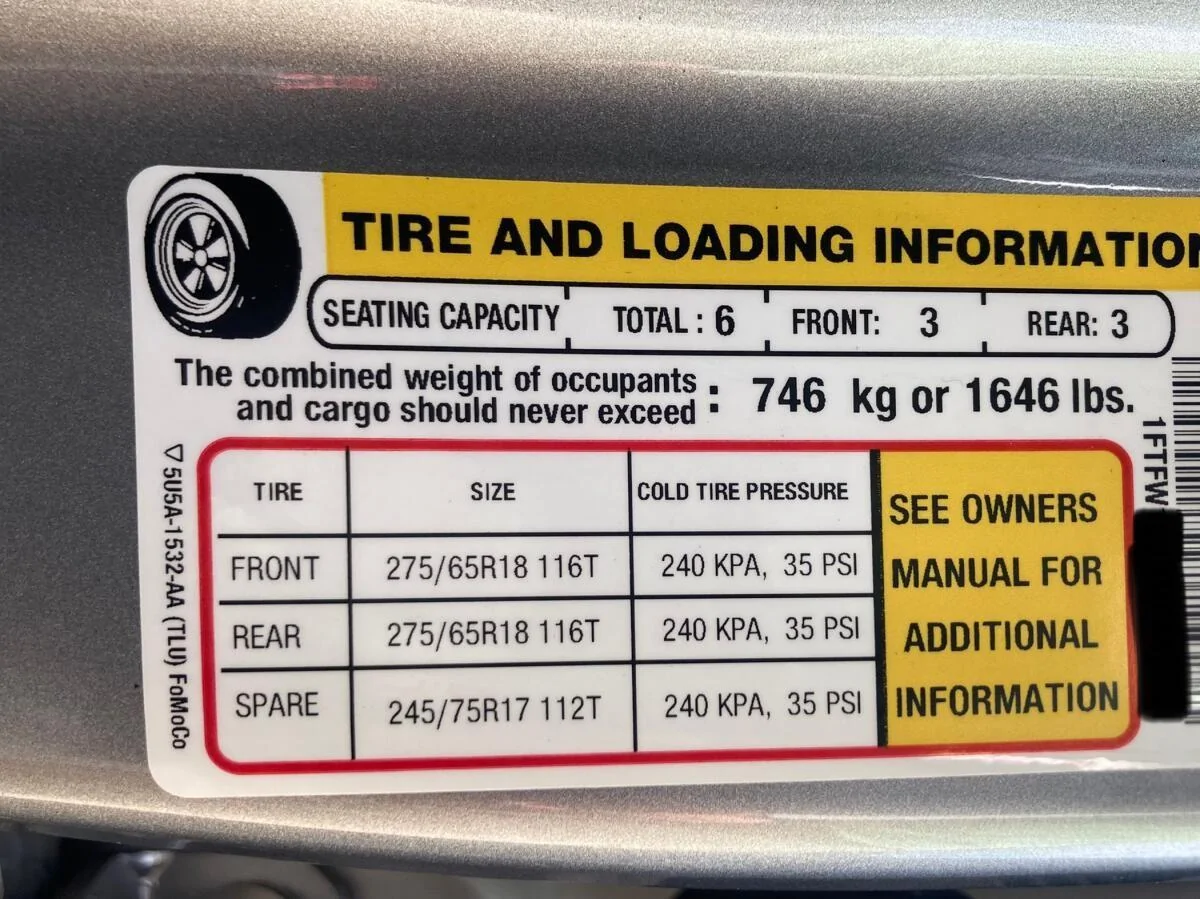

You have the 3.5 EcoBoost 4x4 with 53C max tow package? You have a loading sticker below your configuration sticker THIS loading sticker will give you the capacity of your truck as part of a backwards calculation. I wish FORD would flat out tell you your GCVWR instead of GVWR as you can see by the chart below its Very dependent on your configuration. My truck actually has a higher GVWR than your truck but you have a higher rear spring capacity by your 53C package and SPR - 33CC. Your truck should have a loading sticker that reads 3150lbs if I understand Ford's charts in order to have the 14,000 (4x2)/ 13,900 (4x4) towing capacity. I wish Ford just listed the GCVWR on the loading sticker instead of making people guess.
Ford F-150 Tow Package Breakdown For 2021 F-150 Towing not ours

Ford F-150 Tow Package Breakdown For 2021 F-150 Load Sticker
Ford F-150 Tow Package Breakdown For 2021 F-150 Config Sticker

Thanks Tokyo Joe, I appericate all the effort put into that, I will post that load sticker here soon I need to take a pic. I agree Ford needs to post this information so people do not damage their trucks or make unsafe choices by not having the correct information properly given to them without having to search everywhere. I do know with the springs the truck doesnt ride the best compared to my other F-150's. It floats more almost like an old LTD with bad shocks over bumps. Alot of front to back motion I did not notice until I get it home. I usually tune my trucks for 1/4 mile and towing is a second though. This truck is more comfortable and relaxing then the previous gen besides the front to back sway. My 18 F-150 has alot more sporty feel to the road and handles better by far.

Just going off this sticker and some assumptions:
  • Towing capacity is assuming 150lbs for driver.
  • 1723 - 150 = 1573lbs if this is your max capacity of your truck after you add a driver.
  • Towing you put 10-15% of the total weight towing onto the tongue. Lets assume 10%
  • Towing chart says 13,900lbs for your configuration with 53C so 1,390lbs tongue weight.
Summary: I your loading sticker indicates that you can place 1,723 lbs into your truck. Assuming you are towing alone and only weigh 150lbs you are well below the max tow rating IF your tongue weight is only 1,390 lbs. (WITH LOAD DISTRIBUTION) <--- This part really chaps my ass because you can't put more than 500 lbs without load distribution on the factory IV hitches. I bought a CURT aftermarket for my 2018 so I could have more tongue weight without weight distribution, the truck looked stupid with two hitches.
Disclaimer: I still don't fully understand why FORD doesn't put GCVWR on these trucks, so I can't say "you're good" its just the calculations I ran that said I think you're good.
