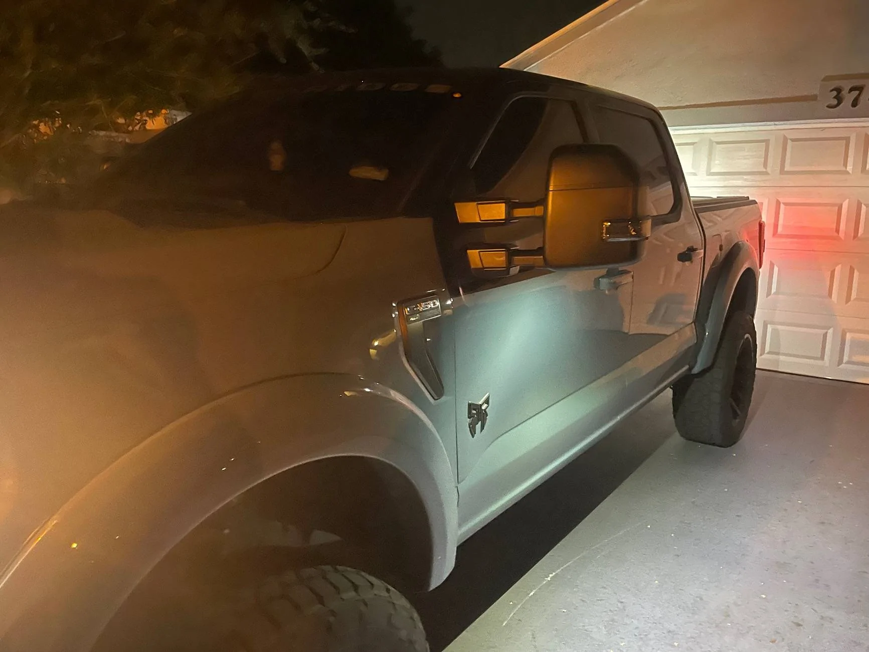

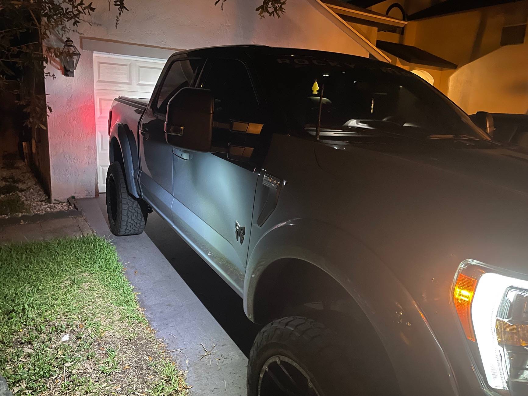

I went with Boost Auto Tow Mirrors! Easy DIY installation and Best bang for my buck!

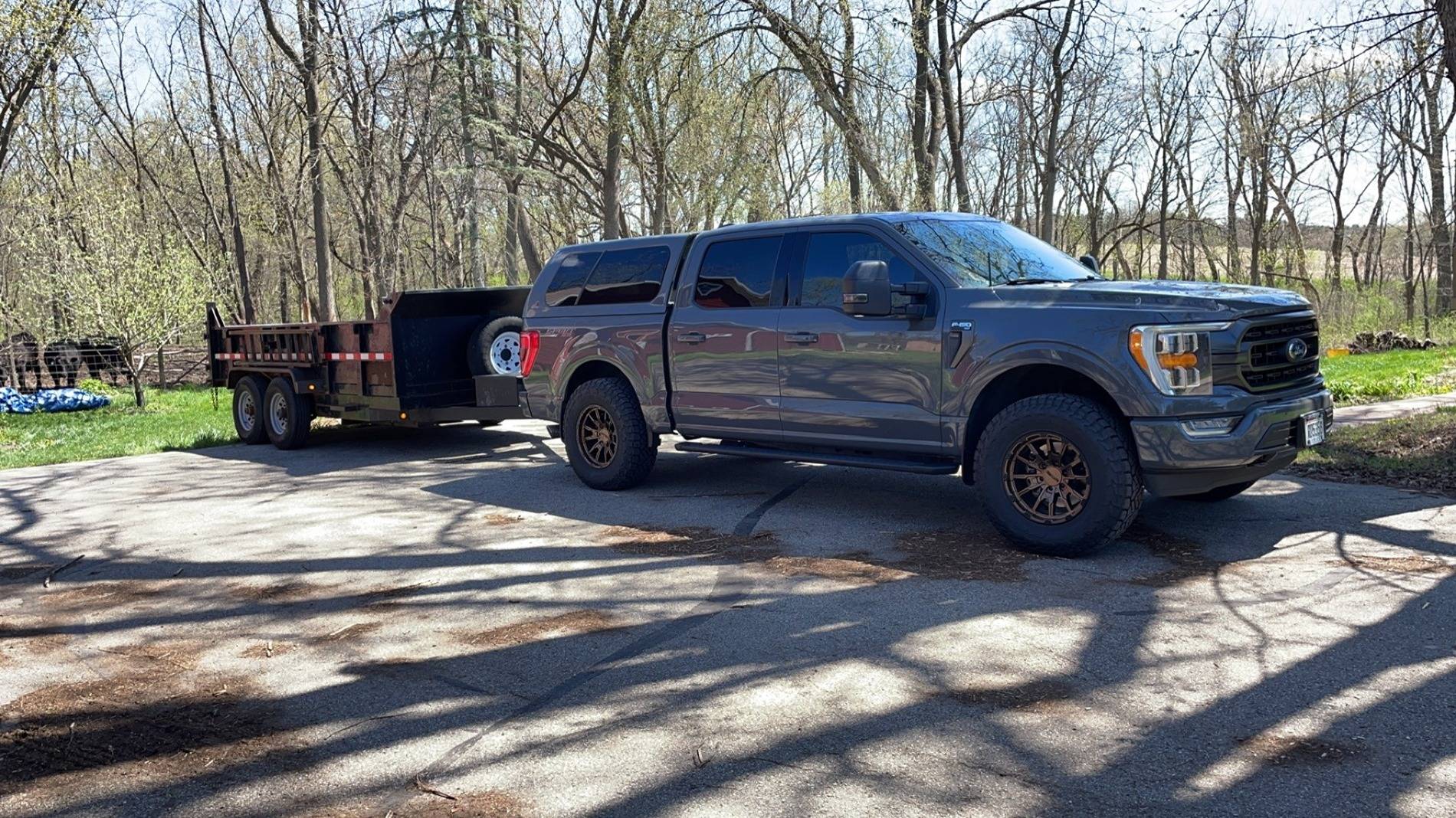

Another vote for Boost Auto here. I had blind spot, puddle lights, non power, non 360 cam and the install was about as easy as it gets. I opted for heated upper/lower, NON sequential switchbacks. Very happy with them.
