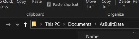

Your very first connection to forscan should have saved your asbuilt data to that computer.....
Go to your default PC "documents" folder
Ford F-150 Totally screwed up my forscan edits HELP! 1731970910133-8m
In there resides an "asbuiltdata' directory
Ford F-150 Totally screwed up my forscan edits HELP! 1731970956525-r7
Within the asbuiltdata folder you should find your very first connection asbuilt data. 1 caveat, you can't 1:1 it as any updates that's increased the number of fields, which many modules now have more fields, you can't just load it.
Any updates to VINs in the IPMA can propagate out to the radar modules connected to it. If you've boogered up VIN data in a module at the top of the hierarchy like the BCM, it can cause funky things to happen (at least using FDRS).
